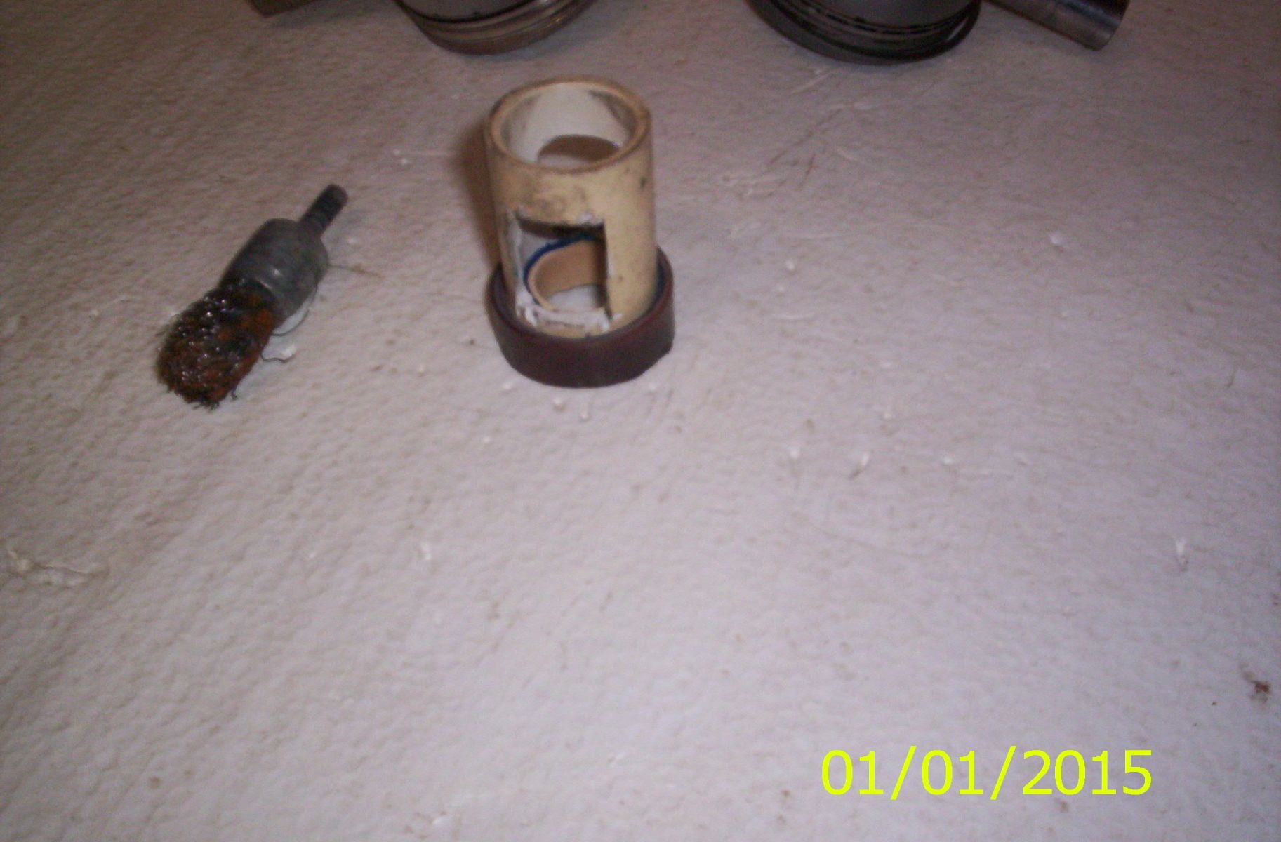

Thanks, I have a Clymer manual that's proven itself so far. I was able to retrieve my lost screw pretty easily but the valves wouldn't budge. I put a big socket on there and could only compress them about a centimeter. I'm gonna see about renting a valve spring compressor sometime soon or just picking one up.

The keepers are IN THERE. You will hear a pop when they let loose, then try to get them out.

04 Jan 2016 12:01swest wrote: The keepers are IN THERE. You will hear a pop when they let loose, then try to get them out.
Thanks, I decided to just leave the valves alone. I was planning on getting the bike all assembled today but I broke one of the piston rings when trying to get the cylinder back on. :pinch: Hopefully I can some non original rings. I'm not too fond of ordering parts from 30+ years ago when these rings seemed to snap so easily.
