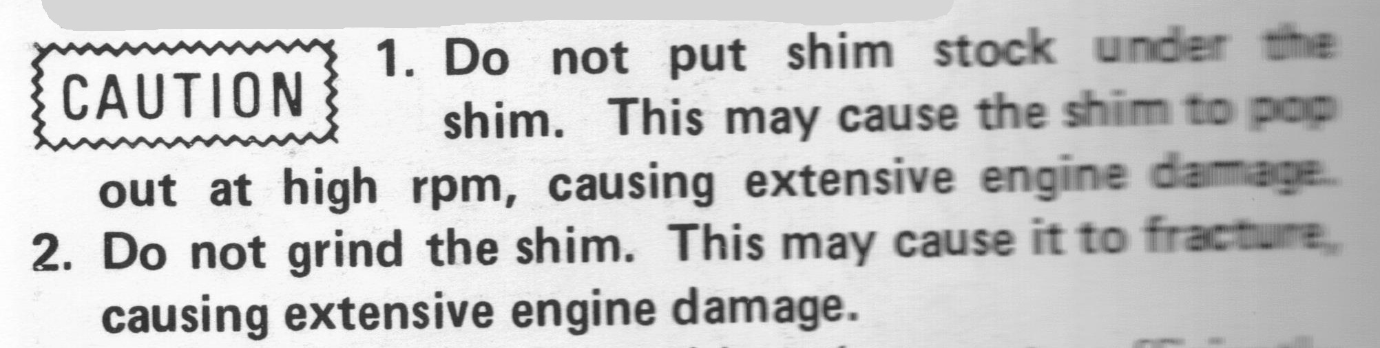

08 Oct 2015 14:42 - 08 Oct 2015 14:44

08 Oct 2015 16:01 - 08 Oct 2015 16:03Mean Green Z28 wrote: ........ and ran the intake shim on ultra fine grit sandpaper for a LONG time by hand and was able to shave off a couple thousandths and get to 0.002" - 0.0025" in the end.........
Very bad rookie mistake. The shims are not the same hardness all the way through. Get rid of the shims you shaved and buy new ones. New shims cost a LOT less than a new engine! Ed
