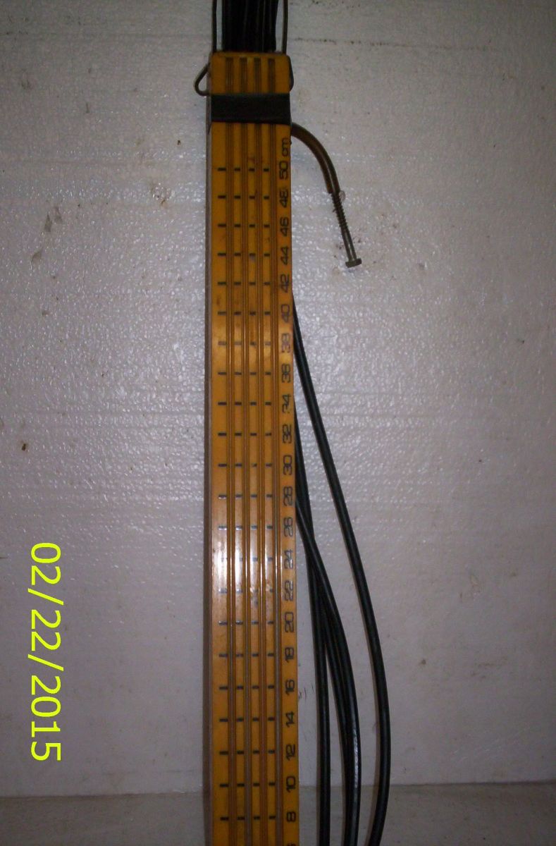

- Posts: 15339
- Thanks: 2833
Re: Motion Pro carb synch tool
09 Sep 2015 15:14
I like these (see image below). No bubbles, etc.
Attachment IMG_0891-2.jpg not found

- Posts: 23522
- Thanks: 2944
09 Sep 2015 16:20
