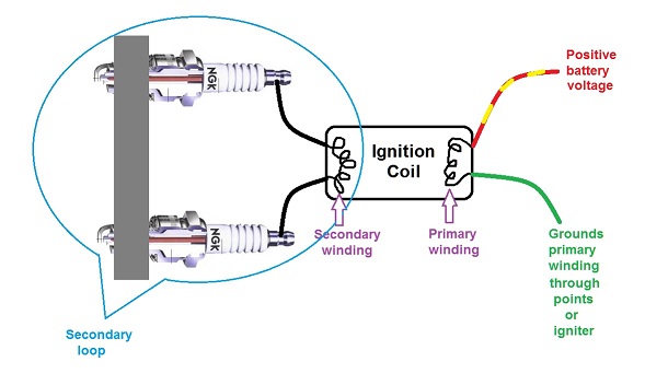

- Posts: 18568
- Thanks: 2103
Re: KZ400 Idle issues. I'm stumped.
02 Aug 2015 04:53 - 02 Aug 2015 05:03DoctoRot wrote: New plug caps in . . . tested spark plug wires - good
new spark plug caps. . . .
Presupposing a perfect air/fuel mixture into each combustion chamber, incomplete combustion may result from weak spark due to excessive resistance in the secondary loop.
How were the plug wires tested?
An ohm-check isn't an adequate test, and won't show leakage of high tension voltage through old hard, cracked, worn-out insulation on the wires.
Are plug wires solid core or suppression core?
What spark plugs are fitted?
Am thinking that spark plugs for the model at hand are supposed to be NGKB7ES.
And NOT "R" plugs such as NGKBR7ES.
The caps are likely resistor style caps, having built-in resistance.
If there's going to be any resistance at all in the secondary loop, it's important that resistance be in only one component, such as resistor style caps OR "R" plugs OR suppression core plug wires.
Resistance in more than one secondary loop component results in weak spark and incomplete combustion.
Could install new Dyna solid core plug wires (they come with caps already built-in) and new NGKB7ES spark plugs.
Dyna solid core plug wires are available from Z1E:
Click here > Black
Click here > Red
