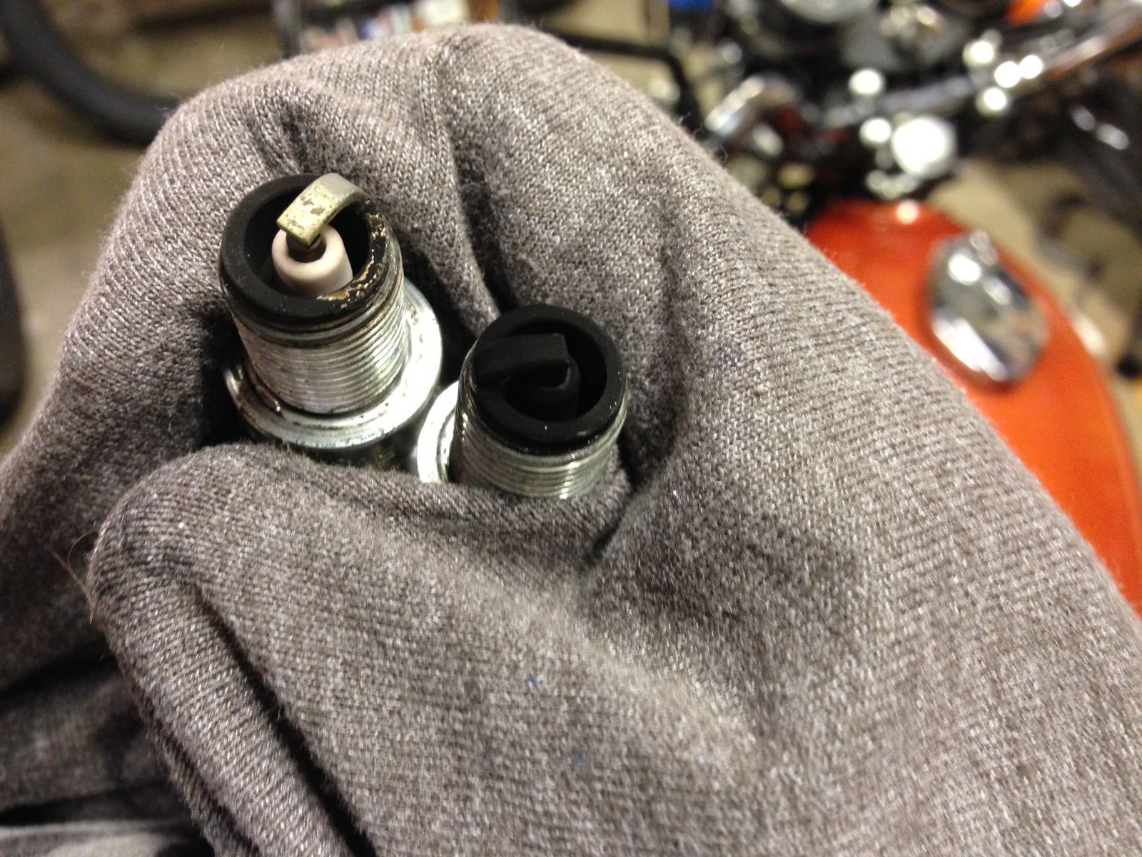

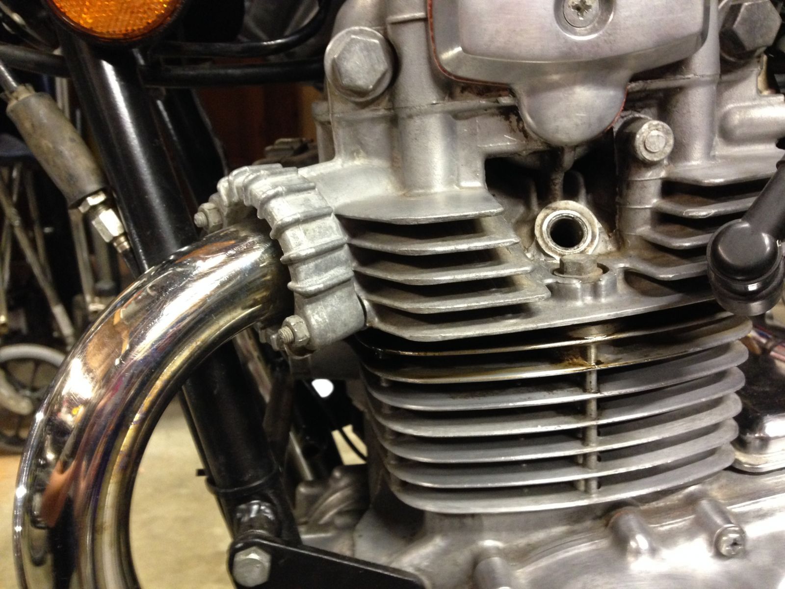

seems like i have just scratched the surface of the problem. I wasn't able to sync the carbs because on a previous attempt when the vacuum was pulling too strong it sucked some of the sync fluid out. But it was seemingly running well enough i decided to take it for my first spin. It bogs down around the 4500 mark and wont go over 5500-6000 when under load. When its sitting in neutral it will rev till redline. after riding the bike the revs wouldnt come down past 3000, but if i let it sit for 30 minutes it will start right up and idle fine even after letting it warm up and blipping the throttle.
I checked the plugs and was very surprised. number 1 is lean and number 2 is rich. I checked the compression because the head gasket is leaking pretty good on the left side (which apparently is common) , and both cylinders have 170psi. I just got some OEM pilot jets so i guess i will put those in even tough i don't think thats an issue anymore. Also gonna check the float levels and the timing advancer. Any suggestions?? this thing is driving me crazy, but from first impressions it seems like a fun little bike, especially when it has an even power band.

14 Jul 2015 06:31DoctoRot wrote: ... number 2 is rich... I checked the compression because the head gasket is leaking pretty good on the left side (which apparently is common) , and both cylinders have 170psi. I just got some OEM pilot jets so i guess i will put those in even tough i don't think thats an issue anymore. Also gonna check the float levels and the timing advancer. Any suggestions?? this thing is driving me crazy, but from first impressions it seems like a fun little bike, especially when it has an even power band.
Perhaps the fuel level is too high in #2 carb and causing an excessively rich mixture.
If not already done, would perform the clear tube test to assure fuel levels are within specs.

25 Jul 2015 21:52
I had a chance to mess around with the bike. The rich cylinder's float was at the upper limit of the acceptable range so i adjusted to to be in the middle. I also repaired my sync, so i was able to sync the carbs.It still has the idle issue once it gets hot! Although i took it for a brief spin around the neighborhood and it seems to run much better after the float level and carbs were synced.
