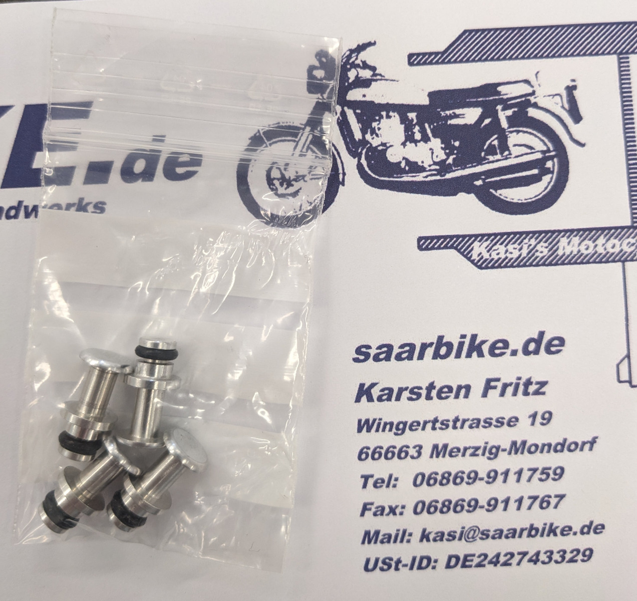

14 Jun 2025 20:22I was able to order to Canada, there is an extra step as they will contact you with shipping costs after making the order. It took two weeks

How much do those aftermarket plugs cost? If the price is right, I can make some for resale in the US market. Not trying to bash, but I'd use brass, not raw aluminum, which corrodes easily. Anodized aluminum would be okay, but not raw.
- SnyperX
- Posts: 131
- Thanks: 28
Re: 11012-1128 plug over pilot jet no longer available
16 Jun 2025 12:45 - 17 Jun 2025 09:06@Nessism a set of 4 with shipping is $34 US with $22 for shipping. I just heard back from SaarBike this morning.How much do those aftermarket plugs cost? If the price is right, I can make some for resale in the US market. Not trying to bash, but I'd use brass, not raw aluminum, which corrodes easily. Anodized aluminum would be okay, but not raw.
