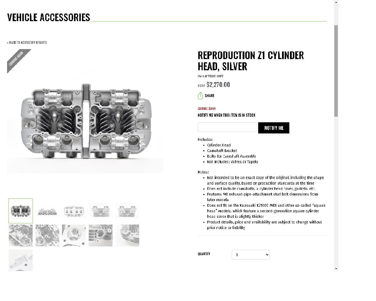

I guess you can still pre-order a new one. (just a thought).......
KZ1000 Reproduction Z1 Cylinder Head, Silver | Kawasaki Motors Corp., U.S.A.
