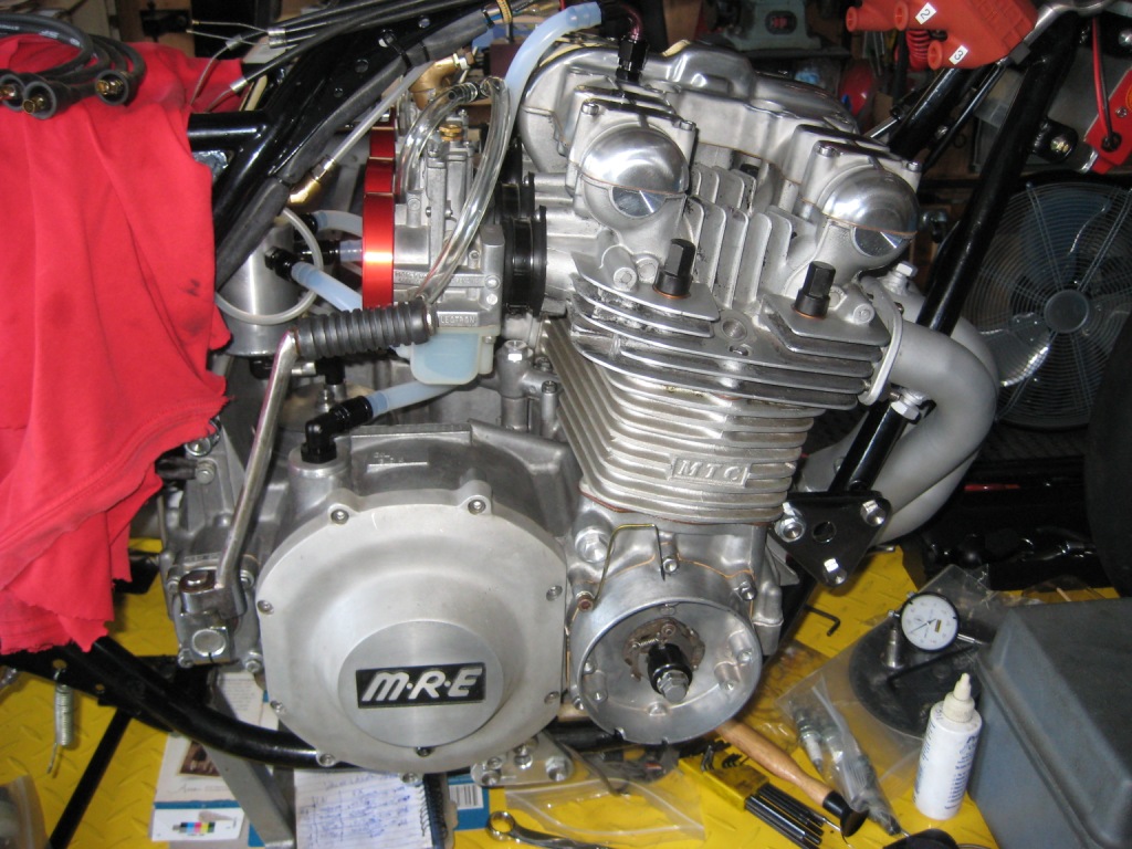

I am running about the same combination : 1327cc 13:1 MTC pistons with 40mm Lectrons (38 would be better) head is a KZ900 with 37/31 valves sunk back and fully ported to about 100CFM@10" on intake. Flycut .030" (from stock) to get 34CC combustion chambers. Cams are .480"/.460" and my shift point is 10K.
