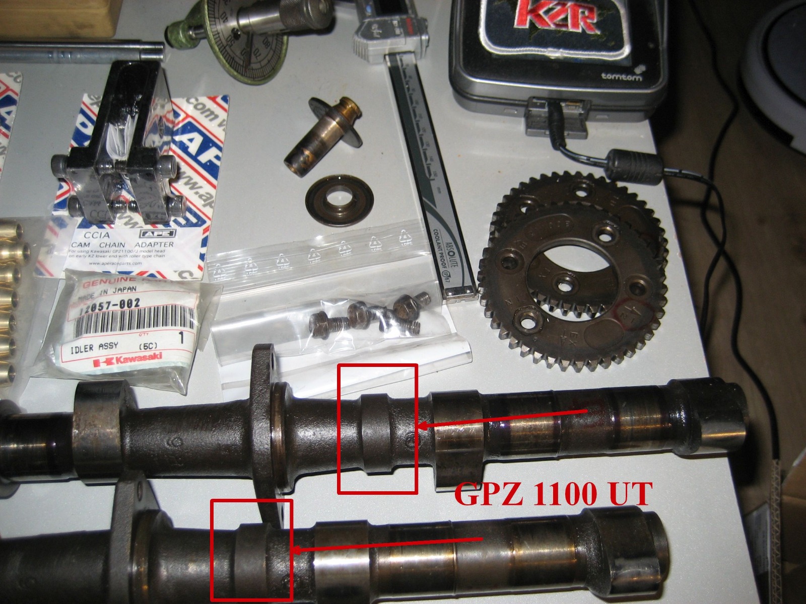

If you want to run GPZ1100UT style cams (more lift) you need a special set of cam sprockets. You have to use allen bolt heads to torque the sprockets. Hex bolts you will collide with the cam chain links!!!

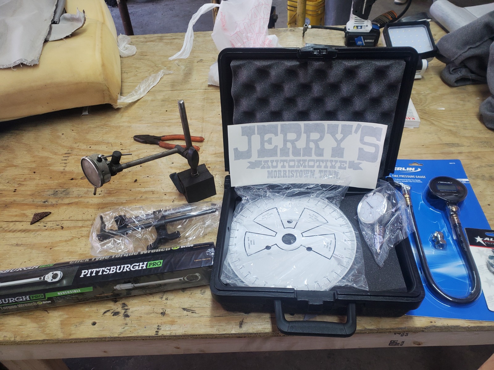

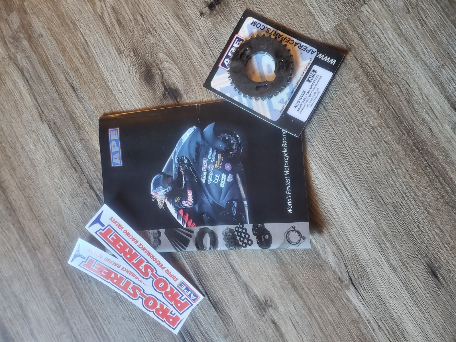

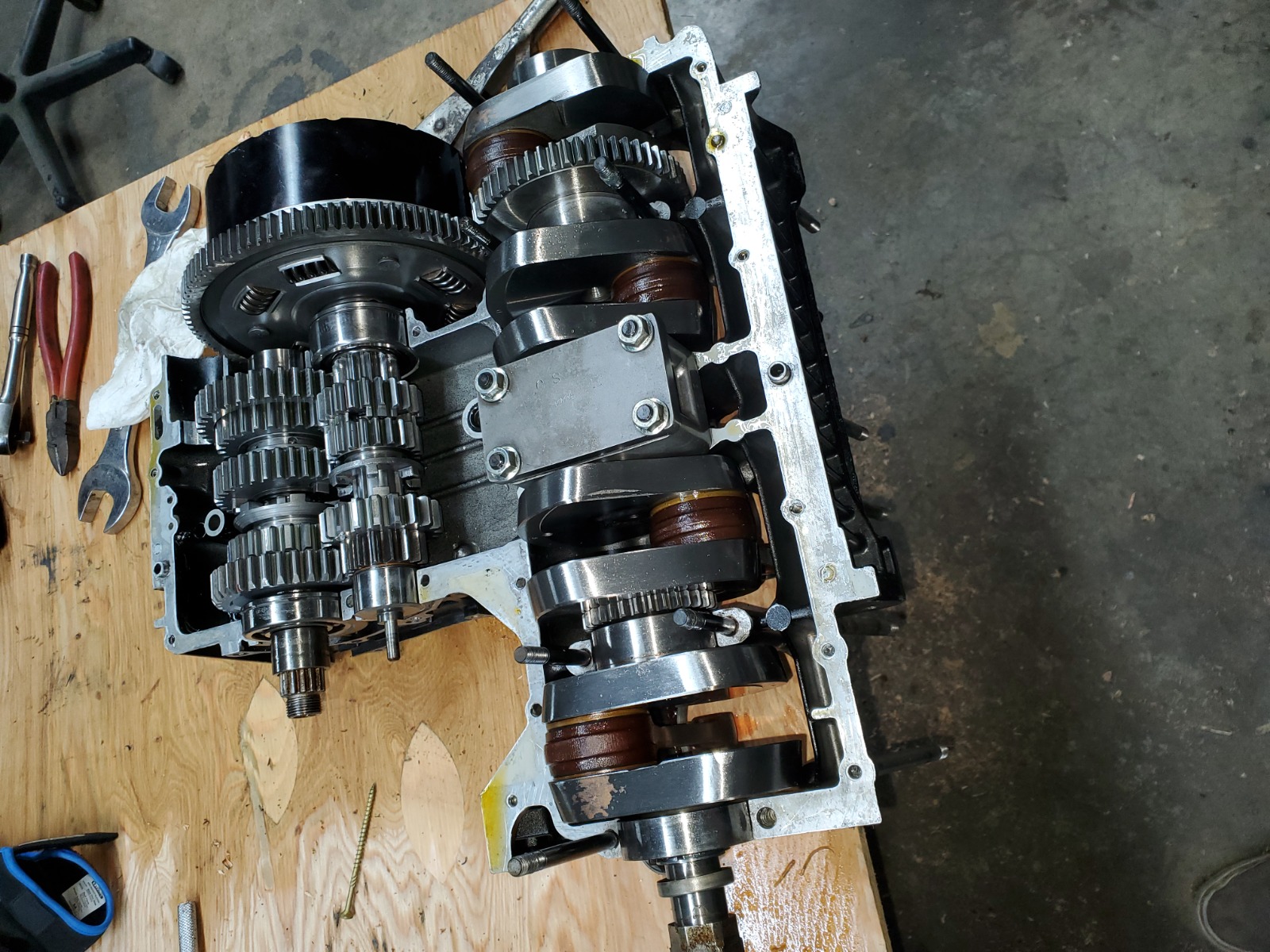

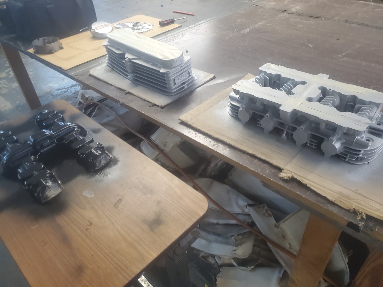

So an update on build ....I got a new timing chain and found a nice ported kz head with big valves and a set of 460/480 cam already in it ... broke everything down and cleaned it up and noticed a few broke bolts in the bottom half of the case (3 actually) took me a few hours with a drill and a set of easy outs but I got them taken care of ....I been reading alot about cam timing with a degree wheel so I put off the build for a week or 2 and ordered all the stuff to do that .. The gauge , the degree wheel, and the magnetic base ... it came in and I set a day to start the build , wile I was going over all the parts and checking everything I noticed the cam gears that came with the head had 30 teeth so I ordered a new set from APE with 32 because my crank has 16 teeth and I grabbed a full engine bolt set , the case bolts are sold in a different kit so I got them to ...I was going to just get bolts at fastnal but there are 4 or 5 that are a bit longer and I didn't want to risk getting the wrong ones .....so.. all the parts needed are at the shop and I think I have all tools needed ....I Think I've learned everything I'm going to learn by reading posts and looking at pictures so this weekend I will get my hands dirty and see if we can get it together
