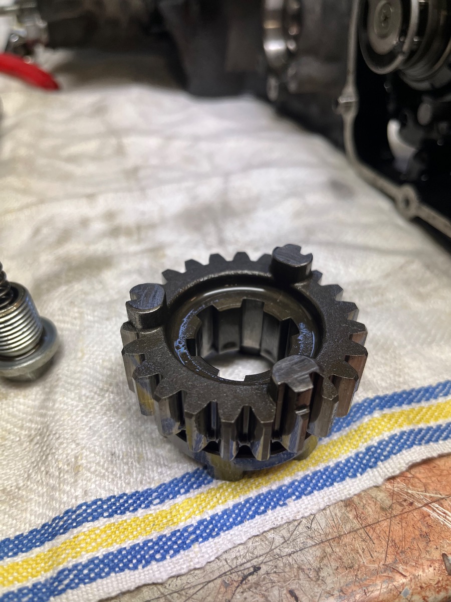

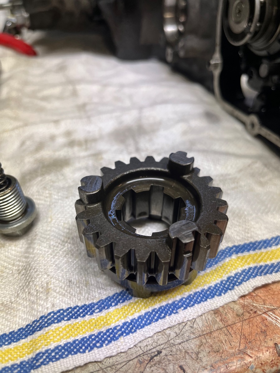

I have taken it apart now and second gear only have 3 dogs already.
About aging that doesn’t seem to effect old Kawasakis 🙂
Springs are still stiff and rubber still soft after 45 years.

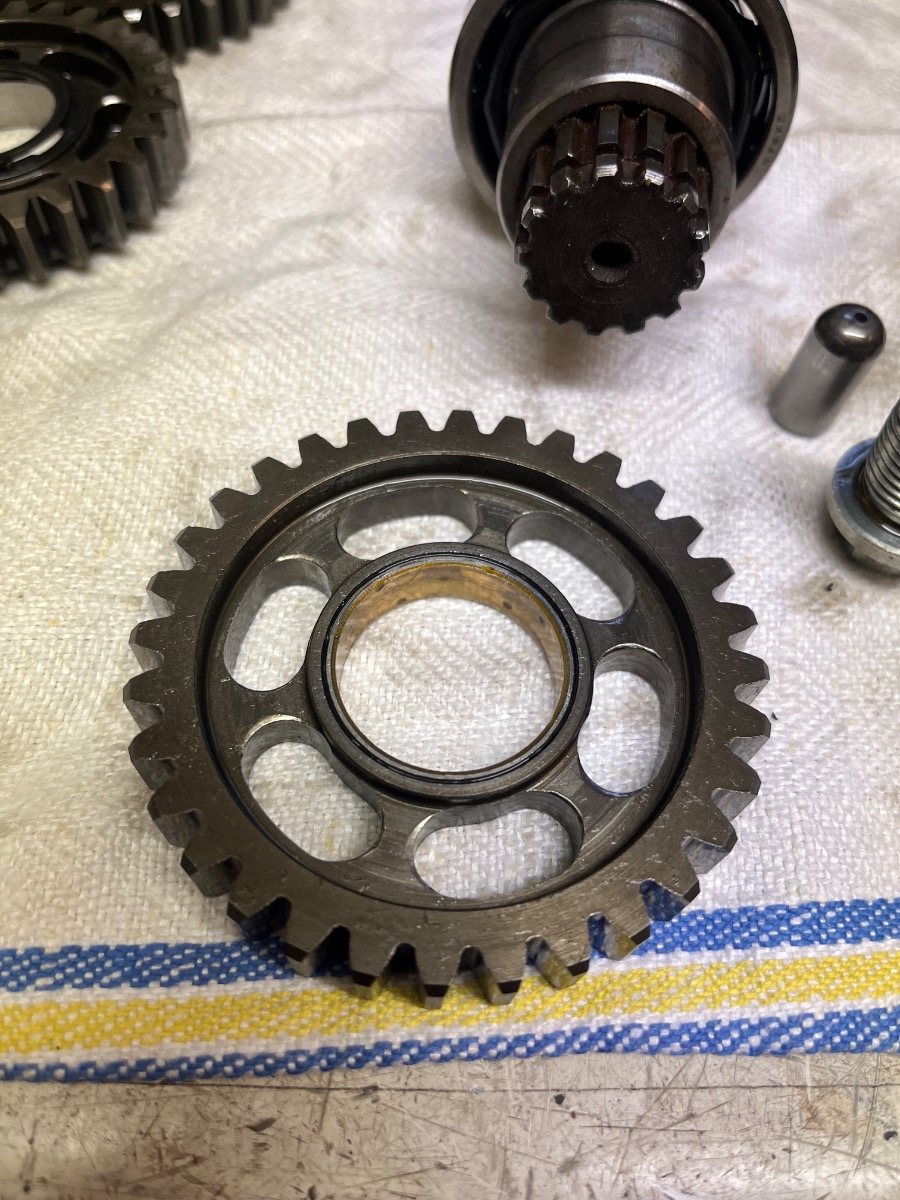

I split the engine and measured everything in the gearbox according to my Kawasaki manual.
Everything is good but there is a little wear on the dogs but now so bad?
I had another 550 engine for spareparts that I took apart and that gearbox looked about the same.
Not sure what to do now.
Try and undercut second gear or revert back to the 5 speed 650 gearbox maybe.

Hello. The best solution is to use the gear stack from a 600ZX secondary shaft. The 3rd and 4th idler gears rotate on a ring and not directly on the output shaft. The 600 shaft is longer than that of the 400/500/550, but everything fits together. The 600 primary shaft is identical to that of the 500/550. Only the bushing at the end of the shaft isn't drilled to allow for the clutch rod. With this improvement, the output shaft will no longer be cut by the gears rotating on it. Text translated from French with Google Translate, please be kind.
