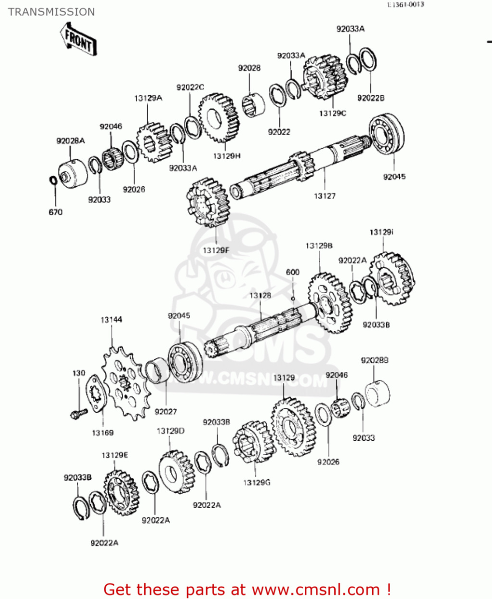

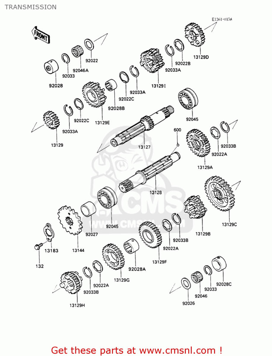

500/550
600
sur l'arbre de sortie, remplacez les pièces 13129E, 13129D et 92022A par 13129F, 13129G et 92028A
600

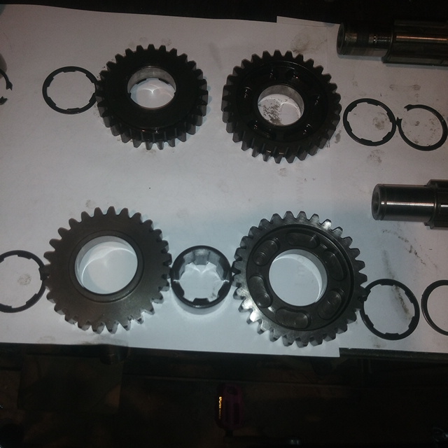

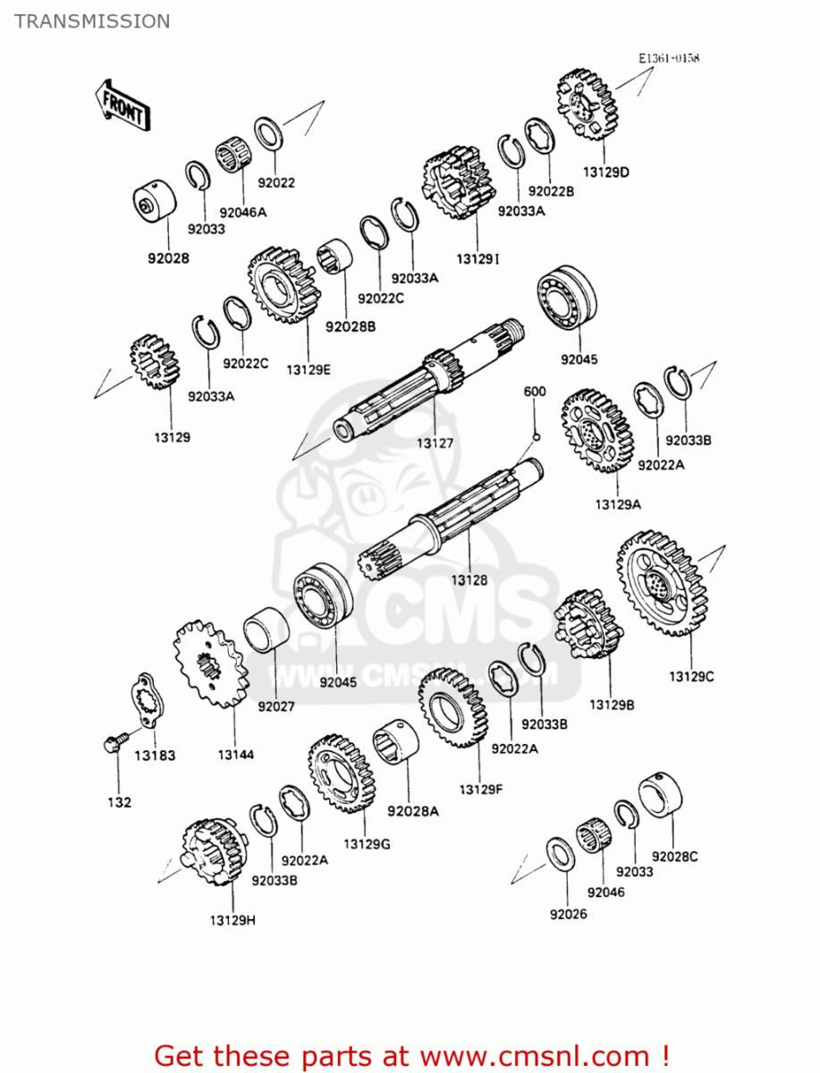

Longer output shaft will be a problem for chain clearing the rear shocks. And it seems that the gears that engages 2nd gear (2nd output and 6th output gears) have the same part number as 550.
And i see that both gears have avalible supersessions. Maybe an improvment?

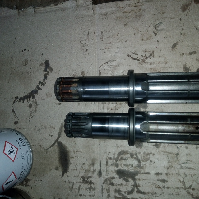

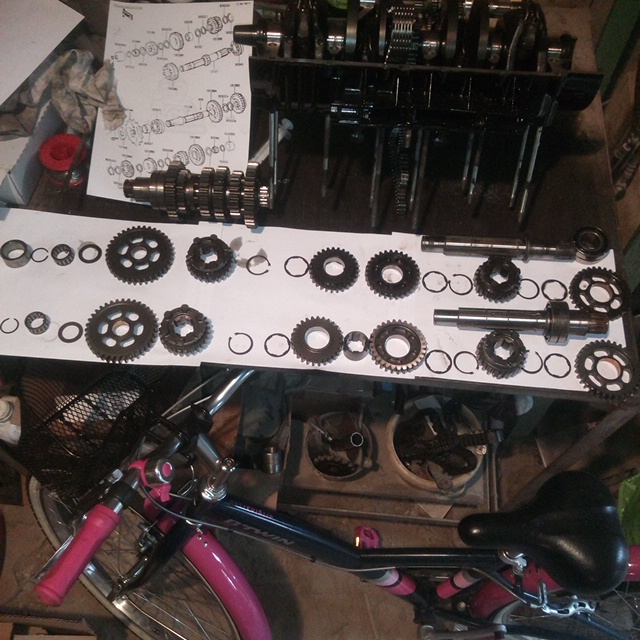

Hello. The translation may not be correct. The 600 output shaft parts fit perfectly on the 550's short shaft. The long shaft (+10mm) allows you to mount a wheel with a wider offset, for example. I'll take some photos.

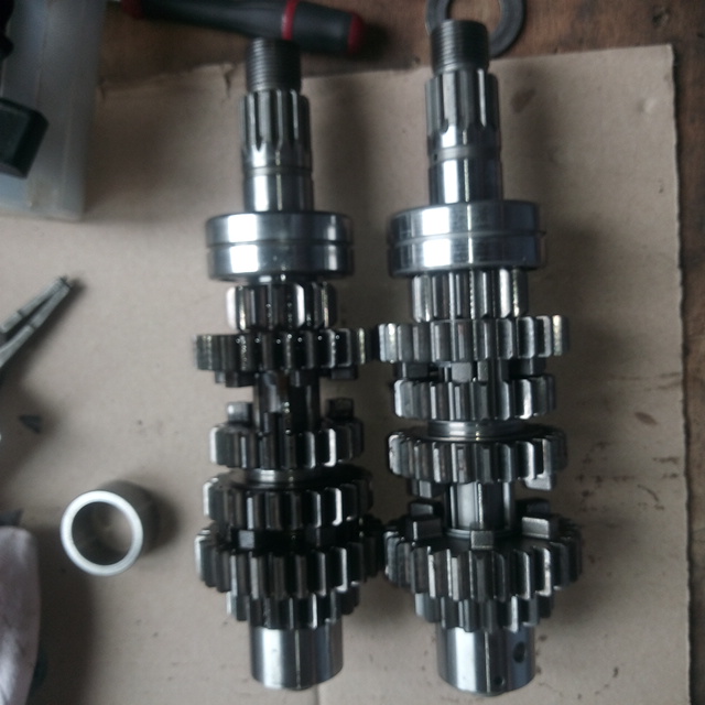

Here's a 550 output shaft vs. a 600.
Top: 550 parts, bottom: 600 parts.
See the difference between the two.
Here are the identical input shafts.

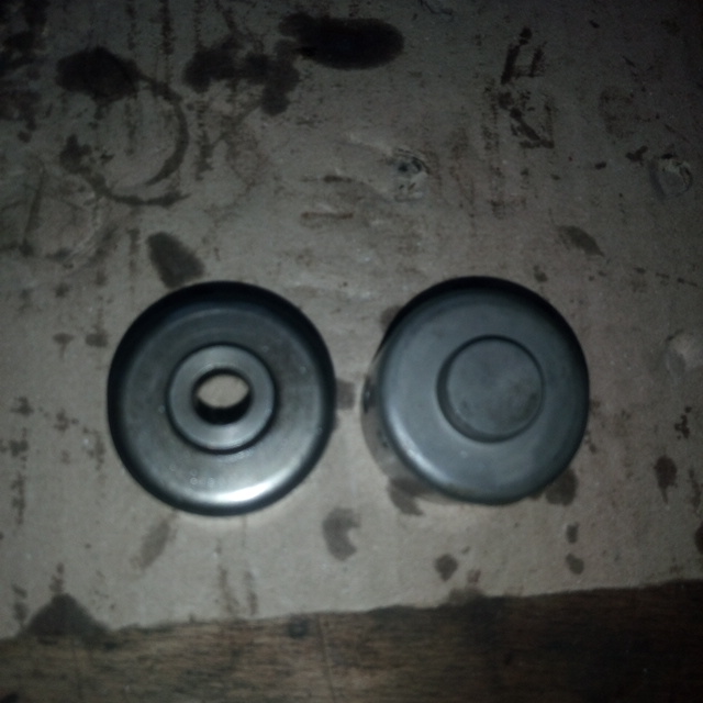

Here are the input shaft end parts. With a hole, 500/550. Without a hole, ZX550 or 600.

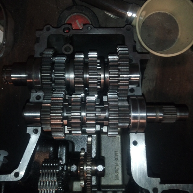

everything in place
everything in place
