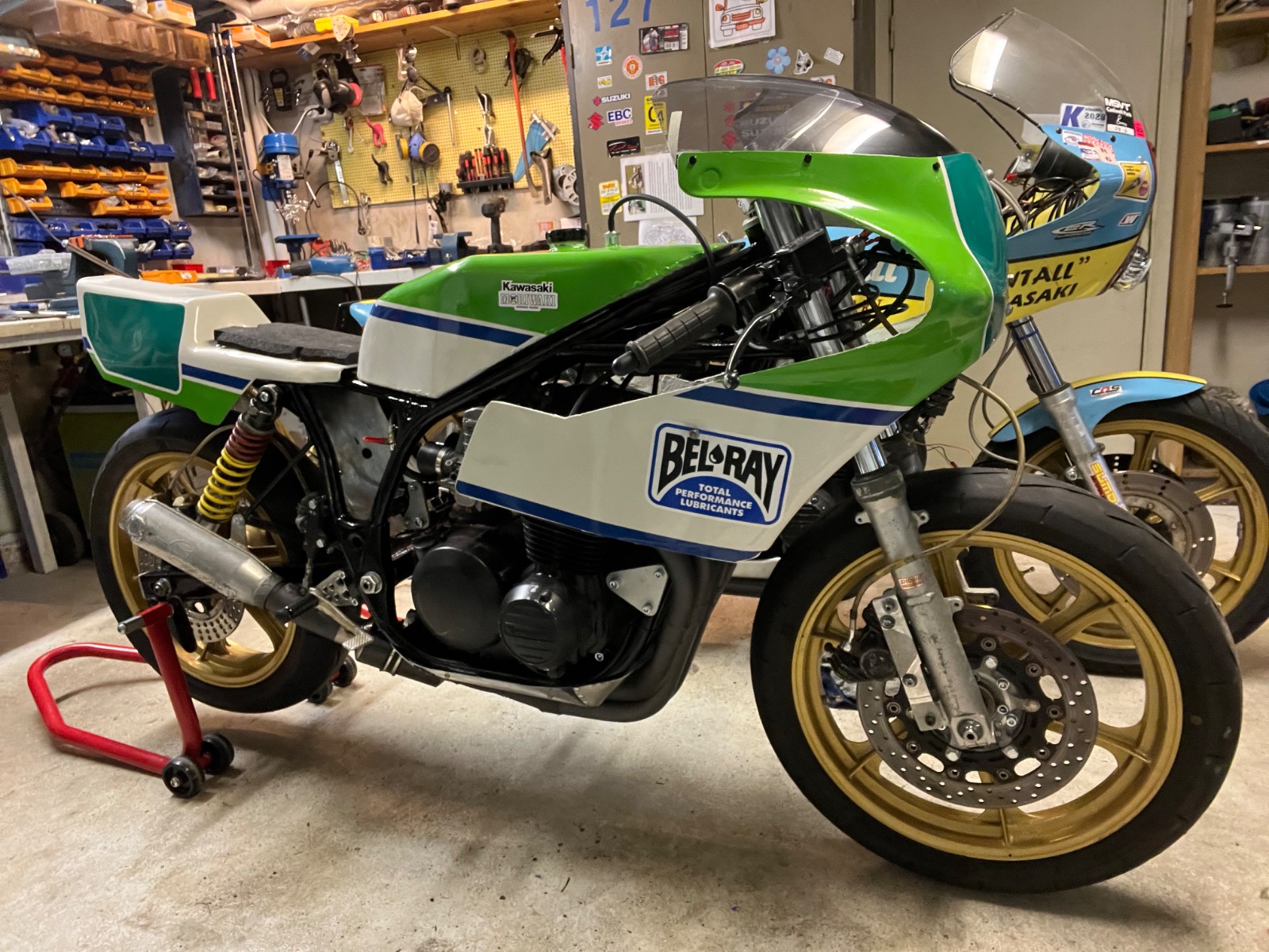

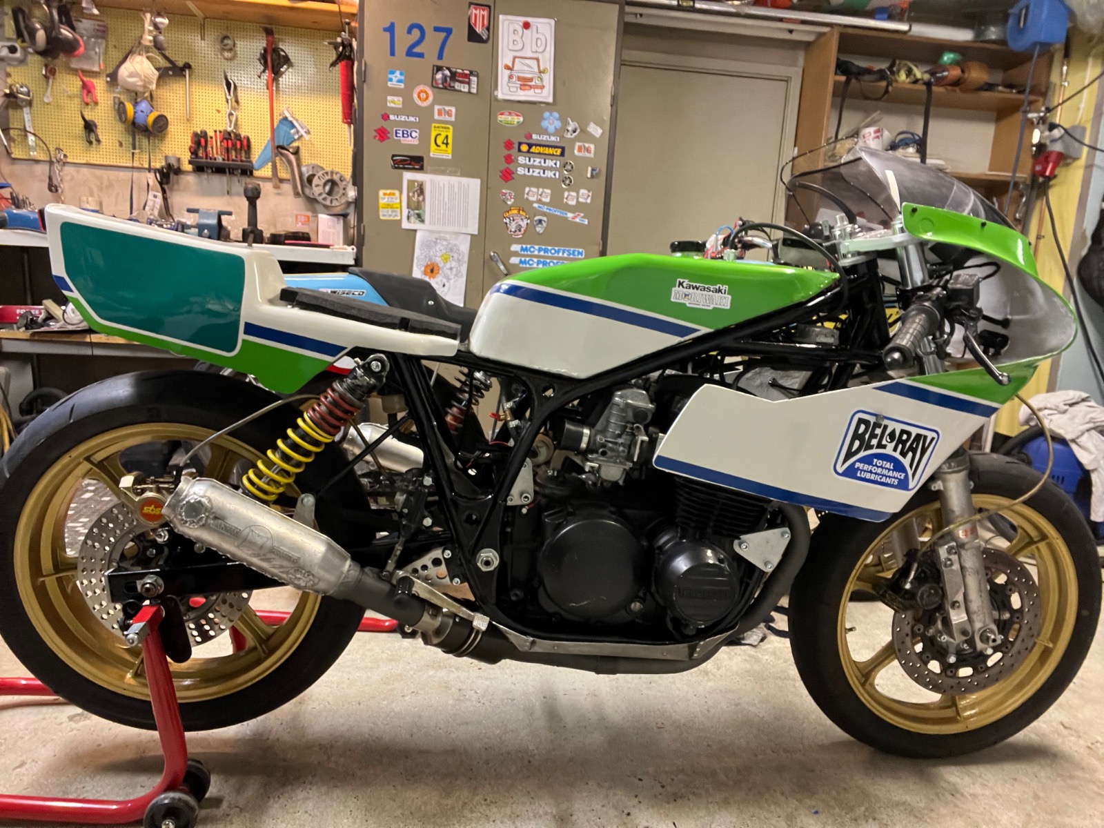

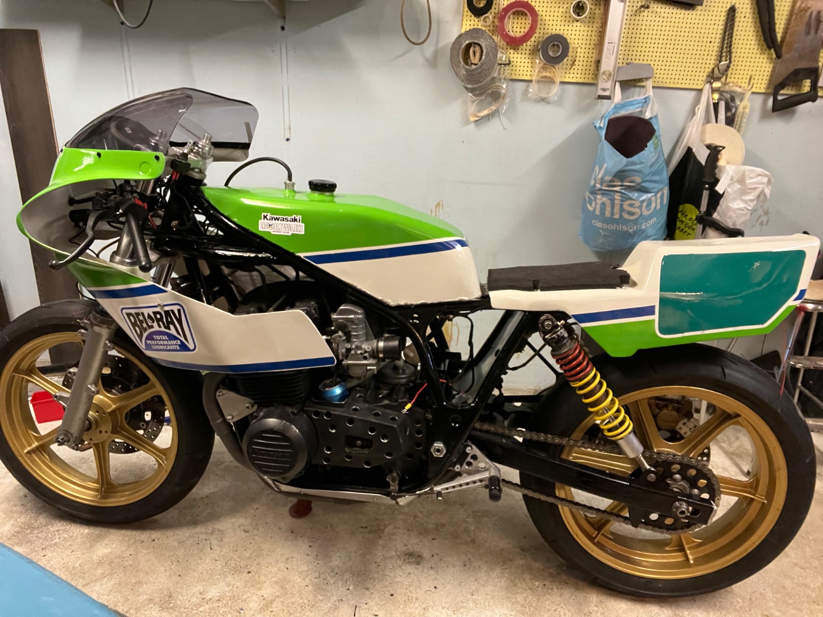

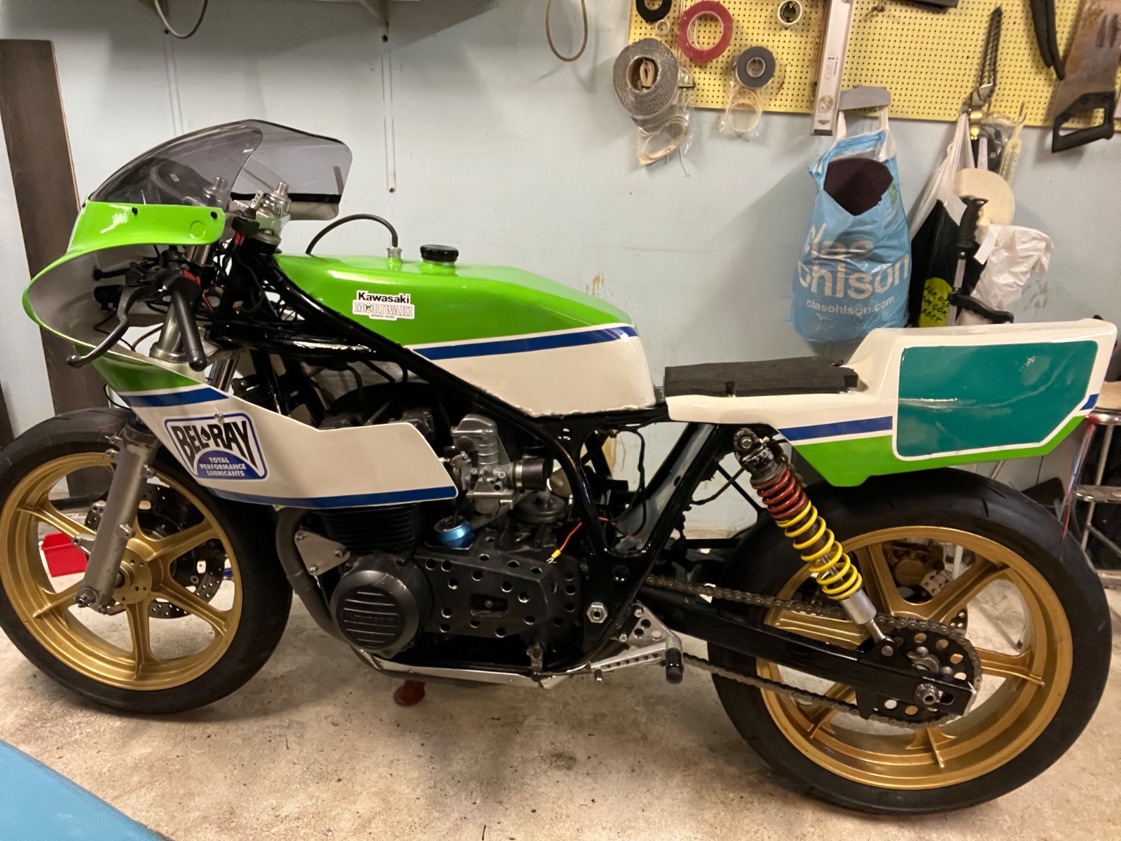

The Moriwaki is almost done. Total weight without fuel is 144kg. The frame weights 10 kg but the swingarm is heavy at 5kgs.
I sold the green 650 and I want to have at least one green bike so I painted it green instead of the Yellow/blue Moriwaki colors.
Now I’m waiting for warmer weather so I can start riding and tuning 🙂

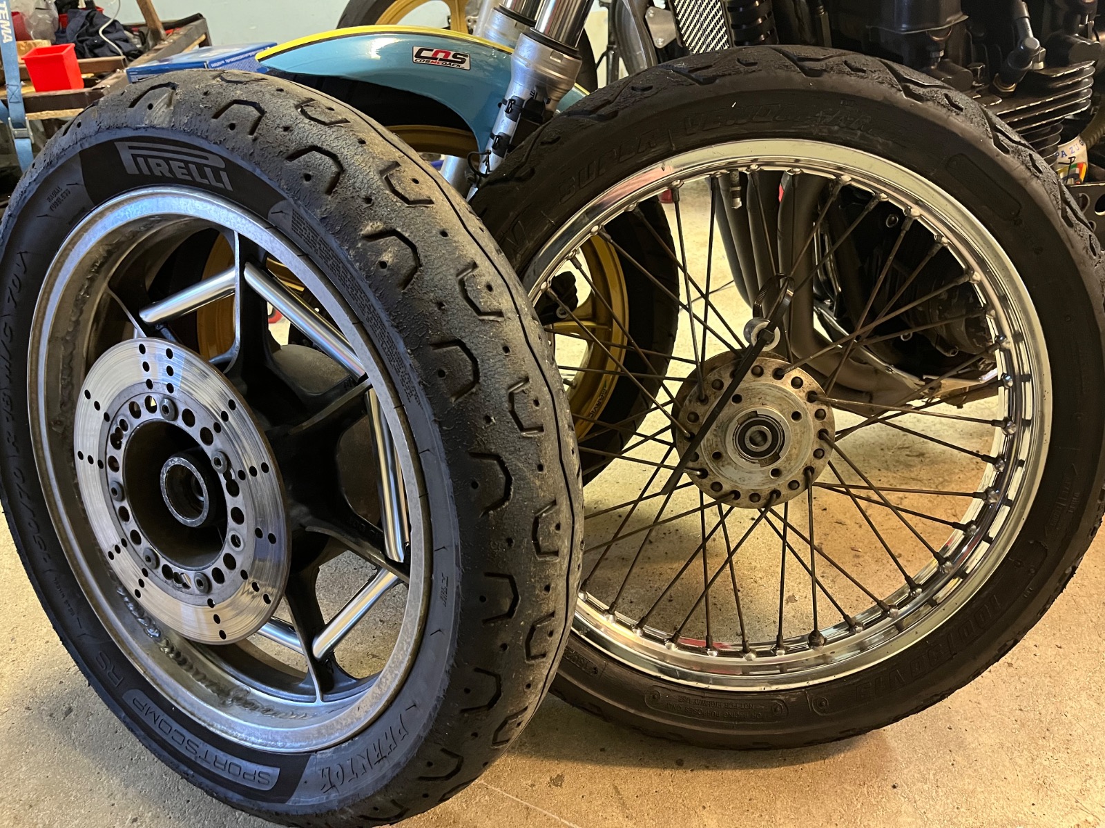

Yes it’s the Yellow/blue 650 that I plan to flattrack. I know it’s too heavy but it’s just for fun.
The rules say preferably use spoke wheels or cast wheels have to be covered so foots don’t get inside. And no front brake.
I will use “worn out” roadrace tyres so I widened a stock rear wheel to take a 150 rear tyre from my magnesium race wheels.
I have a Z1 front wheel and an old Avon AM18 19” that was too soft for road racing.
after that I will try to change the rim and spokes to 18” so I can use my old front tyres from the road racing.
Any advise on 18” spoke/rim conversion kits that will fit the Z1 front wheel?

kits? dont think there is anything sitting on a shelf for vintage road racers..... in all the racers i built, wheels always where a mix and match of stuff, my recomendation is to go with hubs that will take the brake discs you want to use. but basicaly, everything was cusotm, caliper hanger, spacers, etc.
if you want light, GN250 front is a nice hub and easy to find discs for or also CB500 hub
in the rear i used all sort of motocross hubs,

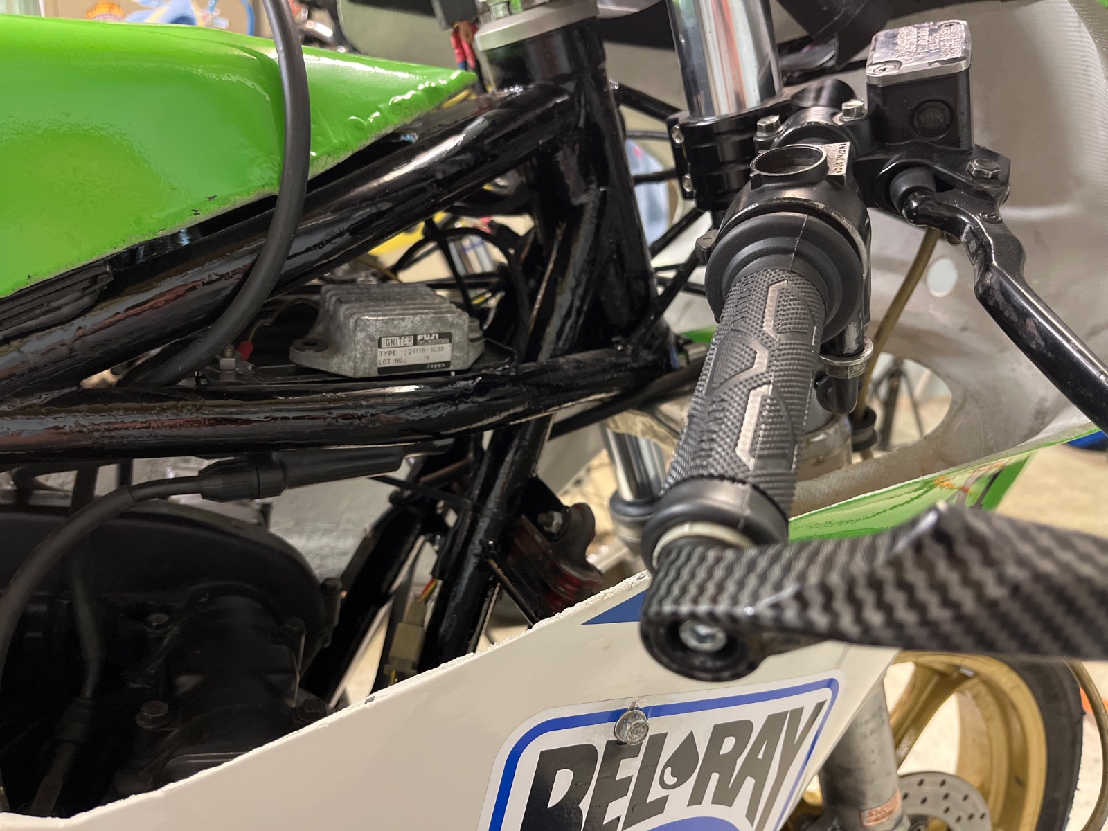

I have tried the Moriwaki 400 replica on track and I thought I sorted it out but today at the end of the second stint when is was really hot the bike started to spit and misfire. Almost like it didn’t get enough fuel.
Never had similar issues. Could it be fuel boiling in the filter or something with the ignition?
I turned it off for 10 minutes and then it was fine.
I’m going to Nurburgring this week for the first race so it’s a little late to find a problem.

Possibly a coil breaking down - can you "heat shield" them ?

22 Jul 2025 12:21Maybe the fuel filter gets to hot in there?
It happened when i got stuck behind a slower rider so maybe the fuel flow decreased to much and started to boil?
Engine is basicly ZX550 1984 specs but higher compression.

22 Jul 2025 12:27The coils and ignition box sits in good airflow but maybe if it’s beginning to fail?
I will bring both my small Z bikes to the race. Maybe I should swap the ignition systems between them and see if the problems moved to the other bike.
