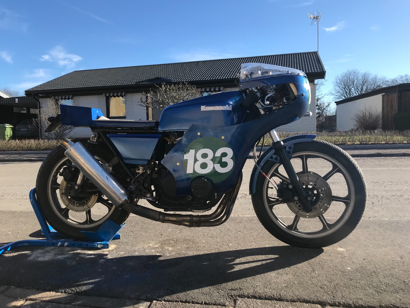

I bought a bike and fitted some old fairings, big oil cooler, 4-1 exhaust, foam air filters, steel braided lines and new pads.
I shortened the front springs and put a long spacer to compress the spring more and welded one of the holes in the “damper” to get more damping.
But the forks are still not very good
Maybe it’s possible to use forks from another bike? Preferably one with 18” wheel as 19” racing tires are limited.
It has to be parts that was available 1980 because of the regulations for classic racing in Sweden.
The only racing tires I found are Avon AM18, F2 and AM26.
Has anyone here got any experience from those?

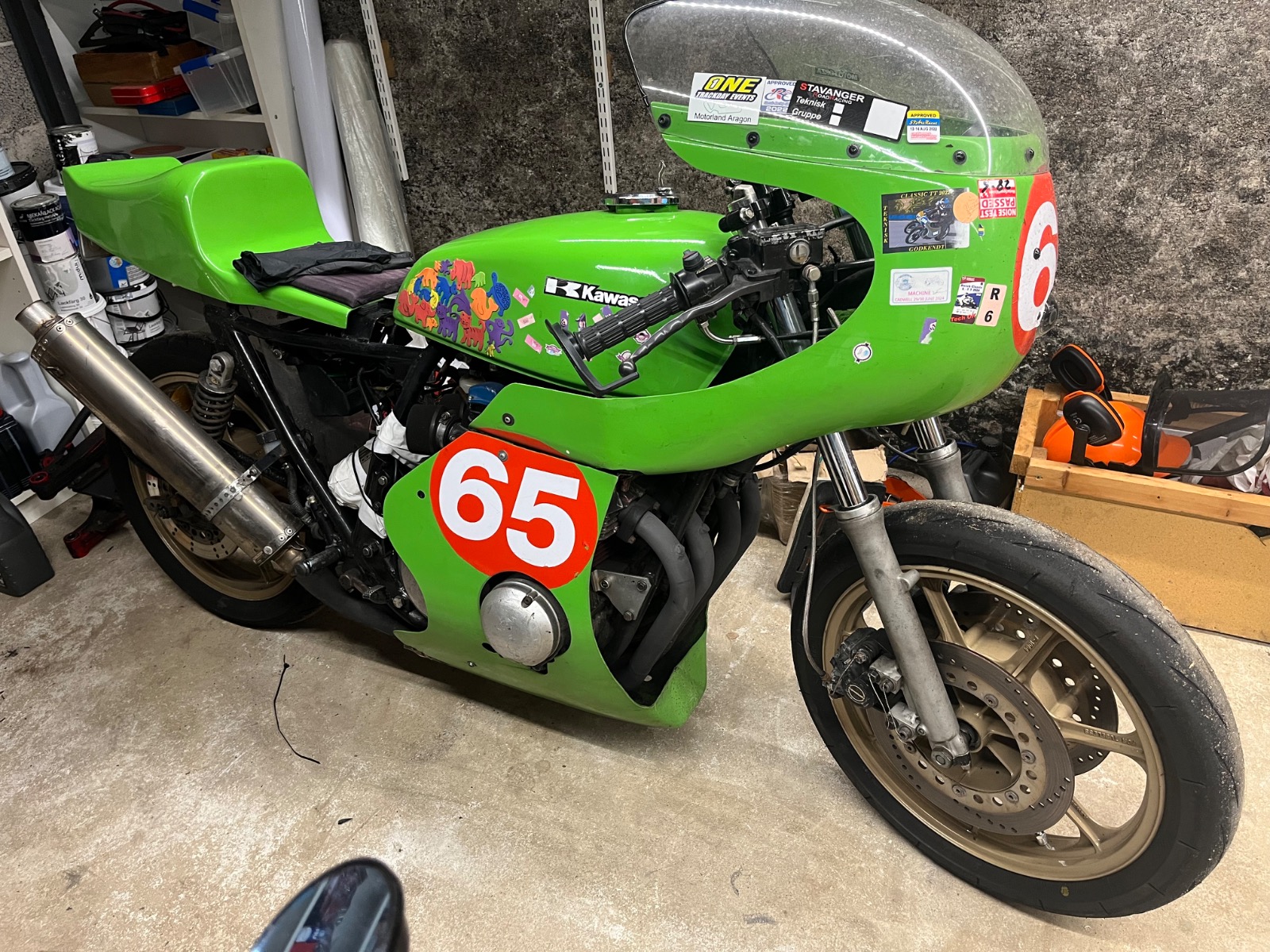

What started as an interest for racing has developed to an interest for classic bikes and mostly Kawasakis.
I started racing with a GSXR600 but realized modern racing is too fast for me and I didn’t like to switch between slicks/raintyres.
The 1980 500cc class in classic racing looked fun so I got the Z500. It has now developed a bit and got a new look. Inspired from an Z500 Isle of Man F2 racer in 1980.

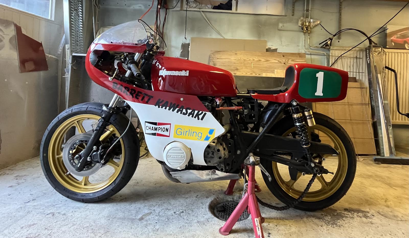

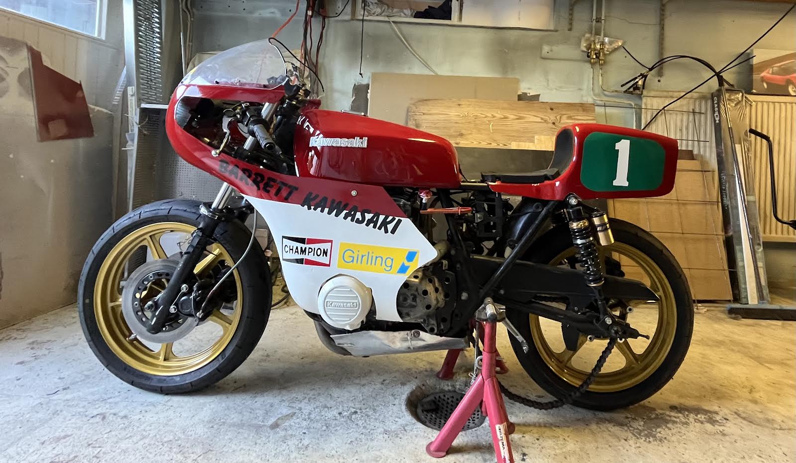

Then I wanted a bike for the 1300cc class. Z1s was to expensive so I bought a Z650 frame and put a GPZ750 engine in it.
It worked beyond expectations and I hade a good chance in the championship but I was disqualified because the GPZ engine was too modern. Many of my competitors run bigger and even newer engines than me so I didn’t like that.
Decided to try to win the championship next season and built another 650 but with a 650 engine this time. With 810cc kit, better suspension, brakes, magnesium wheel and lots of weight saving.
Painted it like Crosbys Suzuka/Isle of Man Z1.
I know some people don’t like this as it’s not real but I think it looks fun. The front fairing is acctually from the same
mould as the original bike and the wheels are Marvic Morris replicas. Otherwise nothing the same.
This bike is fast and has won every race in its class. I ended up winning both the 1300cc and 500cc championship.

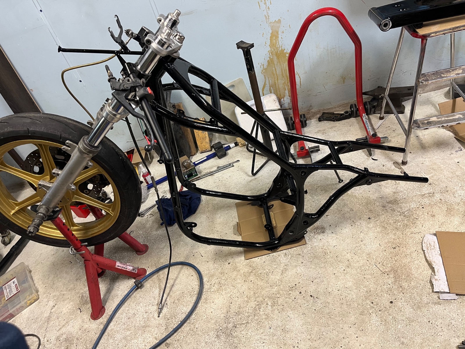

But I wanted a better 500 so I decided to build the Moriwaki Zero X1 400FX replica.
Here is the frame finished and painted. I hope to put it together before the seasons starts.
