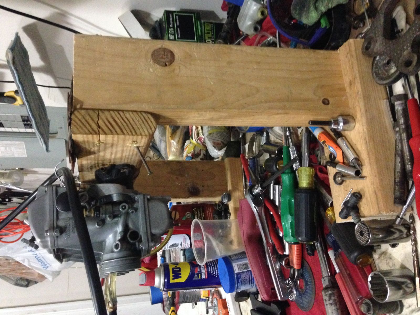

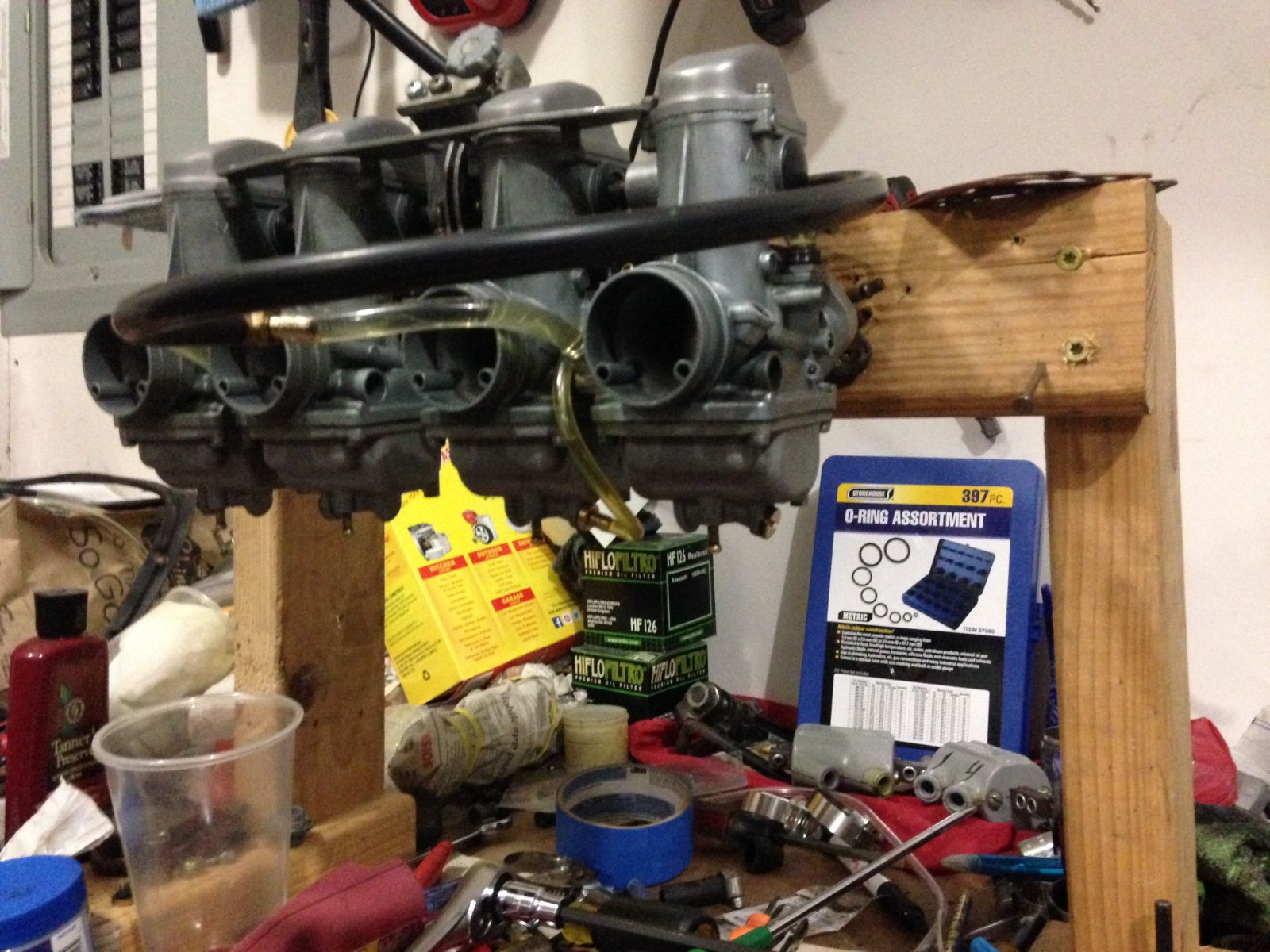

Carb Stand from old carb holders.

Re: Carb Stand from old carb holders.
18 Nov 2015 11:44
Sure beats hanging them up with wire. Now that I have new holders I can make one for myself.
