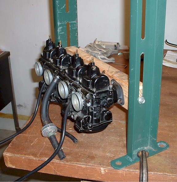

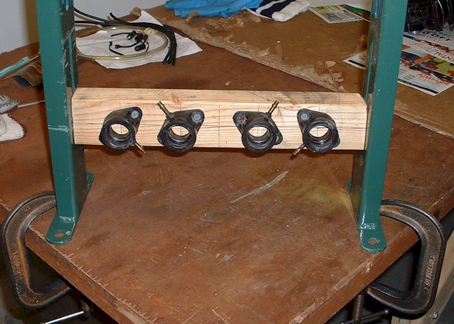

Ordered some new carb holders from Z1 Enterprises.
....so what to do with the old ones?
Make a carb stand.
Make a carb stand.

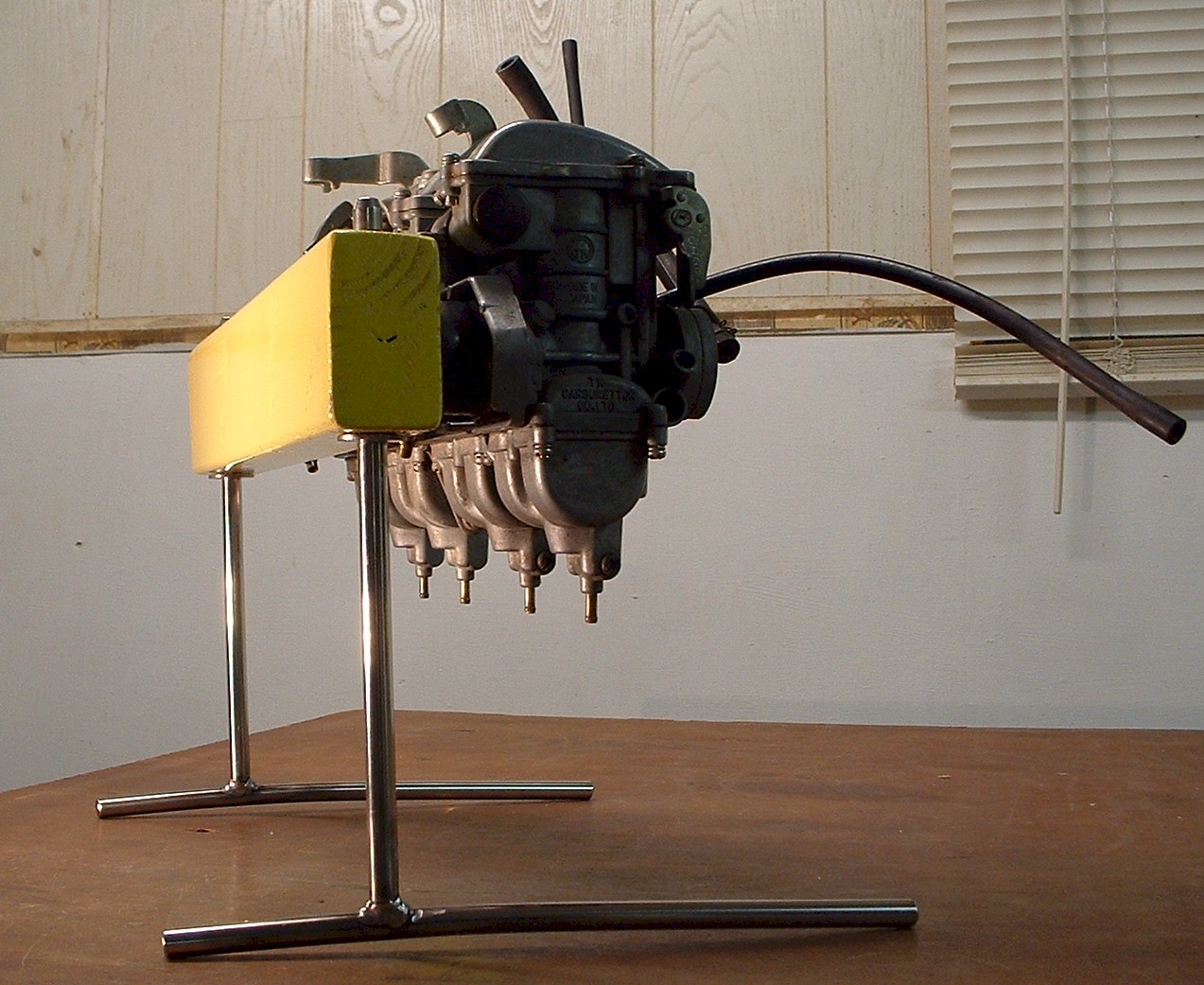

15 Jul 2012 10:14Old Man Rock wrote: Jesus Christ Lou, how freaking heavy are those carbs where you need such a strong support...?
Better add a 20 Ton jack to raise them sonsabitches...:blink: :whistle: :laugh:
Heh, it's temporary. I might make something more permanent.
However it does need some strength, notice my version acts like a rotisserie so I can flip them over.

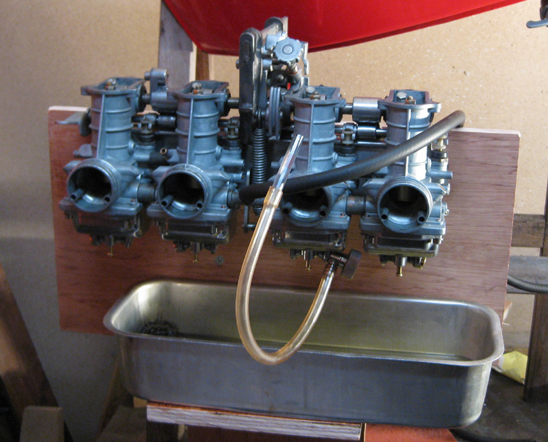

15 Jul 2012 19:55 - 15 Jul 2012 20:06loudhvx wrote: ...notice my version acts like a rotisserie so I can flip them over.
That's actually pretty neat, also makes it really easy to set the carbs perfectly level before checking the floats.
Btw, I found that it's nice to have a drip pan under the carbs, I used an old bread form.

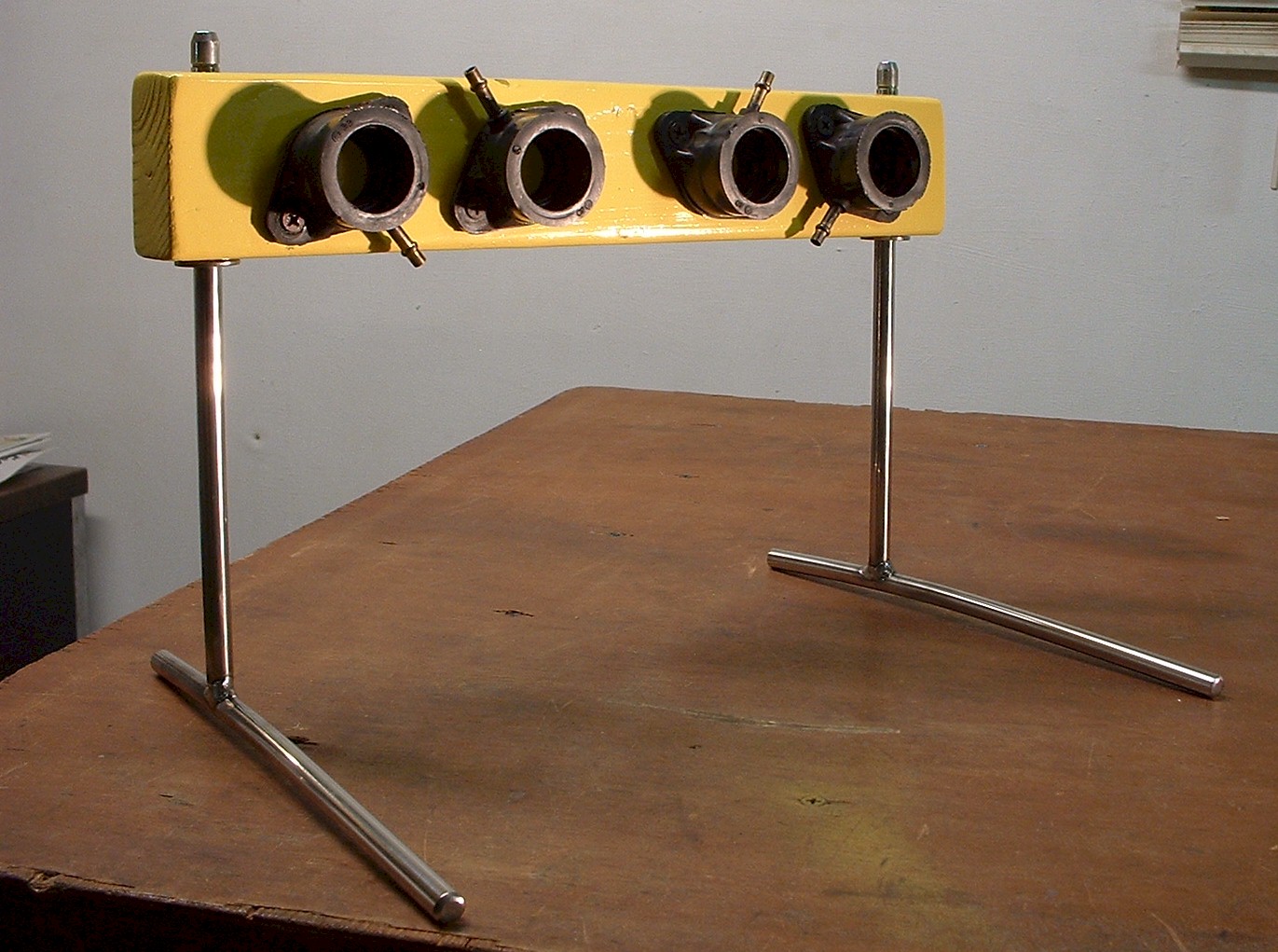

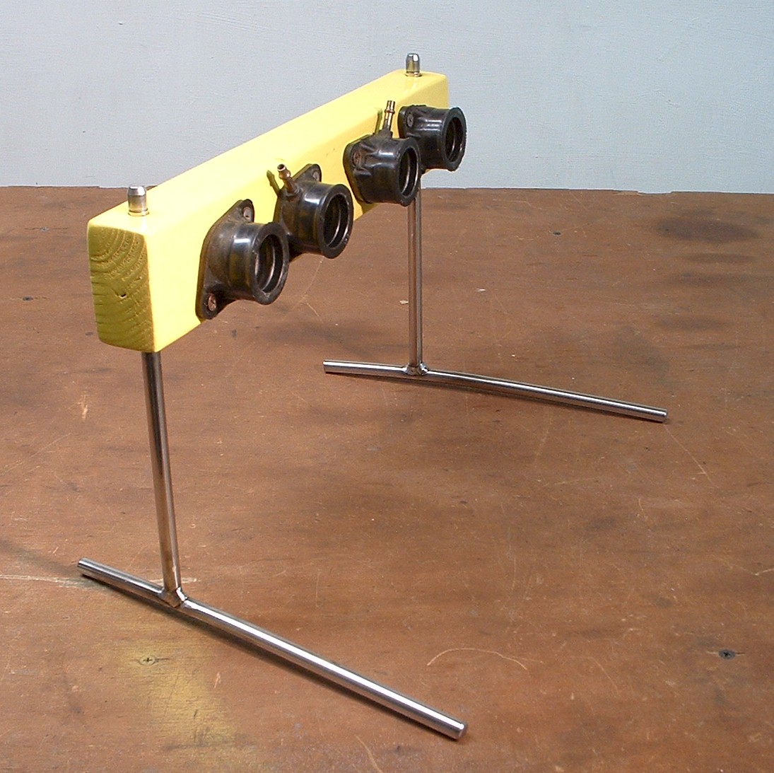

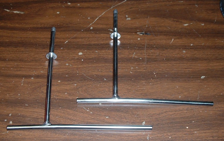

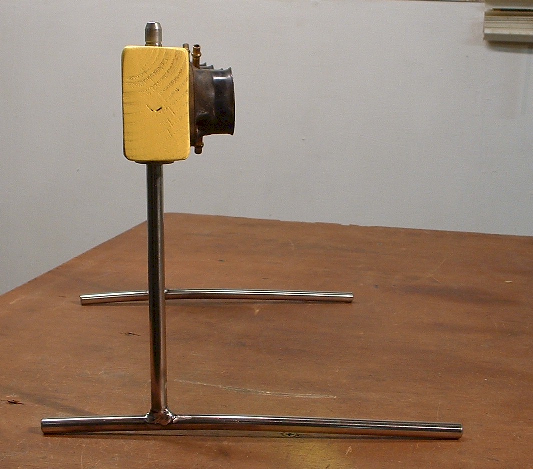

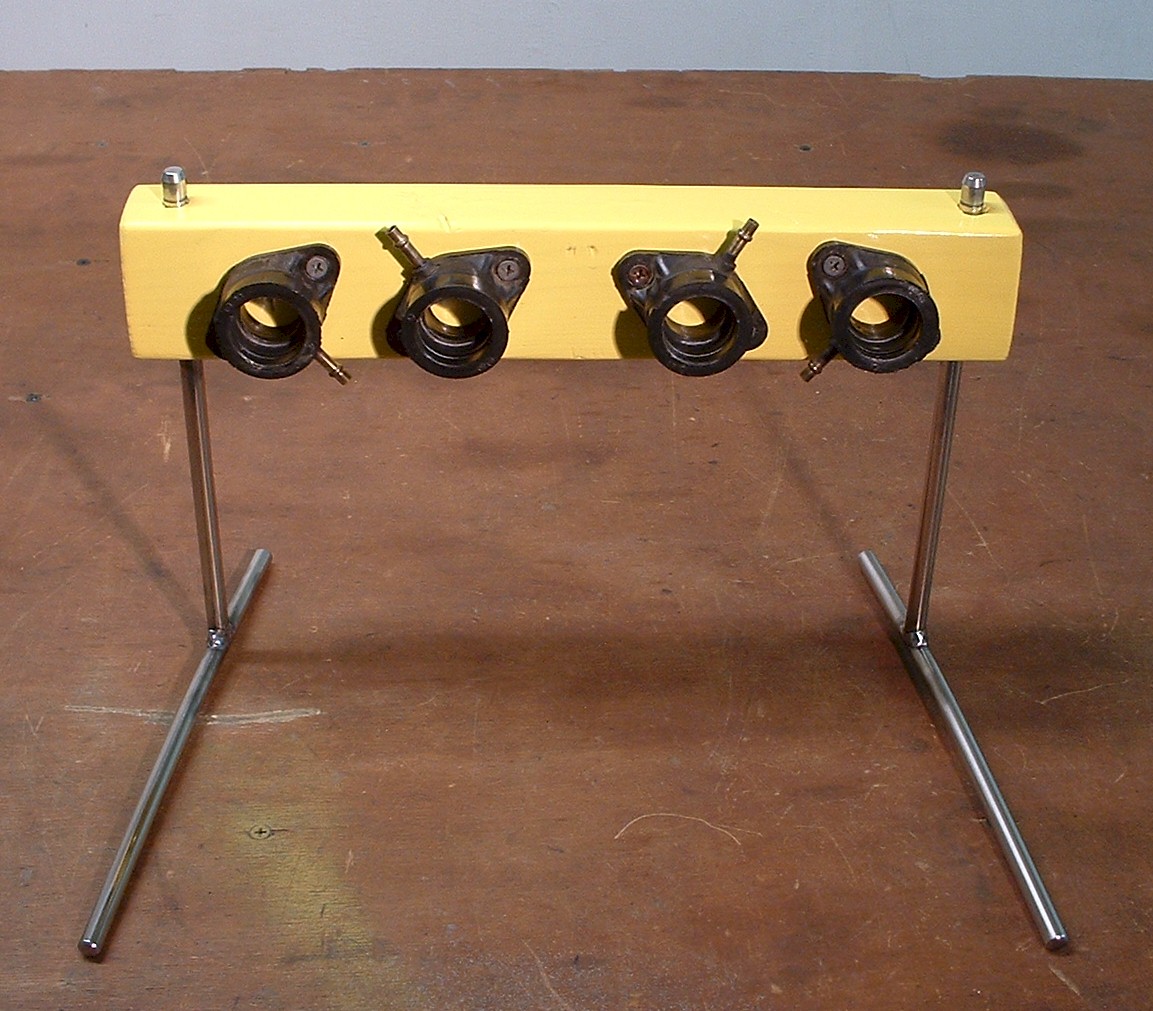

Alright. Found some polished rods at work... super hard and strong, and pretty. So I made some legs...
I like OnkelB's pan idea, so I left room for a pan. The legs can swing wider if necessary and are self leveling... to do that I just wobbled the drill bit so the ends of the holes are wider, but the middle of the holes are still hold tight on the legs.
To flip the carbs, i just pull off the legs and put them in from the other end.
The legs can also fold flat to hang the whole thing on a wall.
Then had some left over paint from the bike stand....
Hope this will appeal to Dave's more delicate sensibilities.
