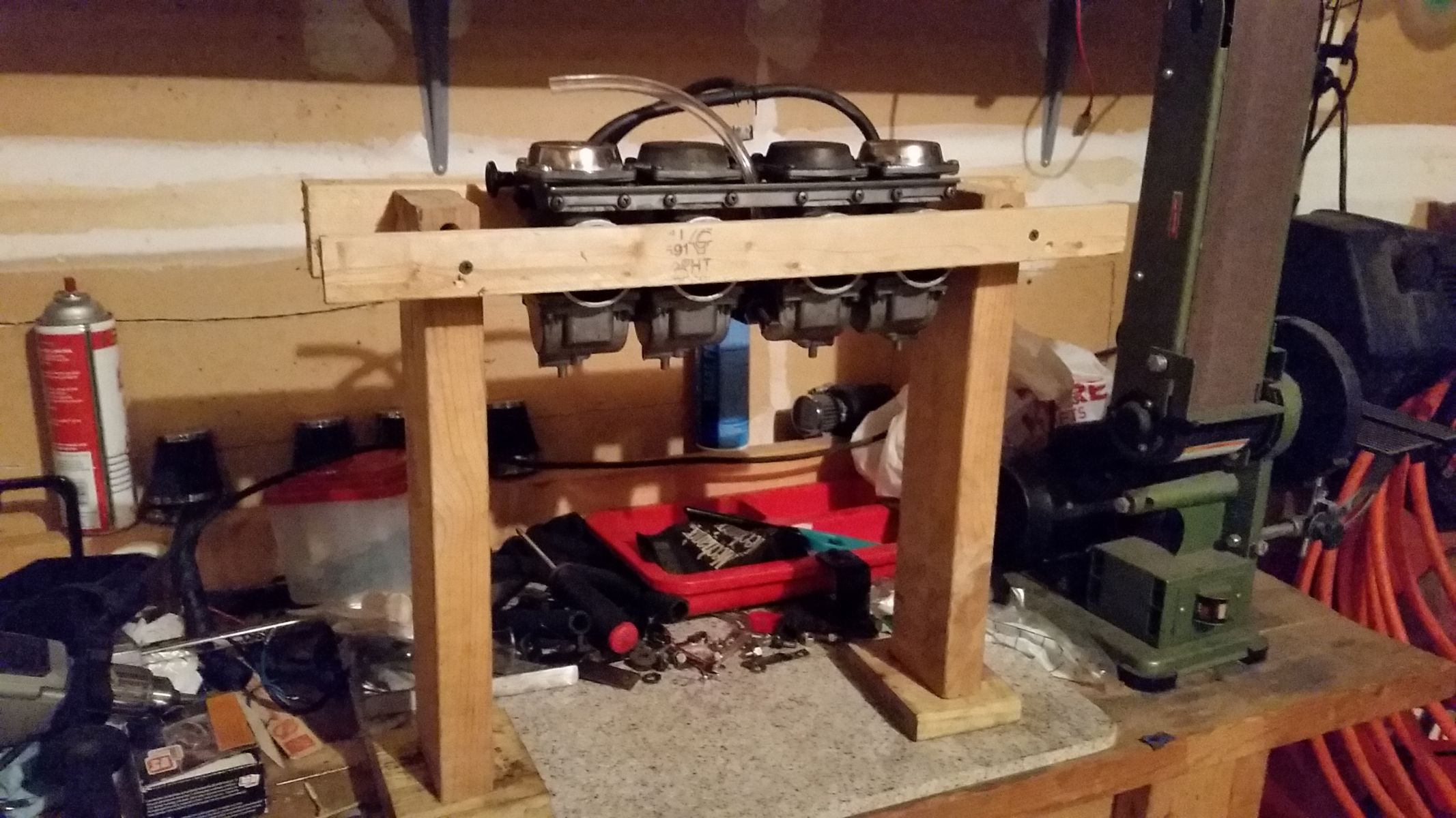

Low budget (2 scraps of wood, and a few drywall screws) nowhere NEAR as elegant & sexy as some of the others here, but necessity is a mother!

Can't argue with what works!
It's like folk art, it may not be pretty, but I like it!

dammit just saw this. I threw away the old parts when I replaced them and had to do this ...
then realized I can't get to the drain screws! haha
