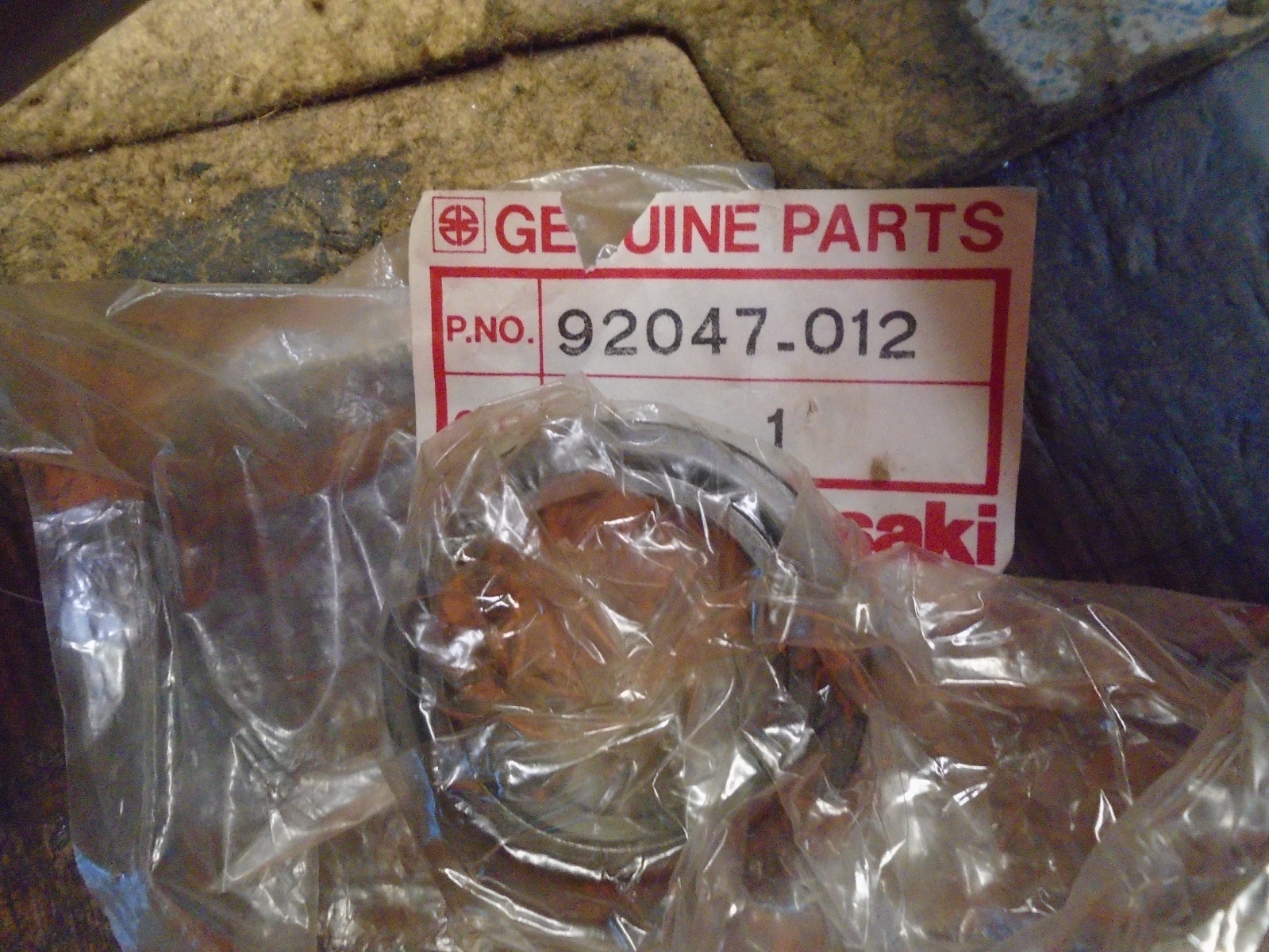

It was a bit expensive to order with brexit  but i ordered it anyways thanks it look like a quality set. Really thank you thats a company I will keep in mind for the future.
thank you Mr Wookie appreciate it really

You can also take the numbers/code stamped on the old bearing and do a search at 123roulement dot fr or similar

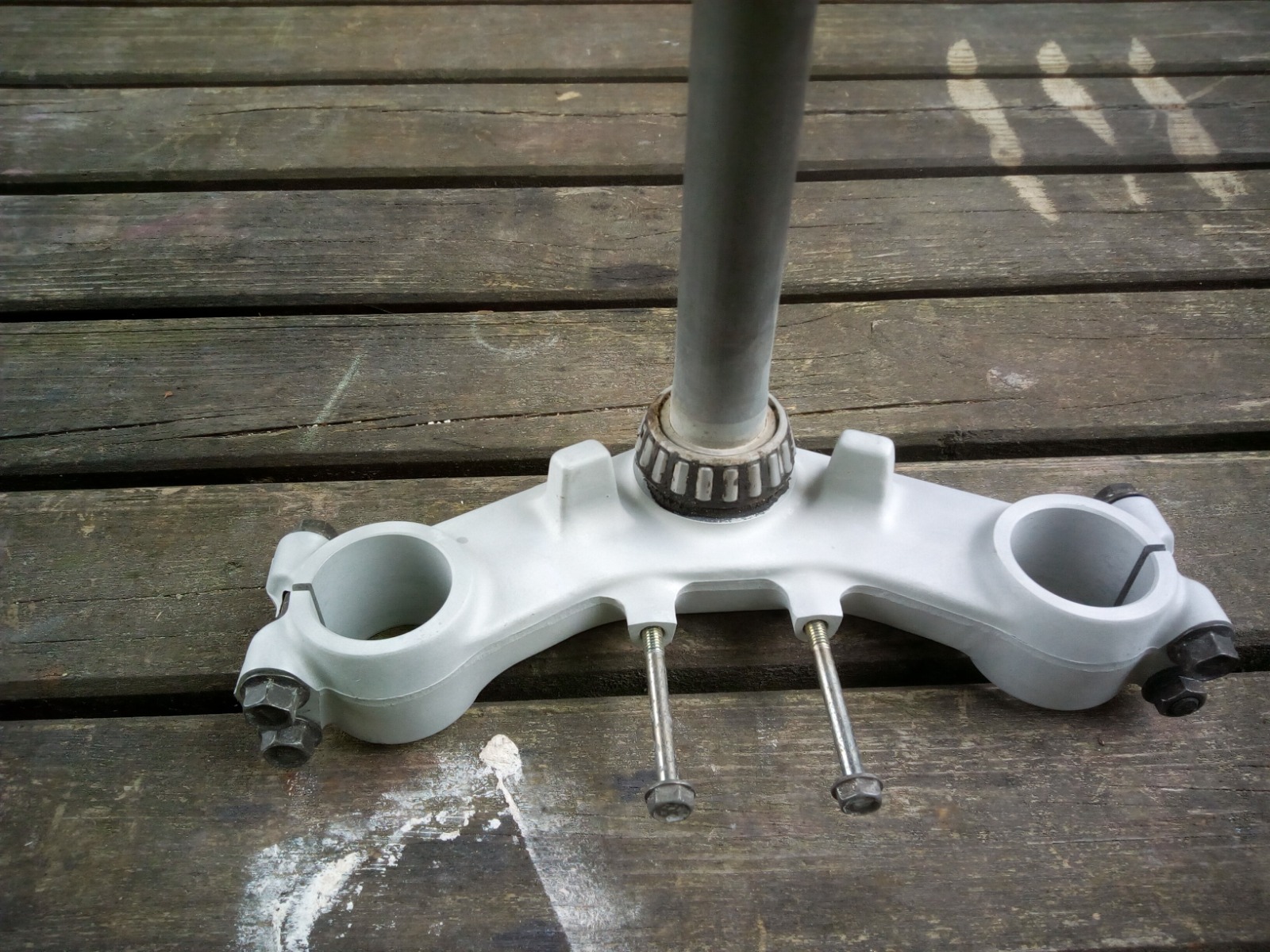

So ordered the new bearing but has anyone got any tip for removing the old bottom one.
I was thinking a heat gun after putting the lower tripple clamp in the freezer. Or is there an easier way to do this.

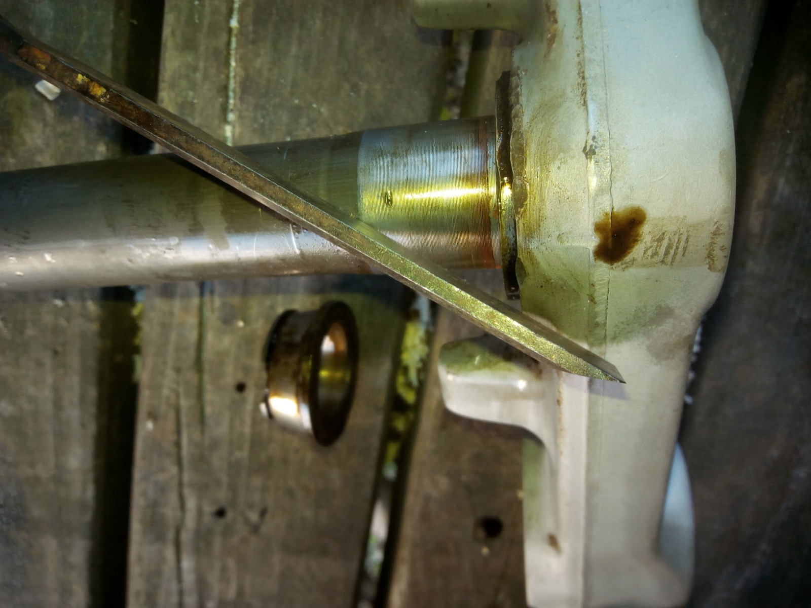

A sharpened old chisel

Aim the chisel between the bearing and the lower yoke. If you take more care than I did you'll get away minimal marking on the lower yoke. Work round the bearing easing it up

+1 on the chase it off with a chisel- just make sure where you clamp the stem in the vice that you clamp a non-critical area (not where the bearings sit) - if you have access to to a propane torch or similar heating the old race will help

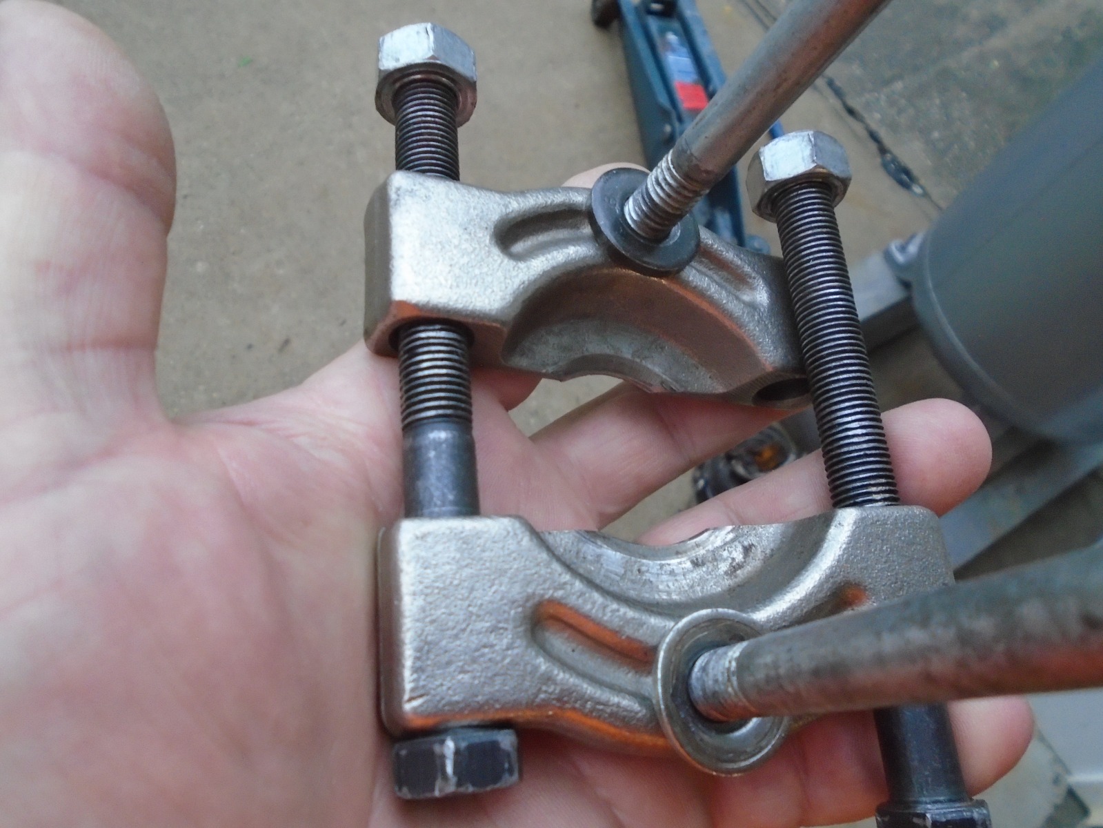

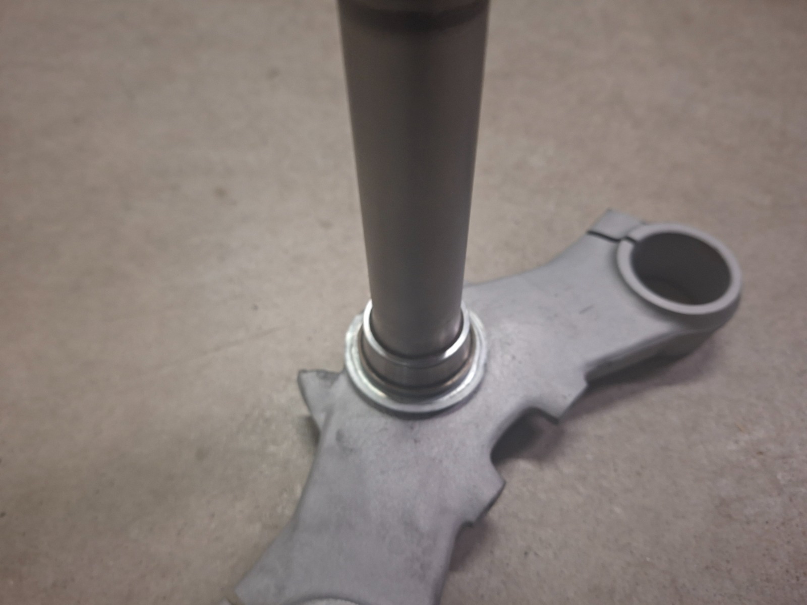

Unlike what "another brand/model" Moizeau is showing where race is full pressed flush with lower triple tree, your Z/KZ is only flush on the most inner section around the shaft. Meaning there's a relief purpose built into this race to facilitate use of a double lipped rubber seal. While you can pound away with a chisel using it as a wedge i just simply use a bearing puller/separator. walks right off with no      damage or pounding.

Just looked at his photo again, yeah, a bearing puller would work as there are no lock stops in the way. My photo is a GPz11 Uni

I would completely agree if you have a suitable puller- if not I have never had a significant issue chasing these (and half shaft bearings) off with a chisel

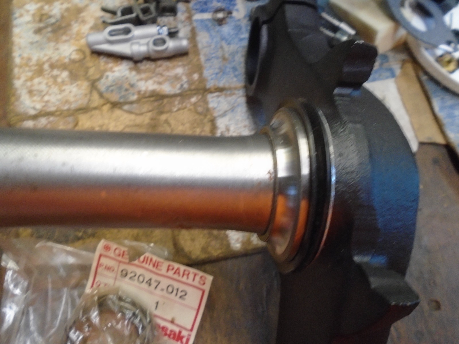

So I might aswell ask how about putting the new one on any advice?
