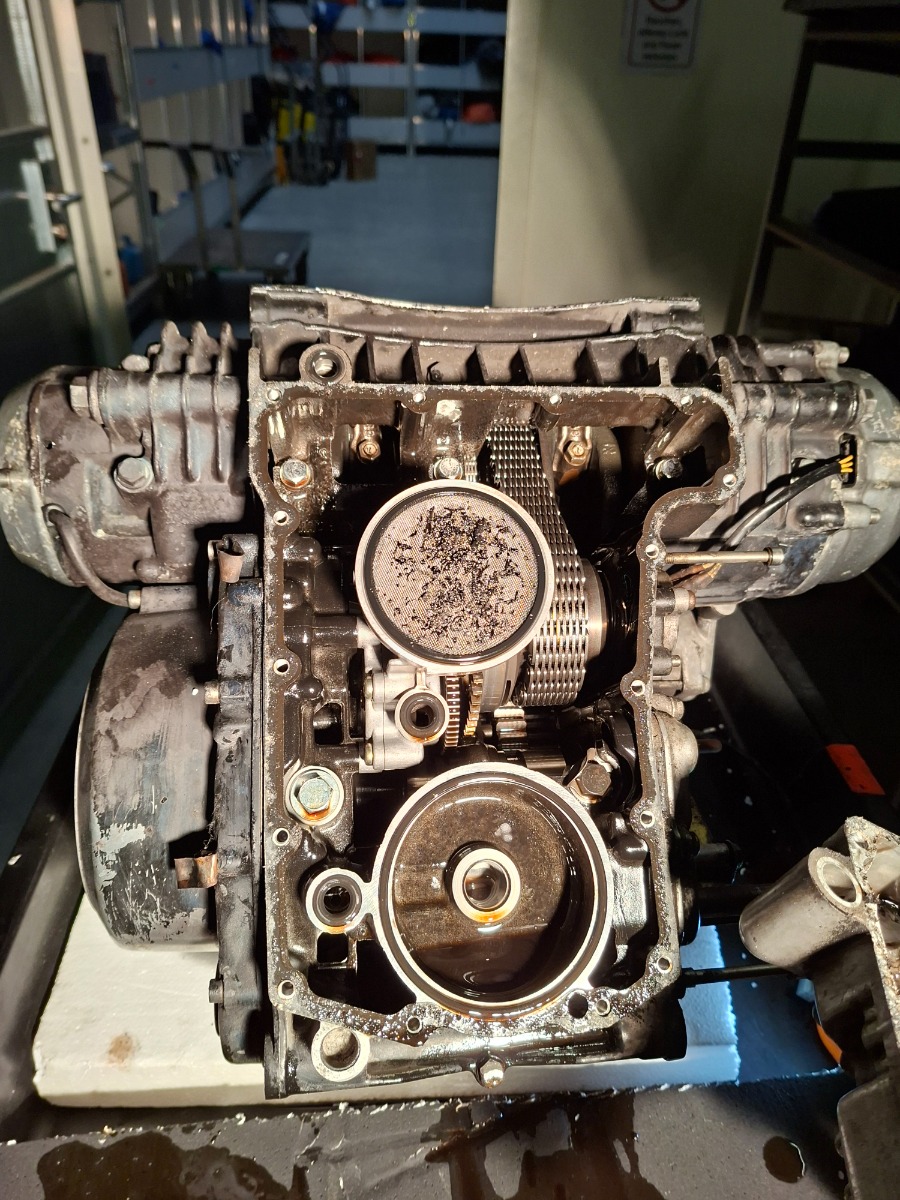

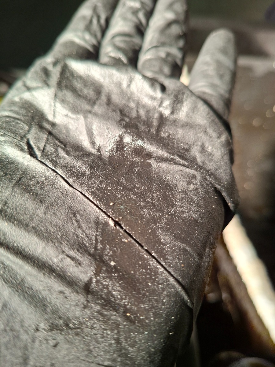

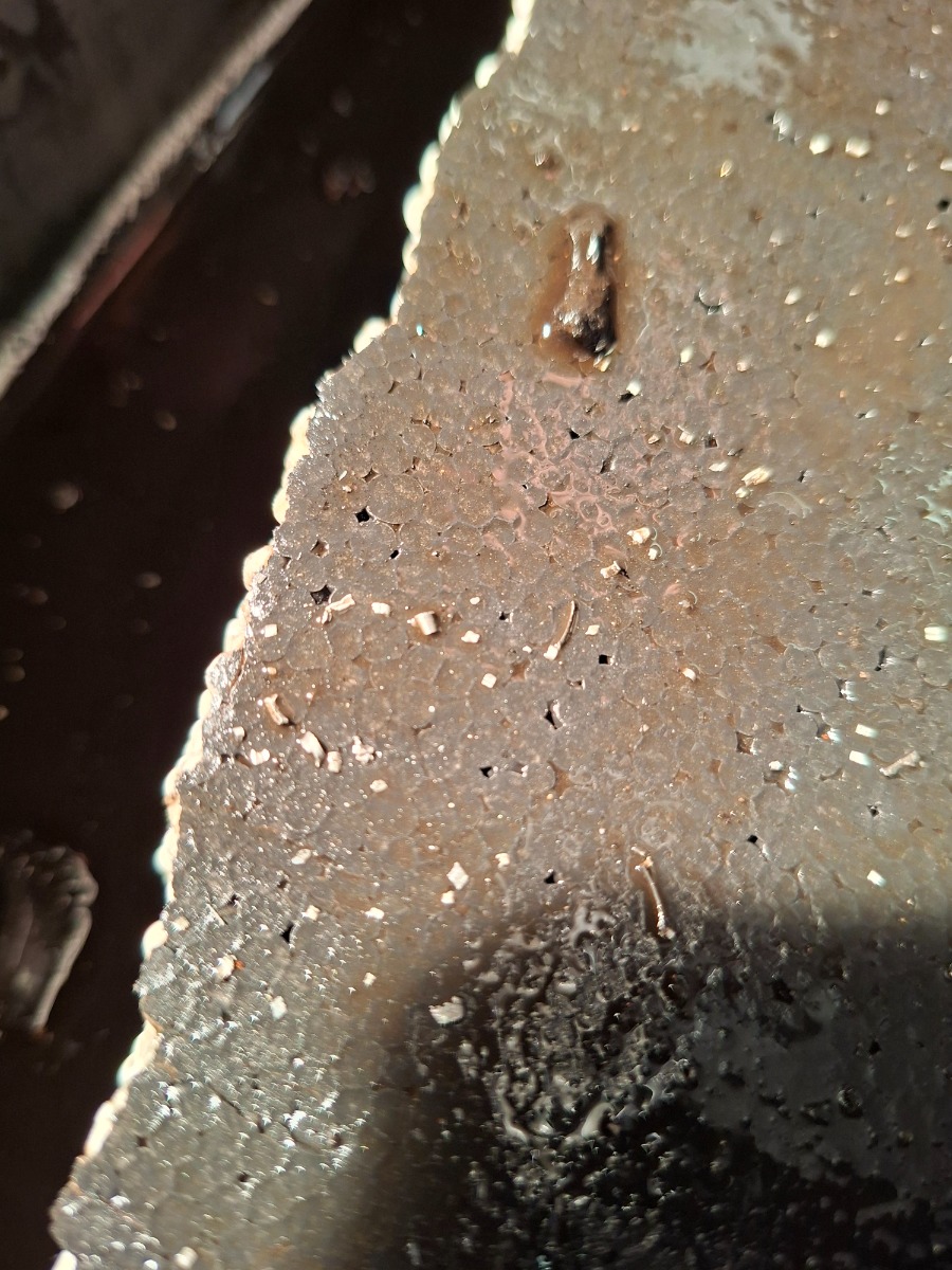

When splitting the case do you need to remove the oil pump and drive chain also. Also i have some shiny silver in the oil pan. If we are right the bearings are usually brass. We are going to check the timing chain next.

As you are new to this game I strongly suggest you follow the manual "step by step". You need to remove all the side covers etc and the shaft holding the starter clutch and primary drive. Is that "rubber debris" on the oil pick up ? did you find any worn/loose components yet ?

Yeah it was all soft material on the oil pick up. Nothing is showing signs of wear but we do have way more silver flakes than i would like to see in the oil pan.

10 Feb 2026 04:19Post a pick of the flakes if you can, if there is no play in the con rods where they join the crank and that debris is soft it may only be the clutch basket dampers and "cush drive" rubbers that are worn giving the knocking noise ??Yeah it was all soft material on the oil pick up. Nothing is showing signs of wear but we do have way more silver flakes than i would like to see in the oil pan.
