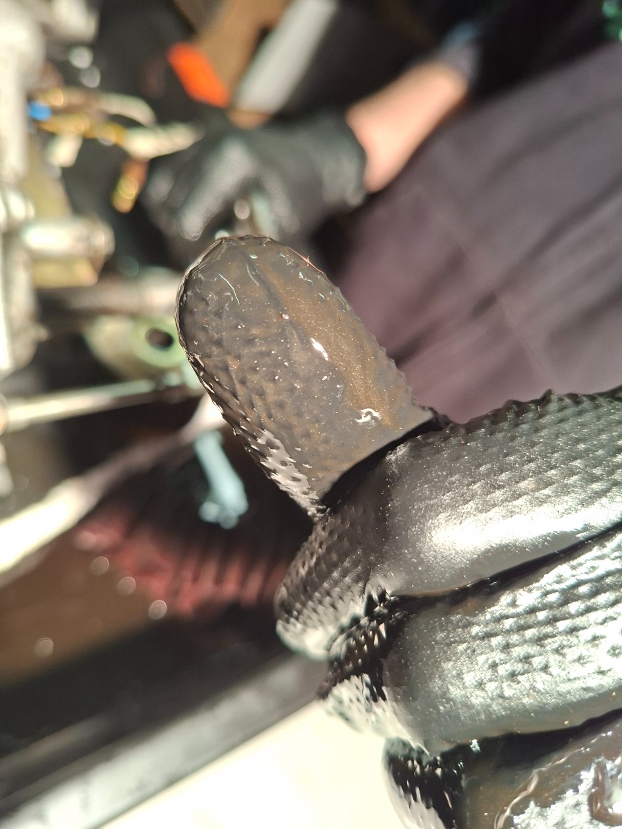

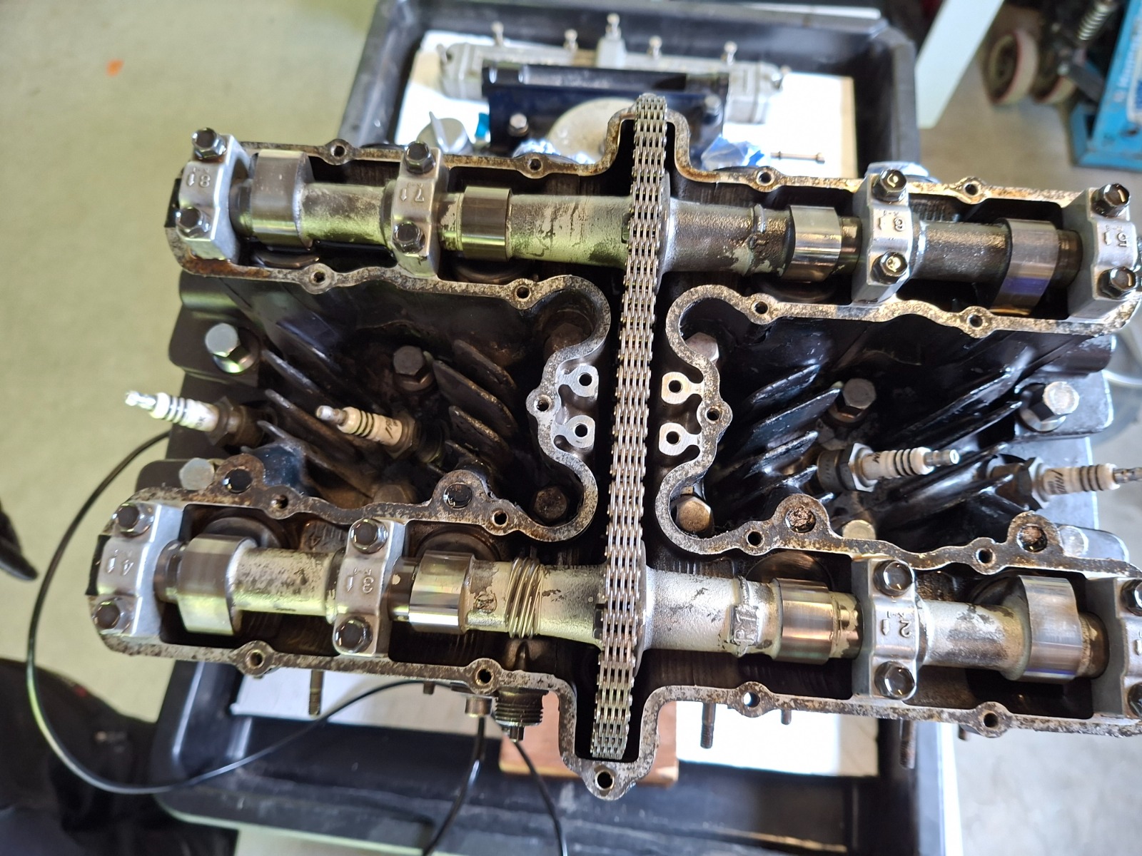

Yeah we are kinda stuck. No obvious damage to the cylinder walls. Lidl have a colour camera system with 2 cameras for automotive on special this week. Its only 20 euros.Its kinda good So my mate bought it. We scoped the cylinders on air in exhaust out and the spark plugs . With nothing. Looked around the bottom again nothing. I am now thinking I am crazy honestly. We did find some very very fine particals in the oil filter that where a bit copper coloured
So anyone have a clue my friend is in thailand for 2 weeks so I wont be doing much till then .
I am almost at the stage of buying a new bike. The cost to repair the motor from a professional is like 3k here I can buy a good Kz for 1.5k so I have to decide.

What I see there is all normal to find in a KZ engine where that oil pan has not been removed and cleaned (oil sludge, metal/hard rubber flakes) The crap on the oil pump screen is most likely the clutch hub rubbers or the idler pulley rubbers flaking off.
How much play is in the clutch hub? On a "good" hub you should only be able to move it 1-2mm. I have seen bad ones move from pin to pin, about 10mm.
You can only access the rubbers by drilling out the rivets, this is NOT covered in the FSM.

10 Feb 2026 09:38Really? How good is it? Better the buggered beast you know than an unknown (potentially more buggered) beast in my opinion. FSM and be methodical.

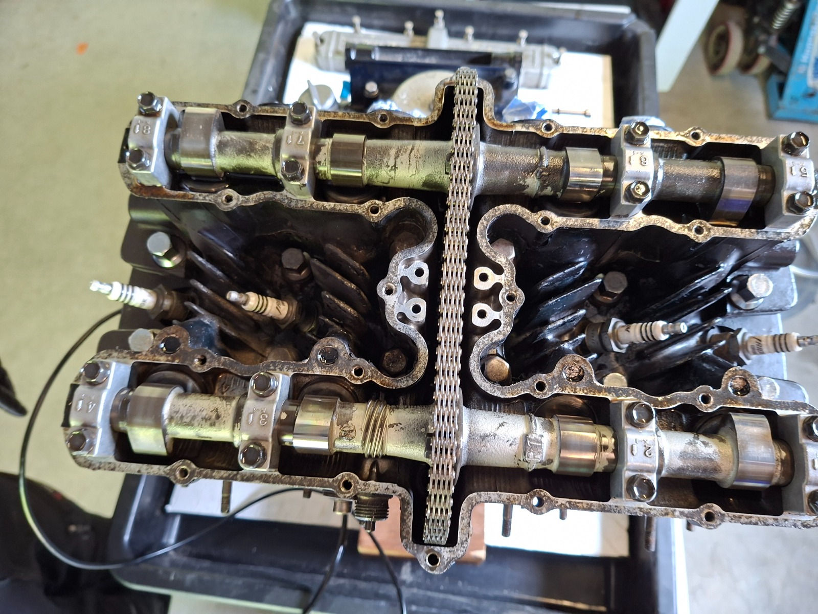

We had another look yesterday and pulled the two cam shafts out we where thinking it might have been the chain tensoner and guide rails but it all seemed fine. It wasnt so now its the bearings we think . I need some special tools to remove the clutch which i do not have.
I am now trying to find a new second hand motor.

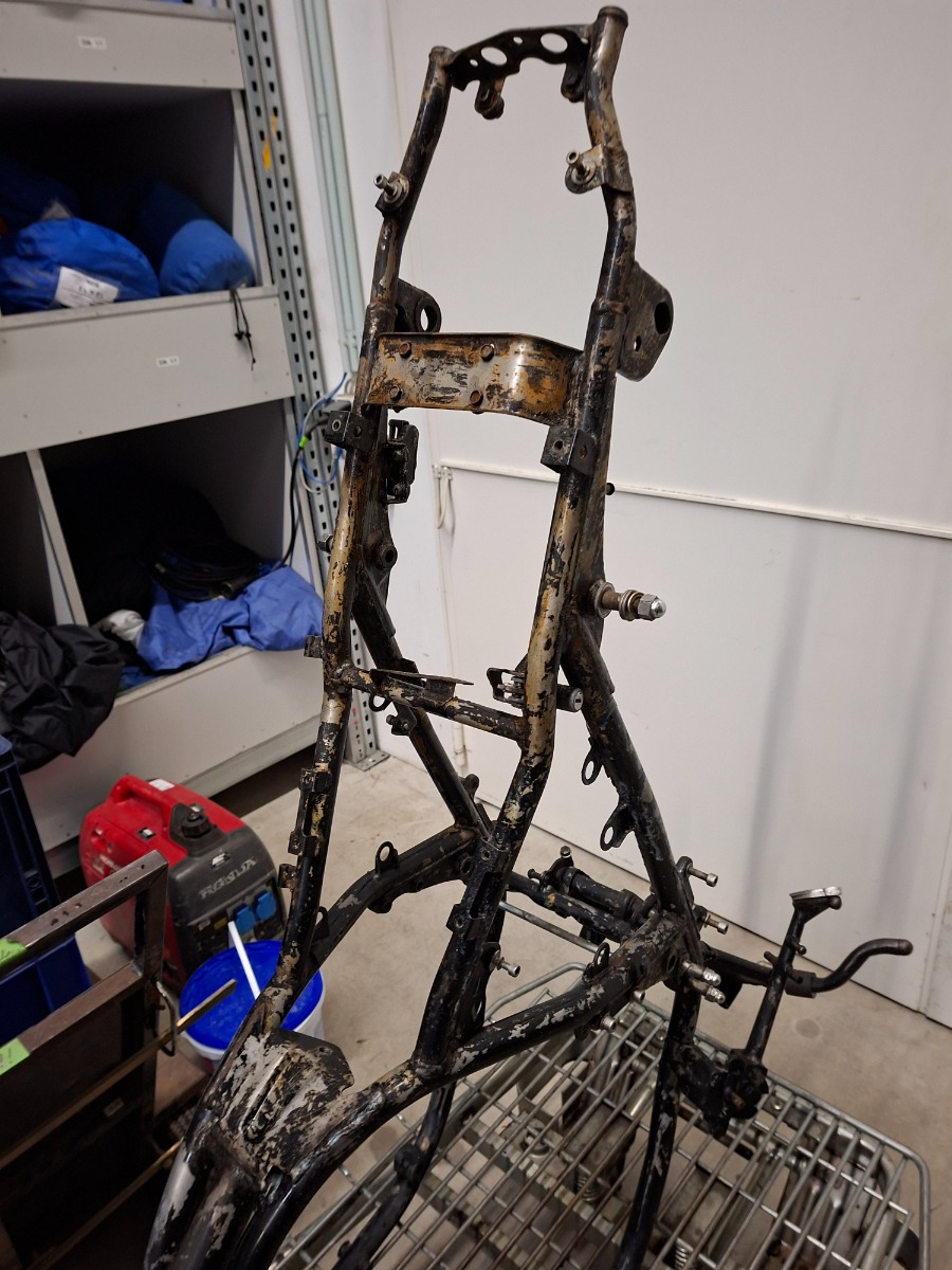

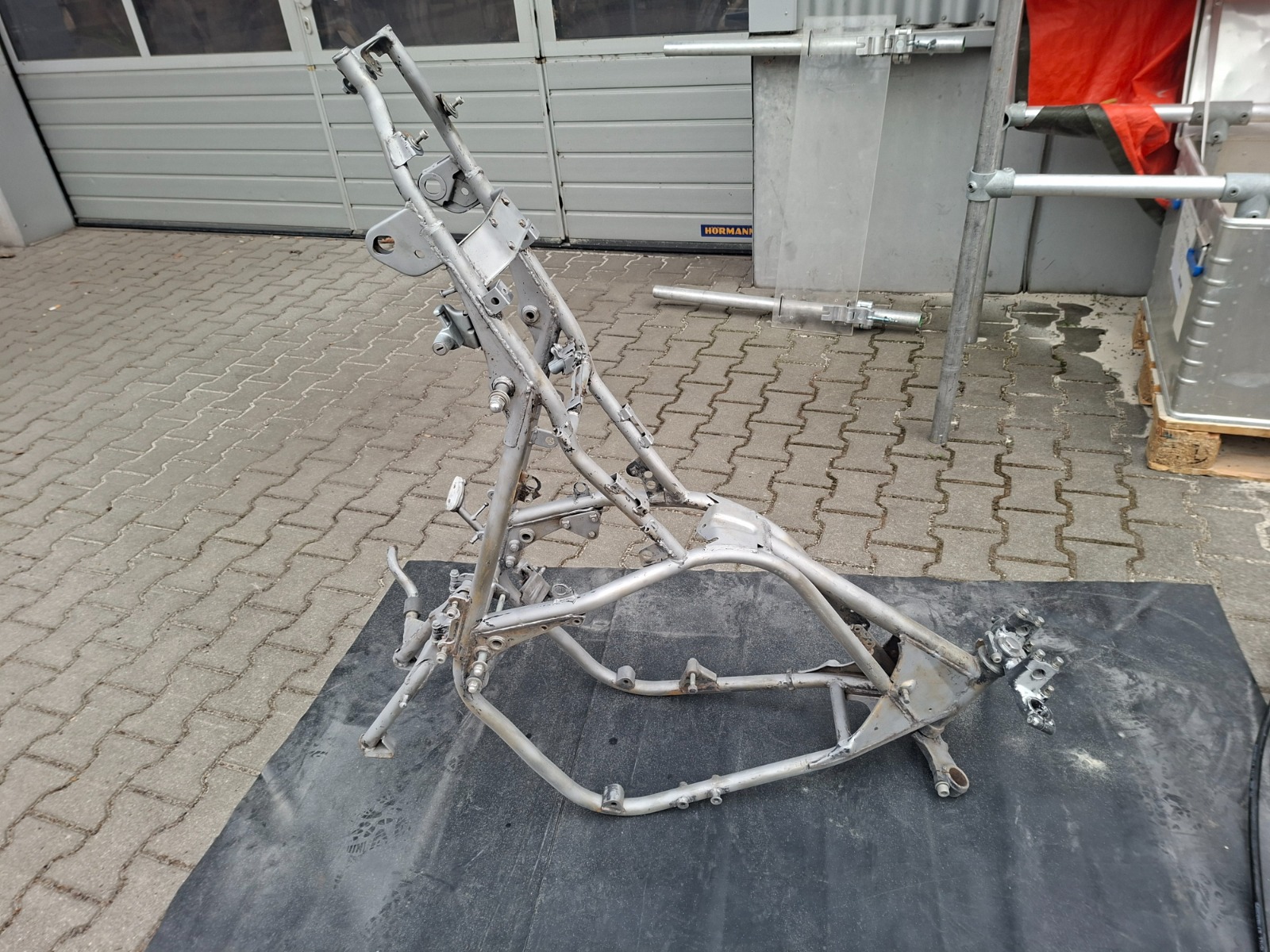

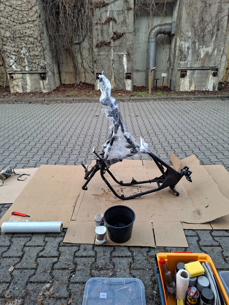

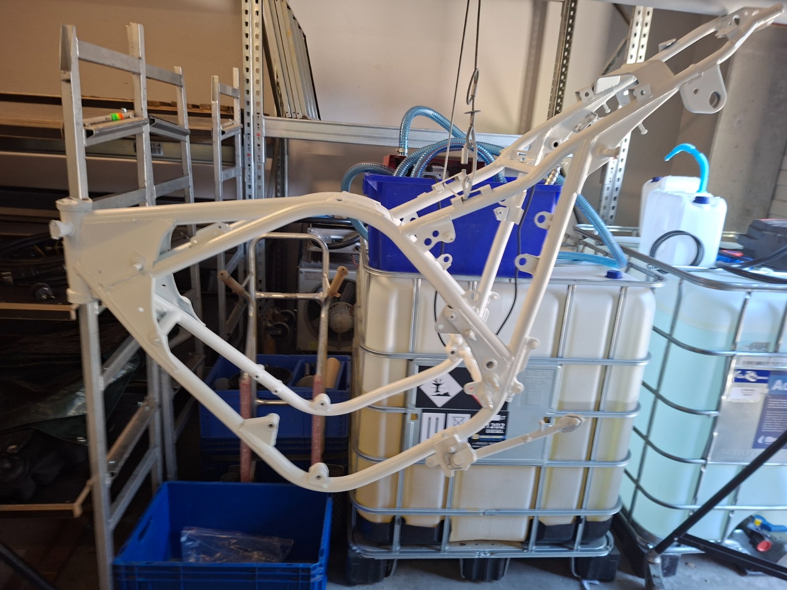

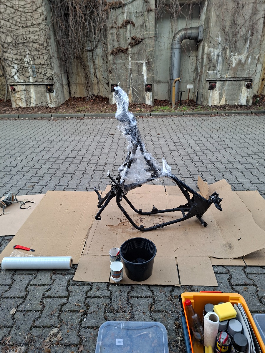

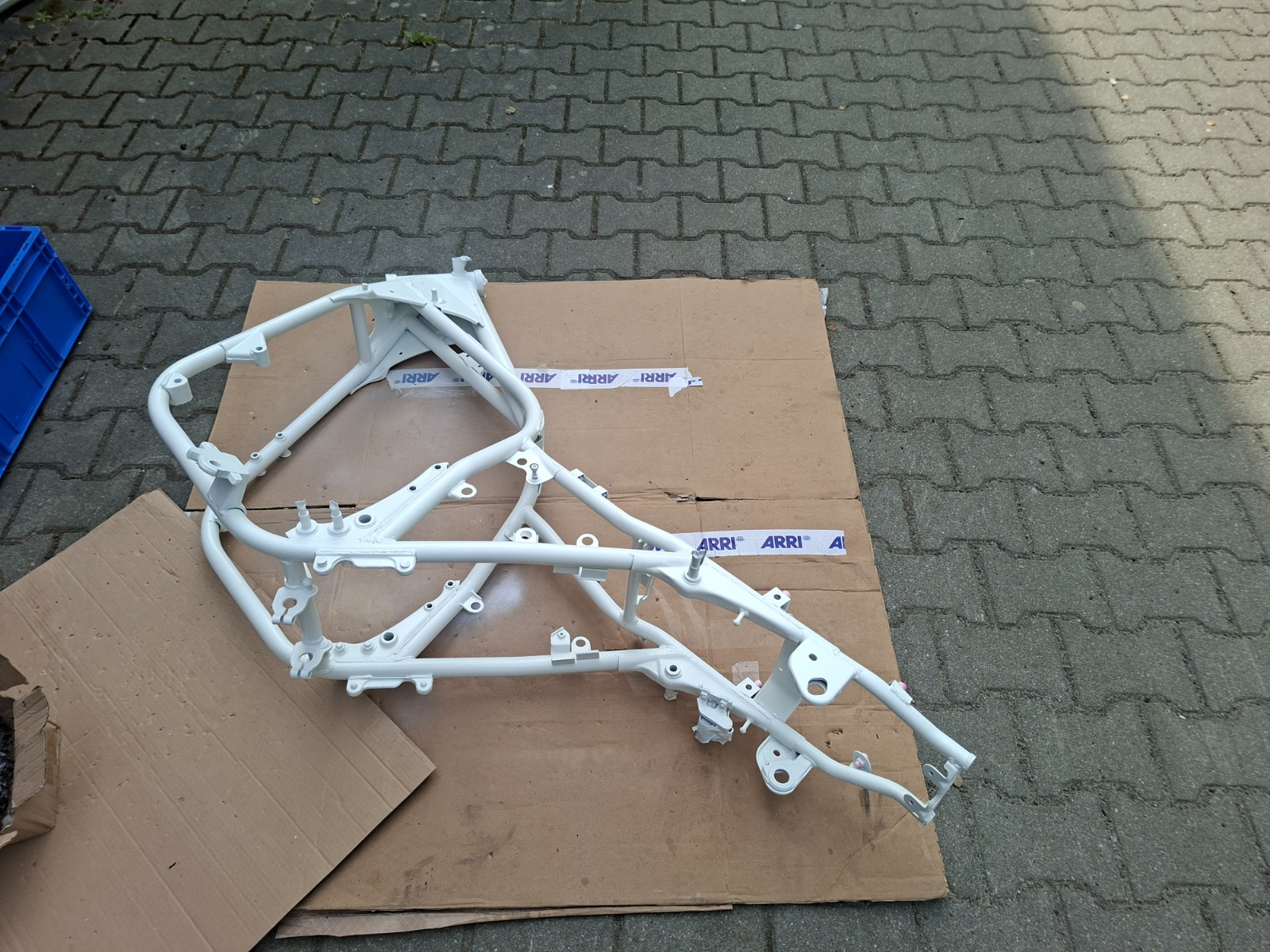

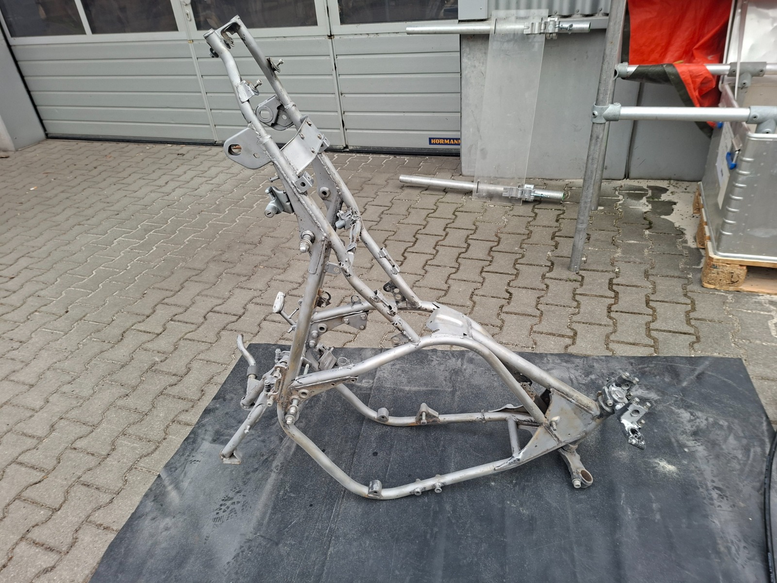

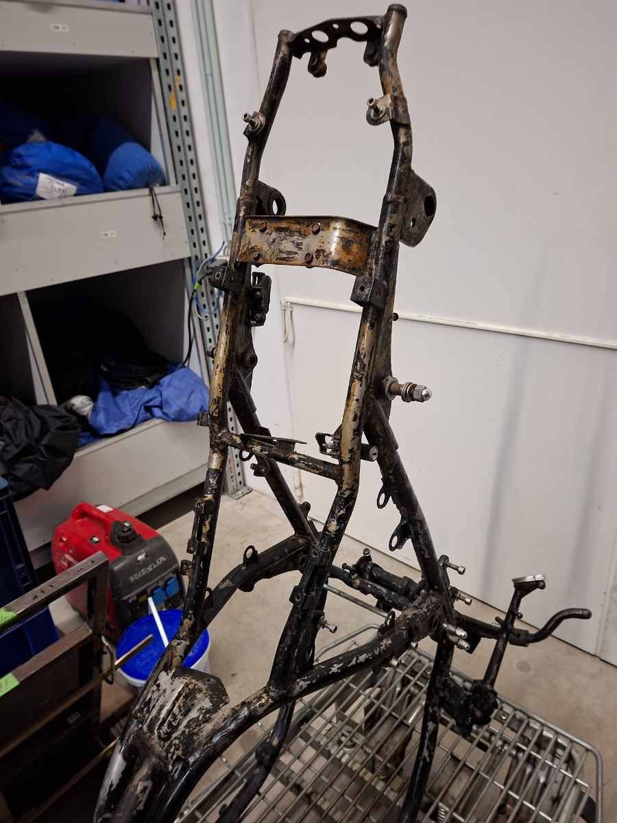

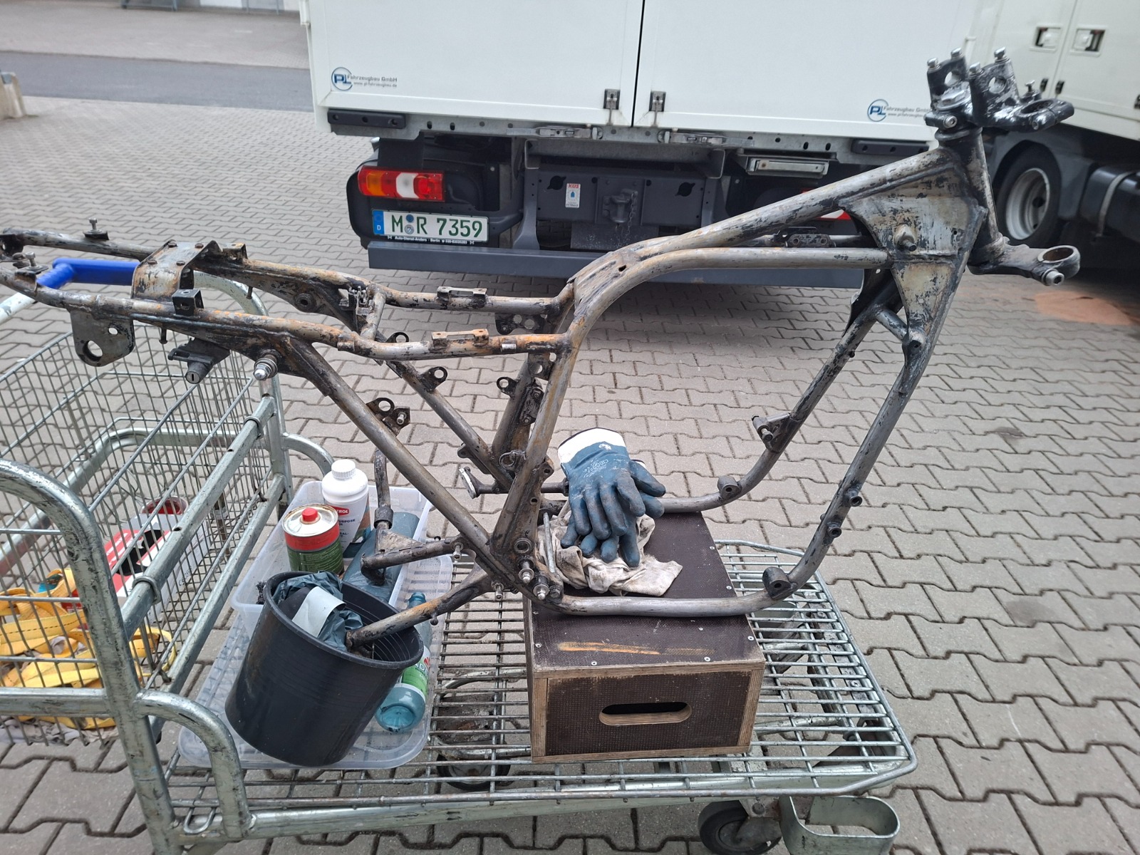

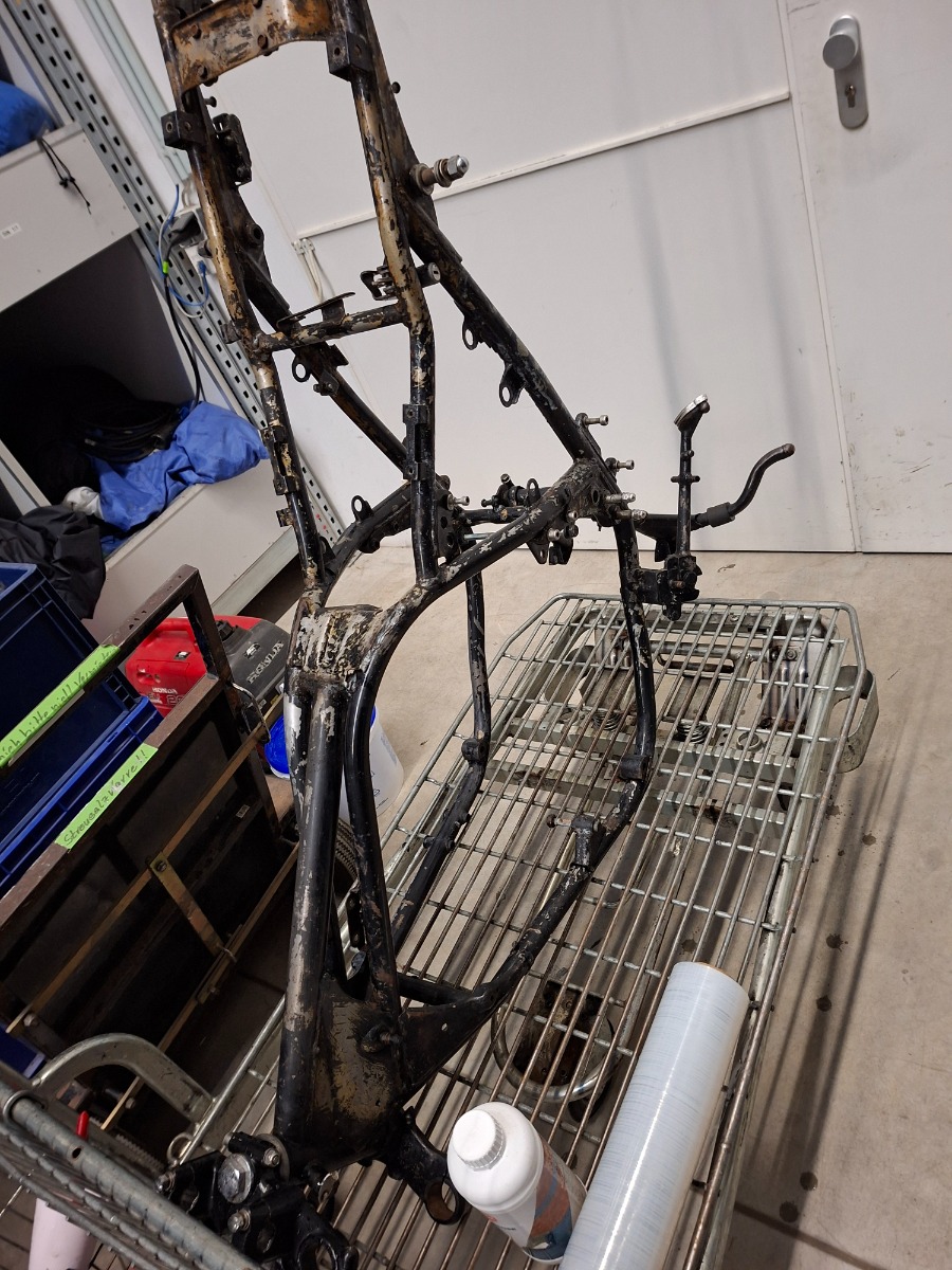

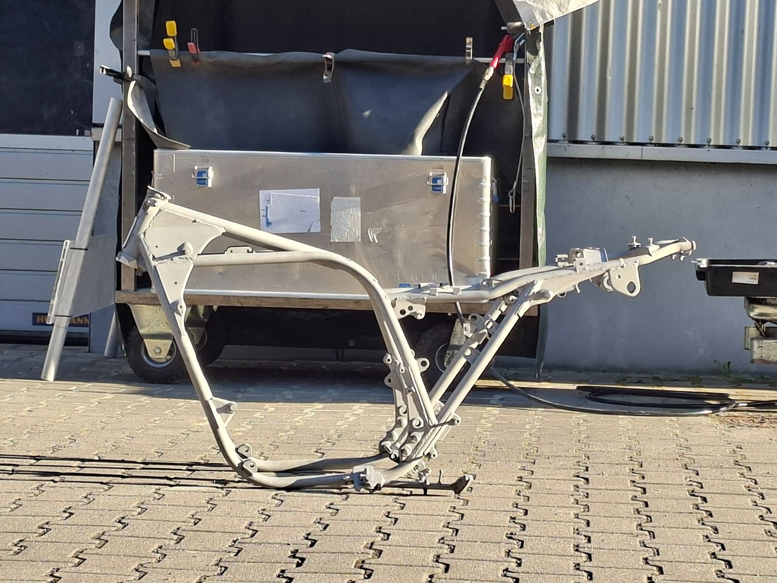

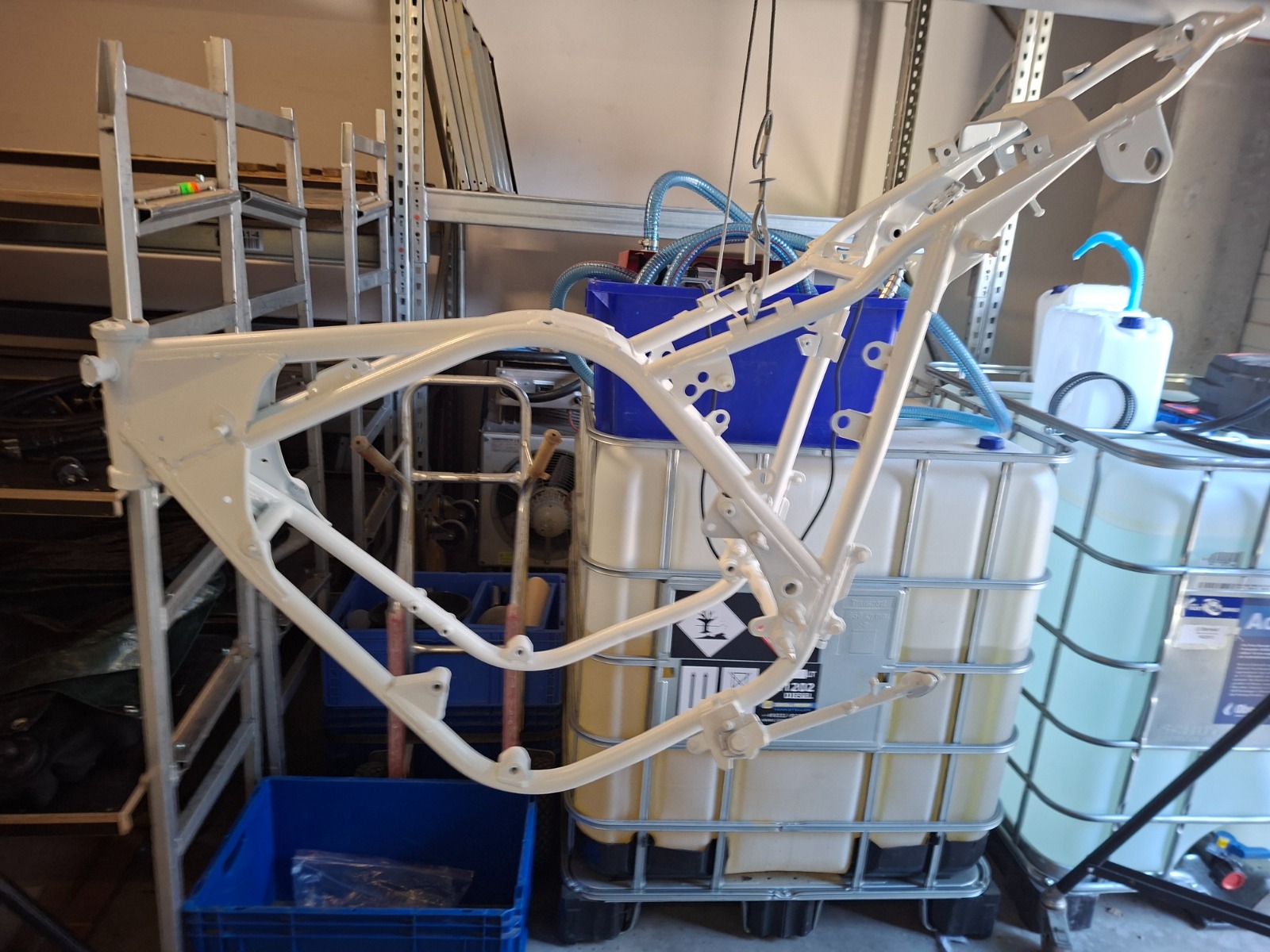

So i have found a new old motor and bought it it apperently only has 16K on it so hopefully its good.

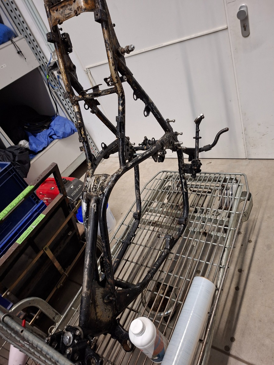

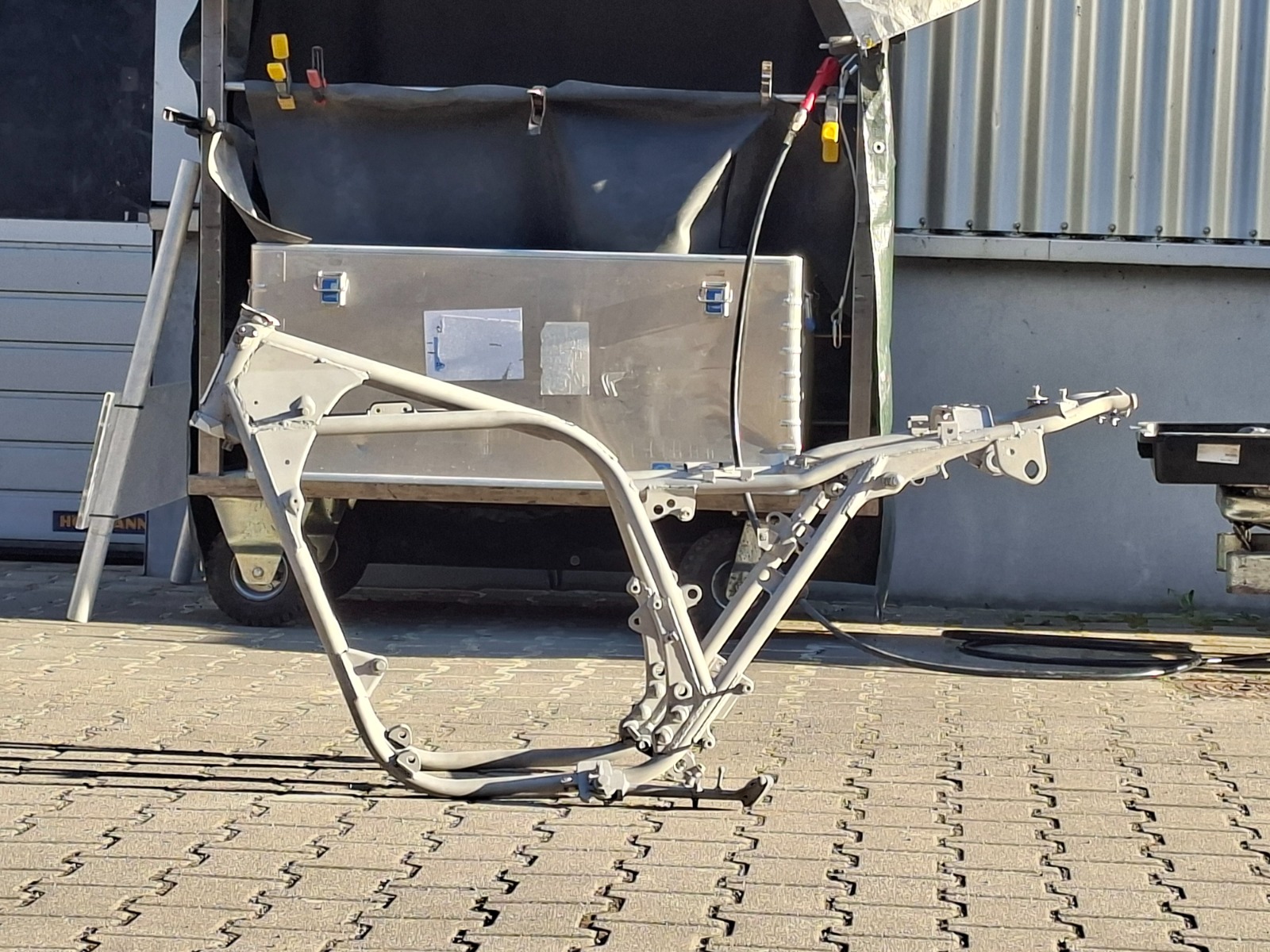

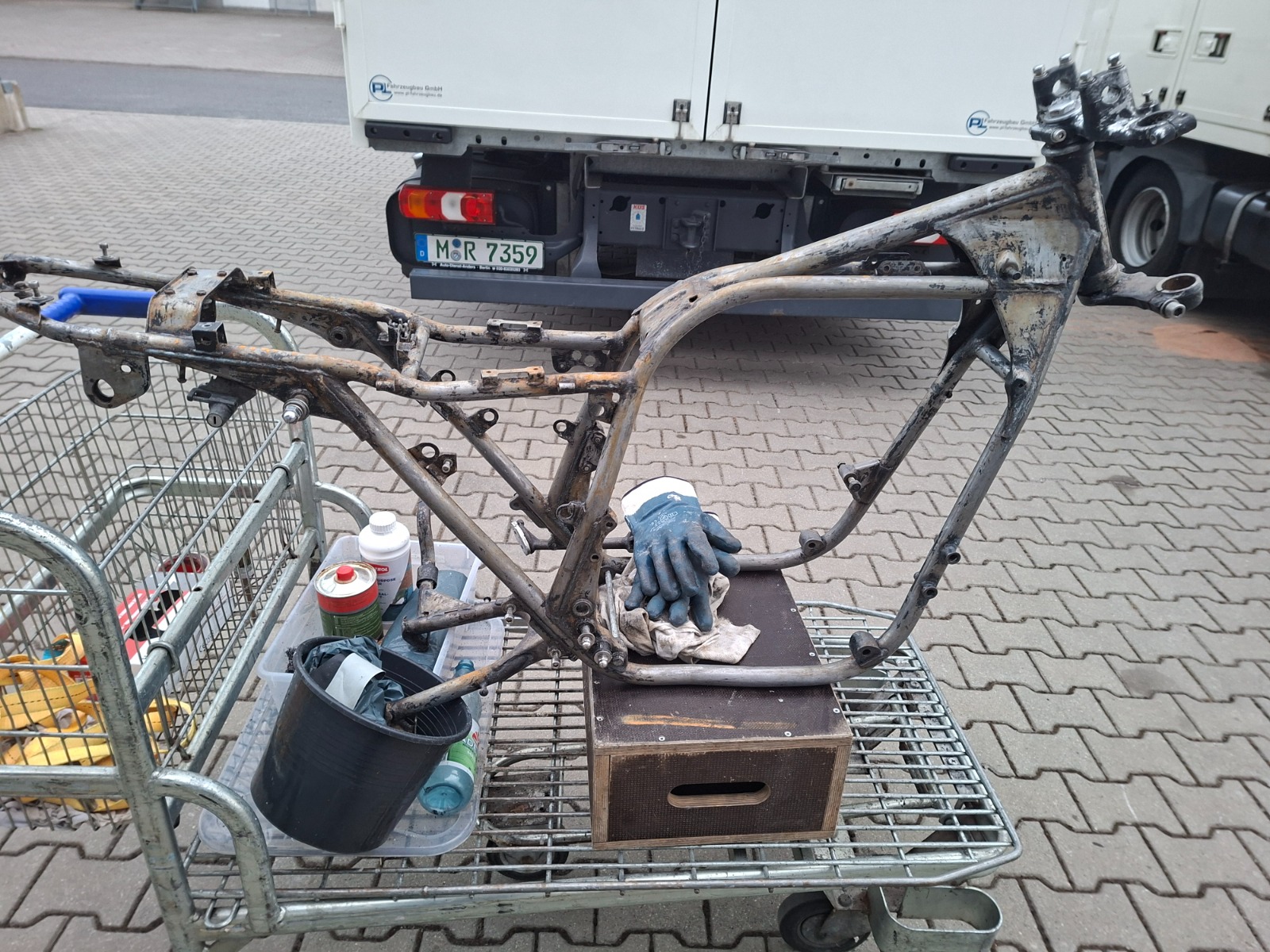

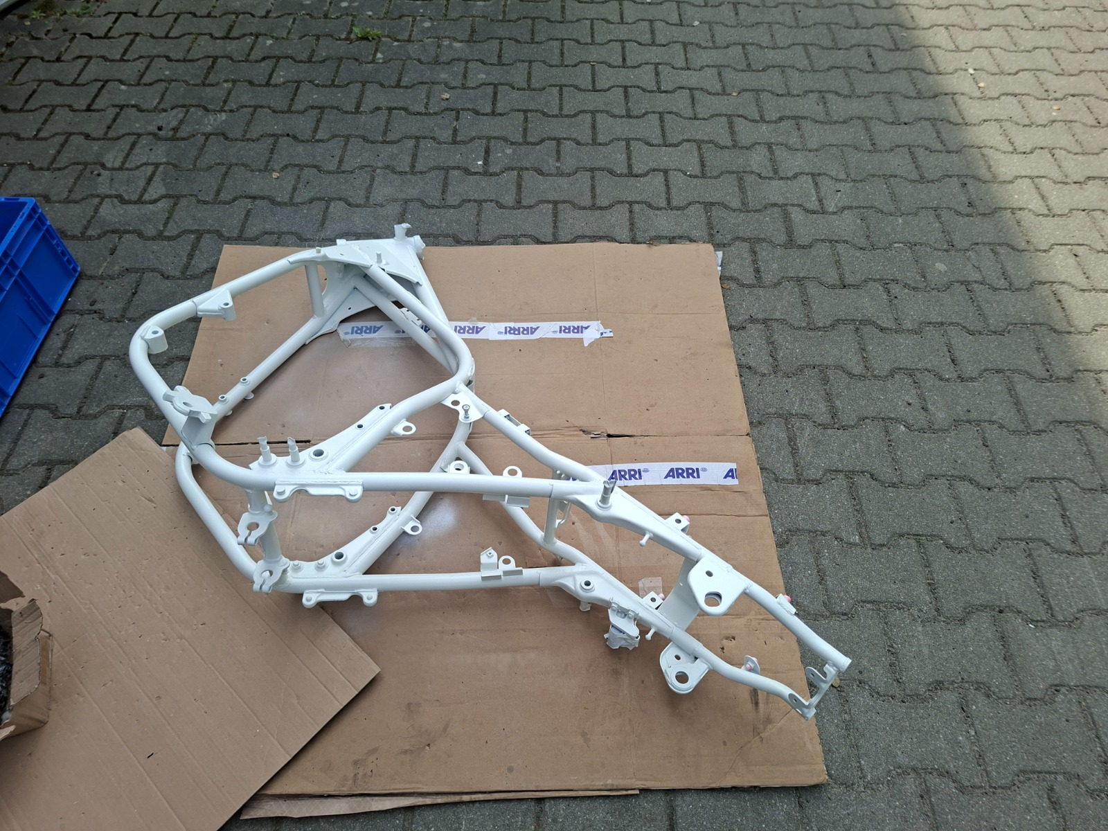

so while i was looking for it i went a bit wild and repainted my frame white.

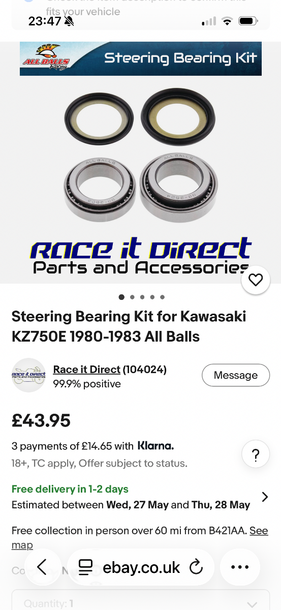

My question is can anyone help me out i want to replace the front fork bearings but I am havin trouble finding a good european supplier for the bearings every place I look they are saying it to old and they dont stock bikes before 1984. I have a 1982 KZ750e .
Has anyone any idea of a supplier for top and bottom bearings for the front fork.
Here are some photos of what I have been up to.
Last edit: 24 May 2026 14:32 by Larry G.

Are you talking about the headstock bearings ?
The following user(s) said Thank You: Larry G
- Larry G
- Posts: 73
- Thanks: 26
Re: Blown motor
24 May 2026 14:54
Yes sorry should have said that. I am still work on the technical words
- Posts: 6884
- Thanks: 4332
Re: Blown motor
24 May 2026 15:48

Thank you as always you are a legend i really appreciate your help. The german suppliers didnt help i will order this from the uk
Best regards Larry
