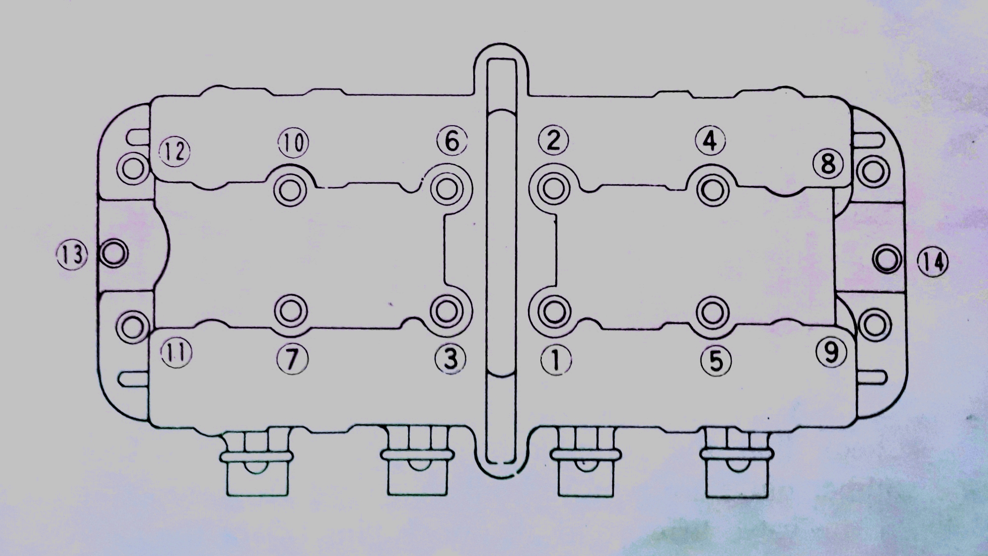

28 Dec 2024 08:18I would retorque for sure. Base gasket can compress, not just the head gasket.

Retorque was needed! Every fastener moved 1/3 to 1/2 turn, including the two M6 bolts.

28 Dec 2024 15:28I had to retorque my MLS head gasket three times.Okay, but I'll take it easy the first mile or two.I'd RIDE THE PISS OUT OF IT
What about re-torque of the cylinder stud nuts...when should that be done, or is it necessary with the MLS head gasket and 38 foot pounds already applied?
Thought of going back through with 40 for the added sense of security. Had 42 on the old motor with Cometic fiber gaskets and o-rings.

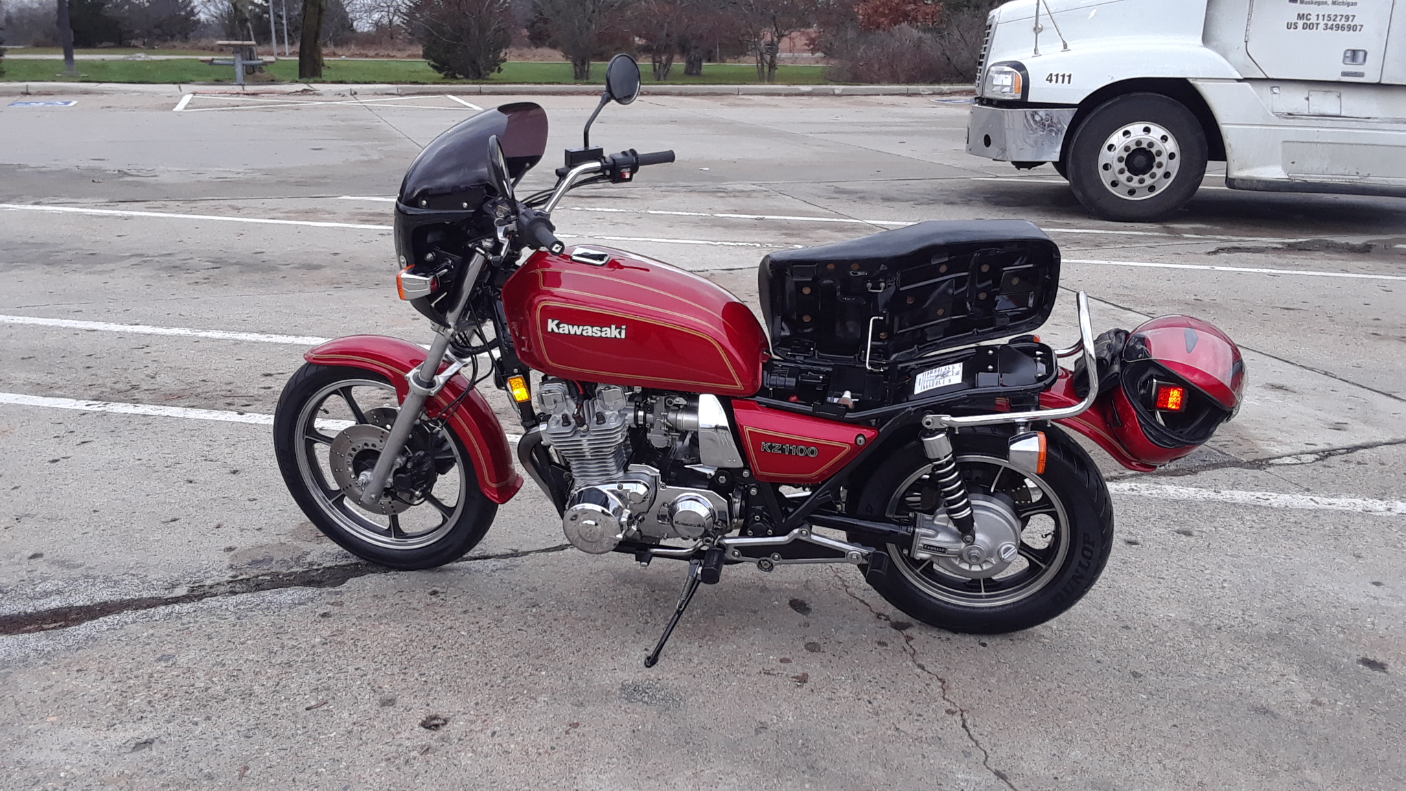

Got an oil bath during the first ride.
Blew a quart everywhere...
Sure glad that I stopped at the rest area to warm myself up, otherwise things would have turned out differently.

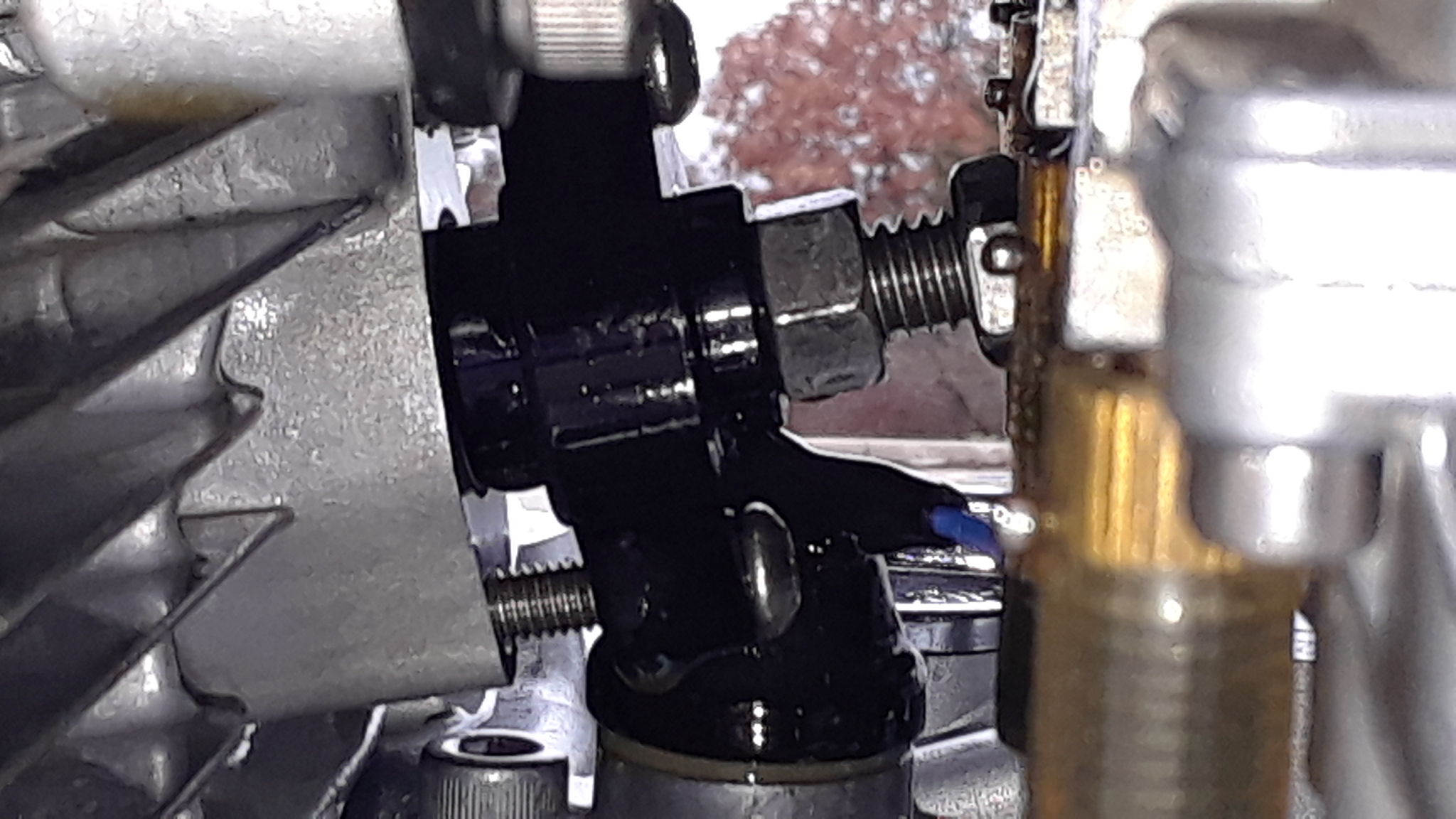

Did the bolts "back themselves out" - not just a leak but a sloppy timing chain too !!!!!!!!!!!!!!!

29 Dec 2024 13:28 - 29 Dec 2024 13:33Yep. Was cruising along about 80 mph before exiting the highway and parking in the big truck zone. Nothing unusual alerted me of the problem, just shiny black boots and wet engine covers staring back at me when I dropped the kickstand. Hmmm, didn't recall hitting any water puddles...GRRR!!!Did the bolts "back themselves out" - not just a leak but a sloppy timing chain too !!!!!!!!!!!!!!!
Didn't take long to figure out what happened, but then I was only a half-hour from home...drenched rear tire and all.
Where would I be without my loving wife who awaits my calls for help, and the guardian angel who saved my engine...and quite likely again, my life!

Re-torqued to 40 ft. lbs.
Half broke loose and moved more...
Will check again after a few hot rides next year.

Wookie was Absolutely Correct!! If i'd noted that the tensioner was backed out that far i would of been super concerned! You just got plum lucky, buy a poor mans tax ticket, aka Lotto Ticket stat.
