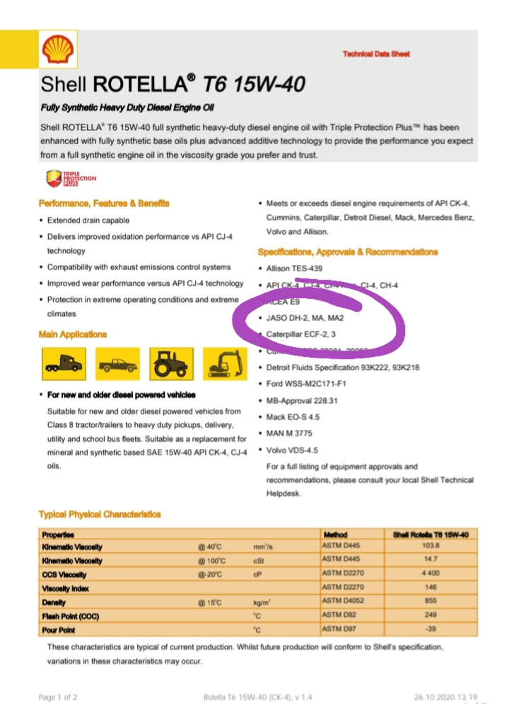

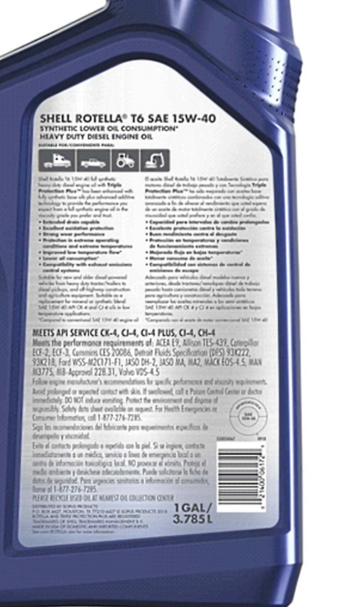

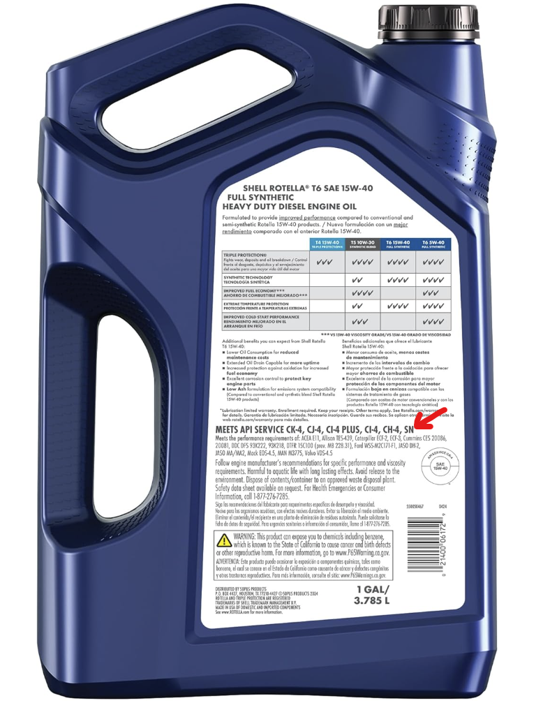

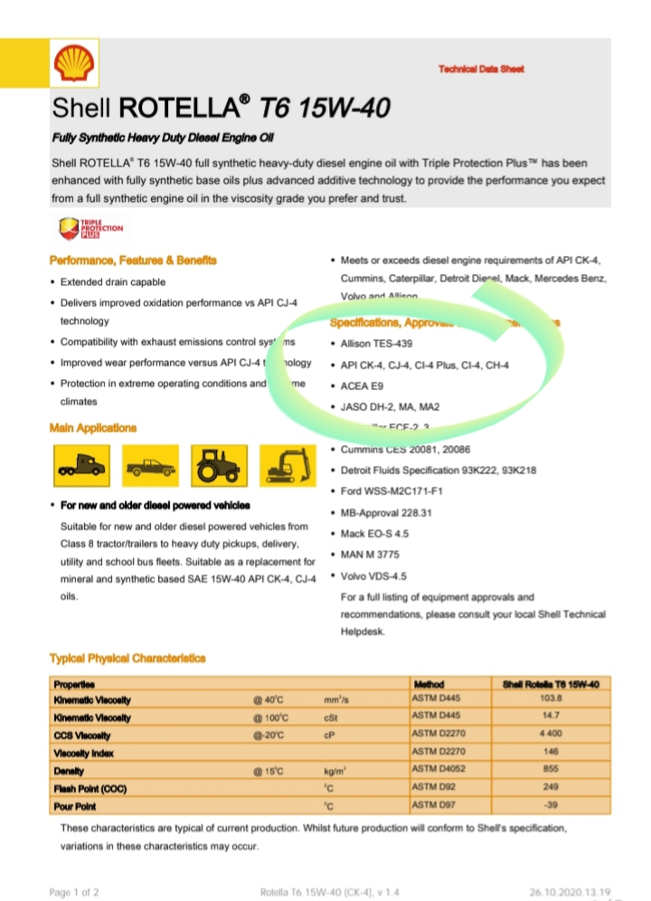

When it comes to most diesel oils, I don't think MA/MA2 is relevant. MA/MA2 is about avoiding wet clutch damage, but that's very unlikely with diesel oils, so I don't worry about it.
Note on the bottle where it says it meets API SN? SN is for gasoline engines, and it mandates a lower ZDDP level than full diesel oils.
I think you would be better off with a diesel oil that is not SN certified. Look for CK-4, and not SN.

Correct, MA/MA2 is a JASO spec, that references wet clutch performance.
Rotella is not actually "certified" to MA/MA2, they claim some flavors they make "meets the specs of...", though.
Other manufacturers of diesel oil don't even bother to make the claim, because motorcycles are a small market, and they can't be bothered.
One other thing about Rotella, they either change the formulations often, or they update the verbiage on their bottles often. For example, some bottles of T6 claim MA/MA2, and others don't. Some claim SN compatibility, and others don't. It's hard to know what's going on with their stuff.
