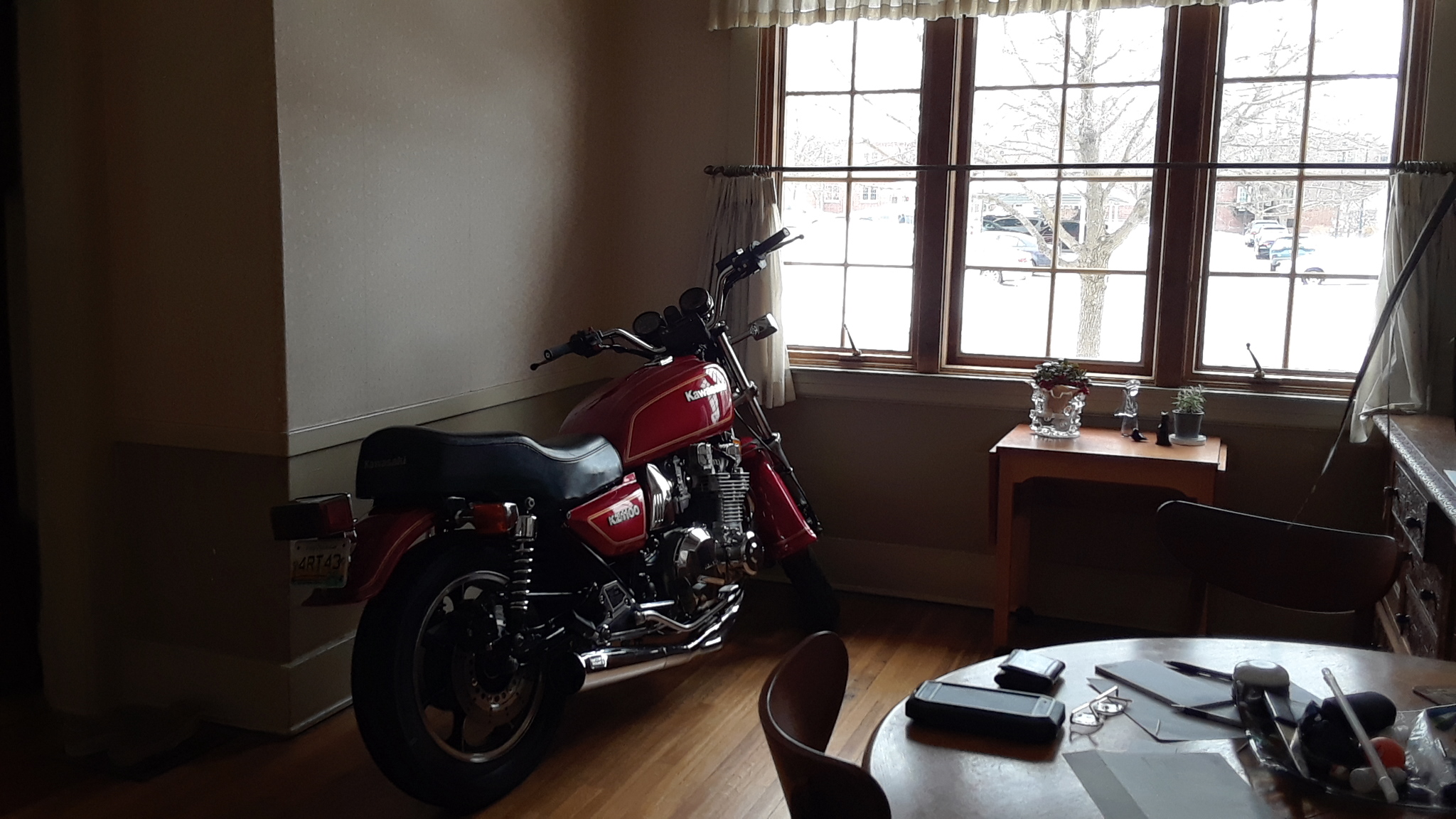

Re: Oil Priming Before Initial Startup
01 Jan 2025 09:20 - 01 Jan 2025 09:26
1982 KZ1100-A2/1170 sleeper 😀
Last edit: 01 Jan 2025 09:26 by daveo.

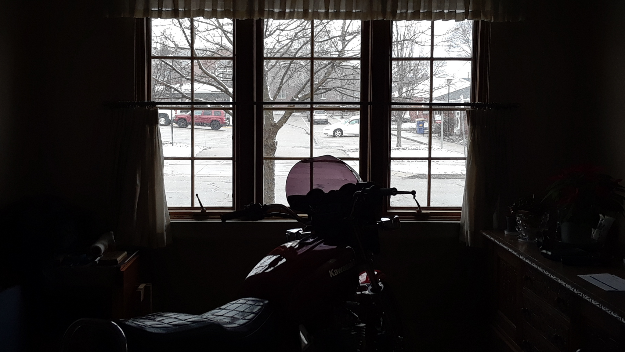

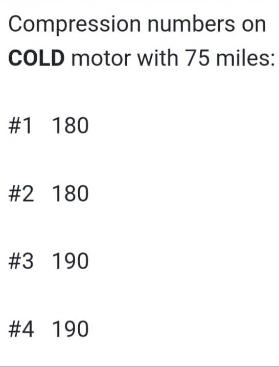

01 Jan 2025 09:21 - 01 Jan 2025 10:23
Last edit: 01 Jan 2025 10:23 by daveo.
