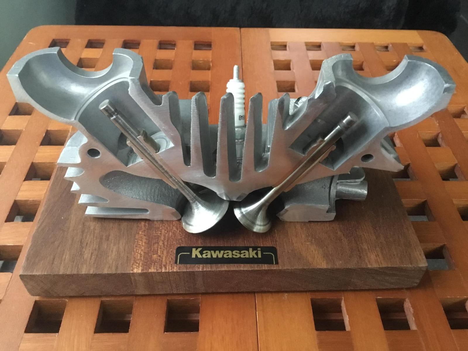

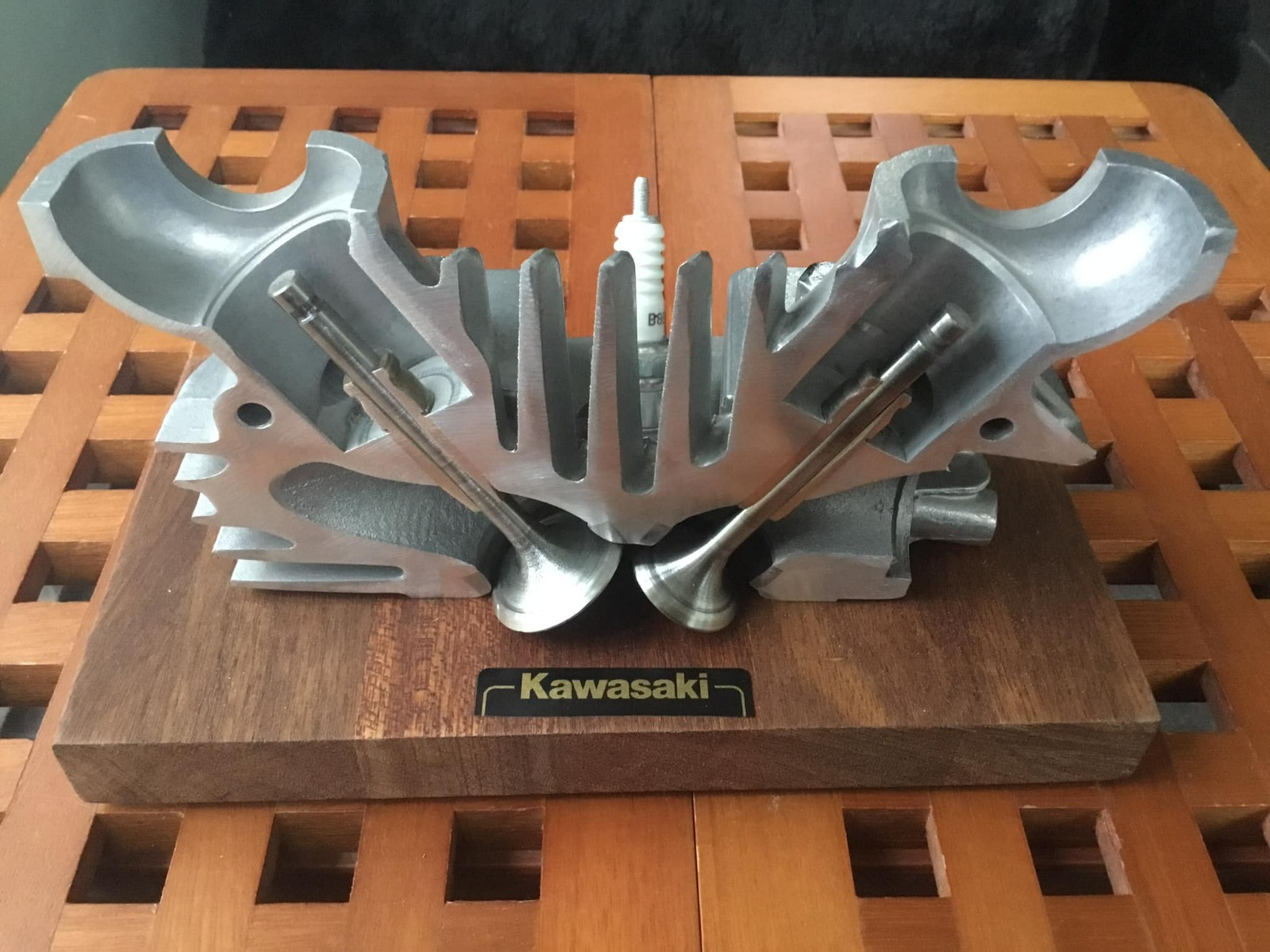

Re: Sad day when the bike you picked up has stripped sparkplug holes(91 zephyr750)
28 Dec 2023 20:33
Larger valves or seats? I know the cast seats are very close to the plug holes. Maybe why the cracks in those areas?
