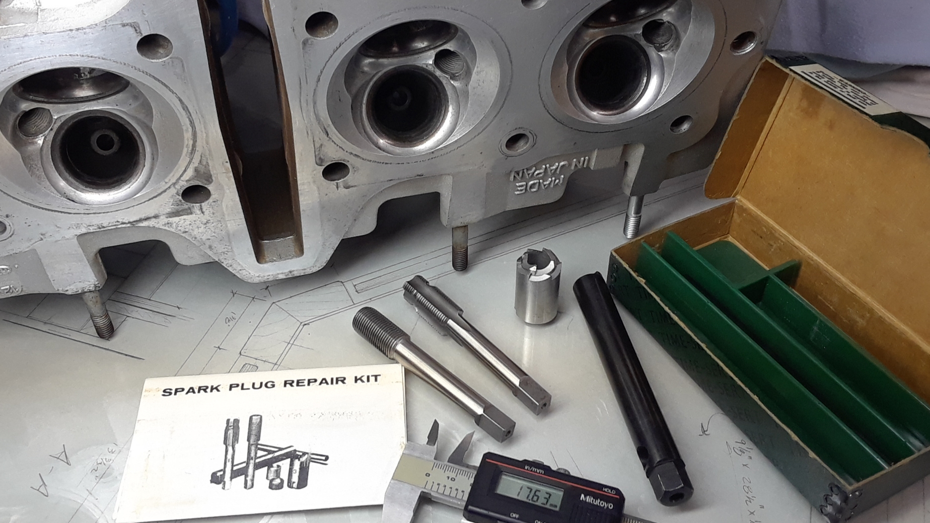

There is no drilling involved, just tapping with the Time Sert tooling provided.
Definantly want the valves closed in the cylinder you are working on.
You got to keep the valves and piston completely out of the line of fire!

Yep have to measure first how deep the tap need to go so not hitting the valve.

Spark plug threads are repairable in place. Not the best choice for a bike that you want to lovingly maintain, but doable on a beater.
Grease the tap, to catch as many chips as possible. You can also attach a hose on a shop vac, to chase any chips that fall off. And besides, a few aluminum chips shouldn't hurt the engine anyway.
For such a bike, I wouldn't spend the money on an expensive Timesert kit. Amazon sells cheap china solid insert kits for $20. No sense throwing good money away on a bike you are going to run into the ground...

Just tested if it is possible to have the exhaust valve open and if it is not 100% open it should work to use a vacumcleaner in the exhaustport.If you use compressed air when finished in the plughole combined with the vacum in exhaust it should work 99%.
