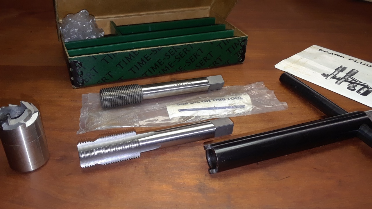

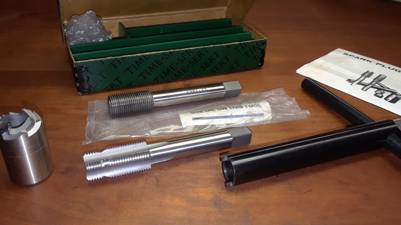

Obviously it's easier with the cylinder head removed, but very achieveable with it on. Just gotta be determined and know what the entire process involves before doing anything.
Gird up ye loins, men!
Must-have proper tooling for the job, or I would not attempt it...
I chose the M14 size 44111 insert for it's 16.8mm length, being the longest available for 3/4" spark plug thread reach.
