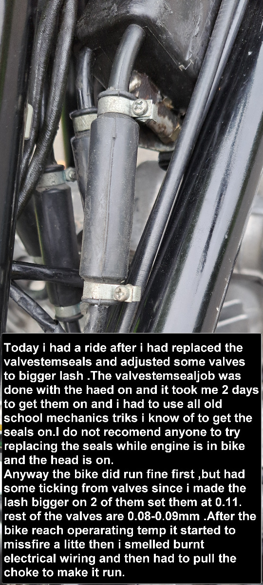

Today i was on the testride and notised that it got some valve ticking ,but that is just because of the bigger lash i hope

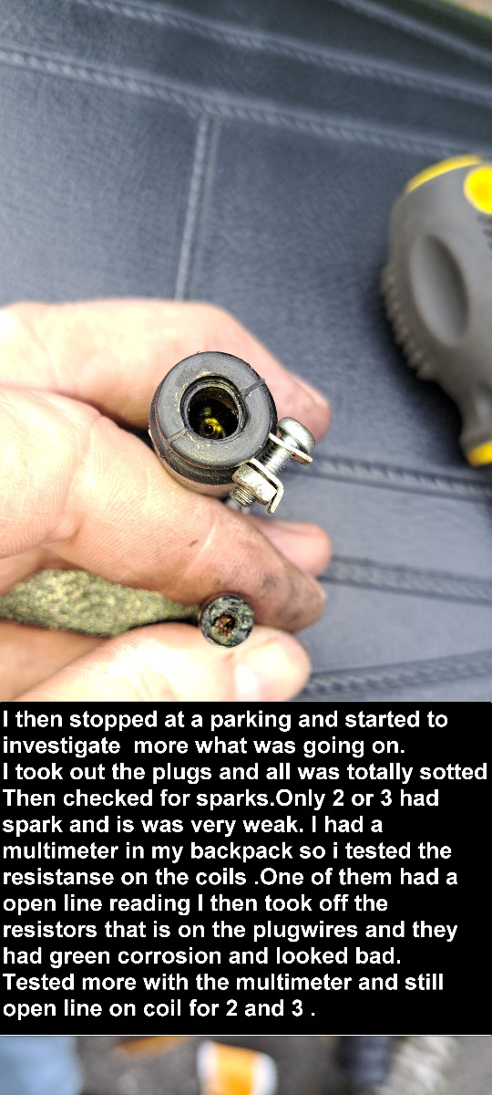

. It ran great for 15 minutes then there was some misfiring
not backfiring .I then smelled burnt electrical wiring like i did about 2 weeks ago when the timingchain had jumped one tooth off
It got worce and i had to pull the choke to keep it running. Stopped at a parking and pulled the the gastank to investigate more...

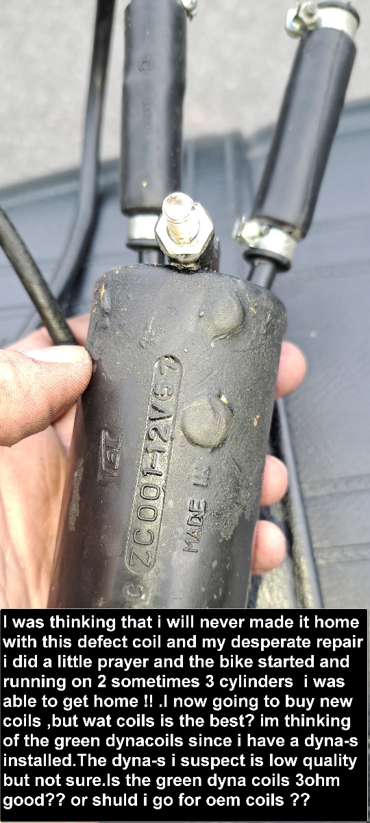

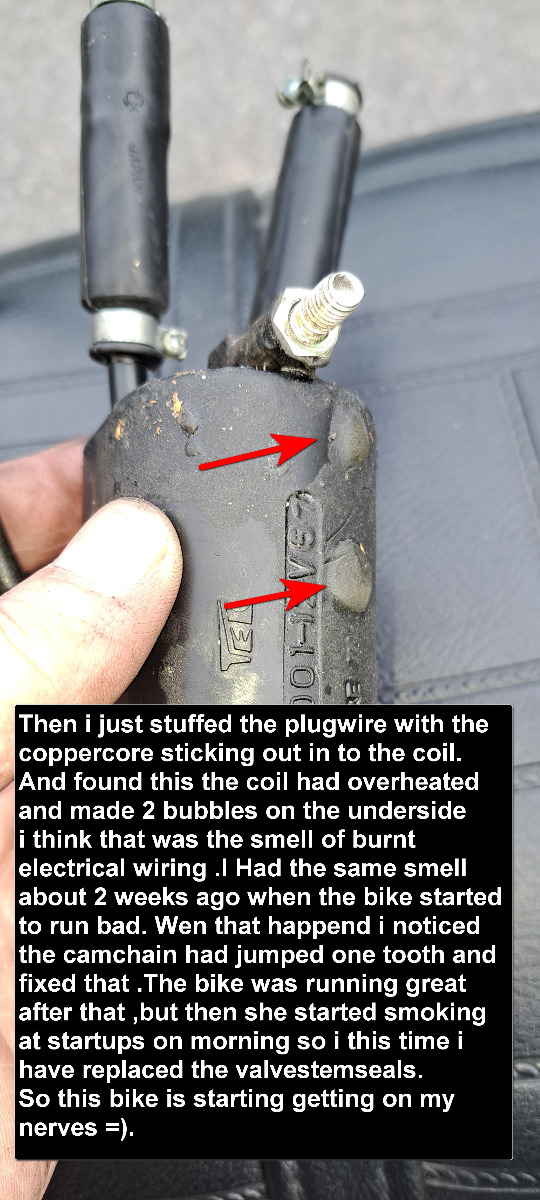

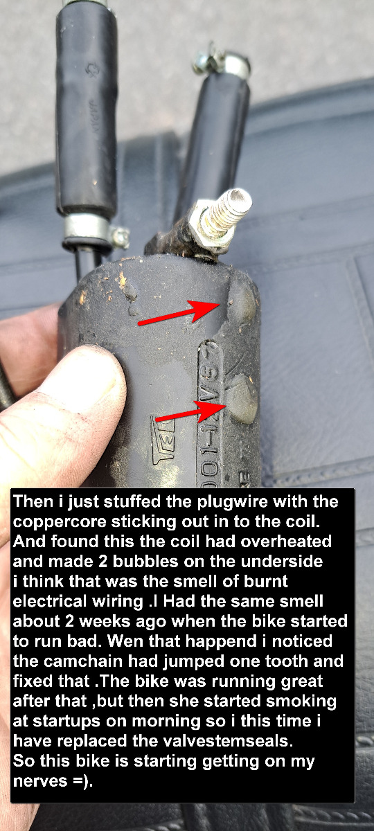

Okay i think i will go for the green dyna coils ,but not sure i can find them here in Norway. How can i be sure that the green dyna is original and not some replica shit? I think the dyna s sitting on the bike now is some replica stuff.Maybe that is why the coil melted ? I have read in some treads here that its important that the ignition not stays on for more than 5 minutes when engine is off so i was careful that i did not do that mistake when checked the timing earlier. But wondering why the coil melted when riding?

5 mins is quite a long time for an old coil - to be fair depending on it's age it may have simply reached the end of it's life

10 Sep 2023 06:275 mins is quite a long time for an old coil - to be fair depending on it's age it may have simply reached the end of it's life
Yes i read that . When i was testing the ignition i just switched it on for maby 2 minutes max at time. Can this coilmelt have something to do with i replaced the 5 ohm plugcaps with 1 ohm caps ??

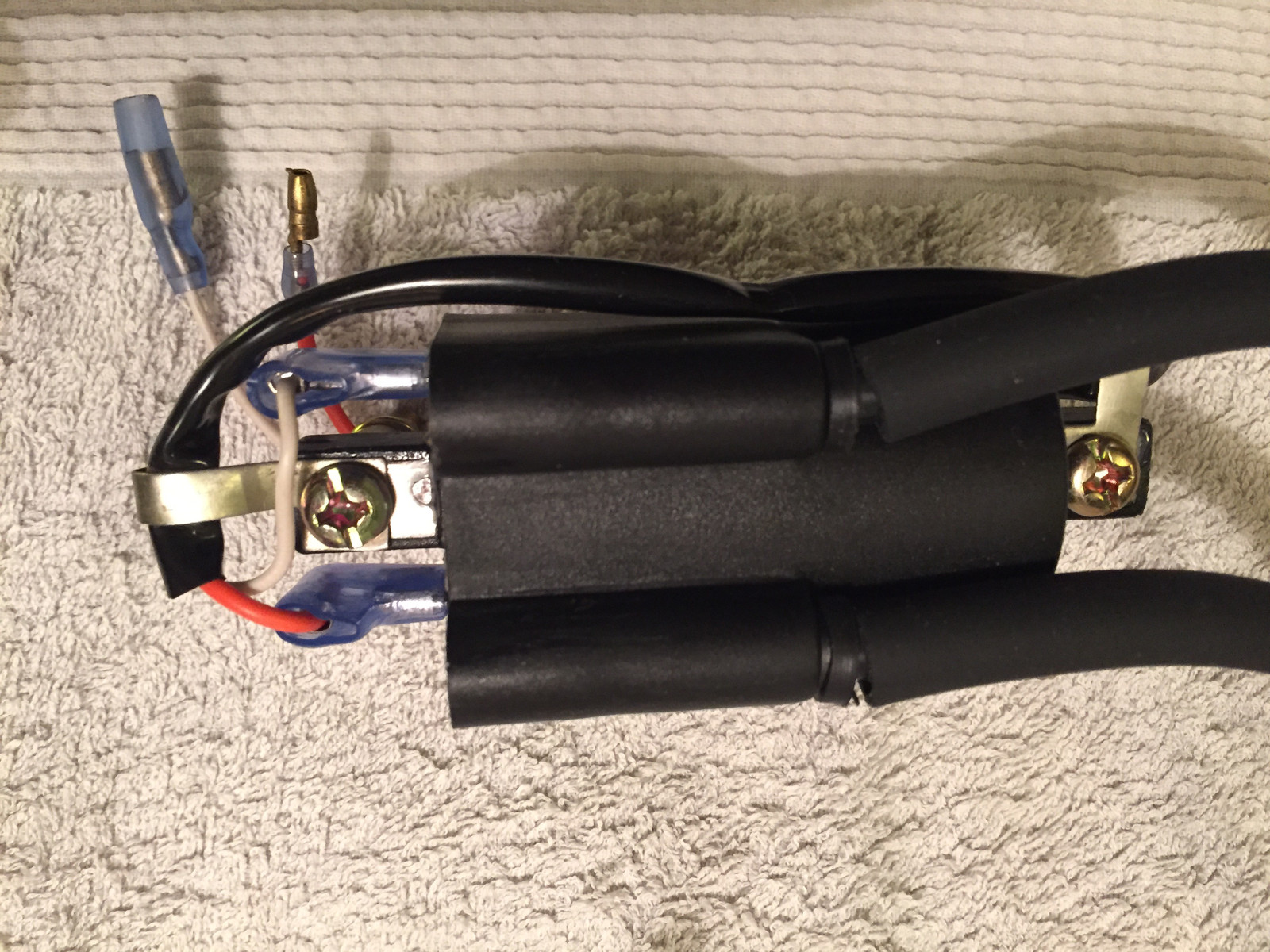

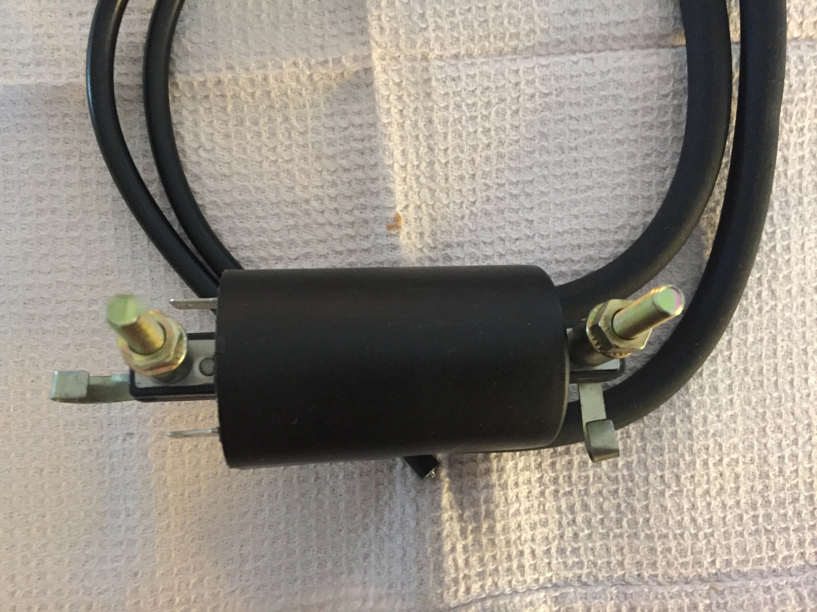

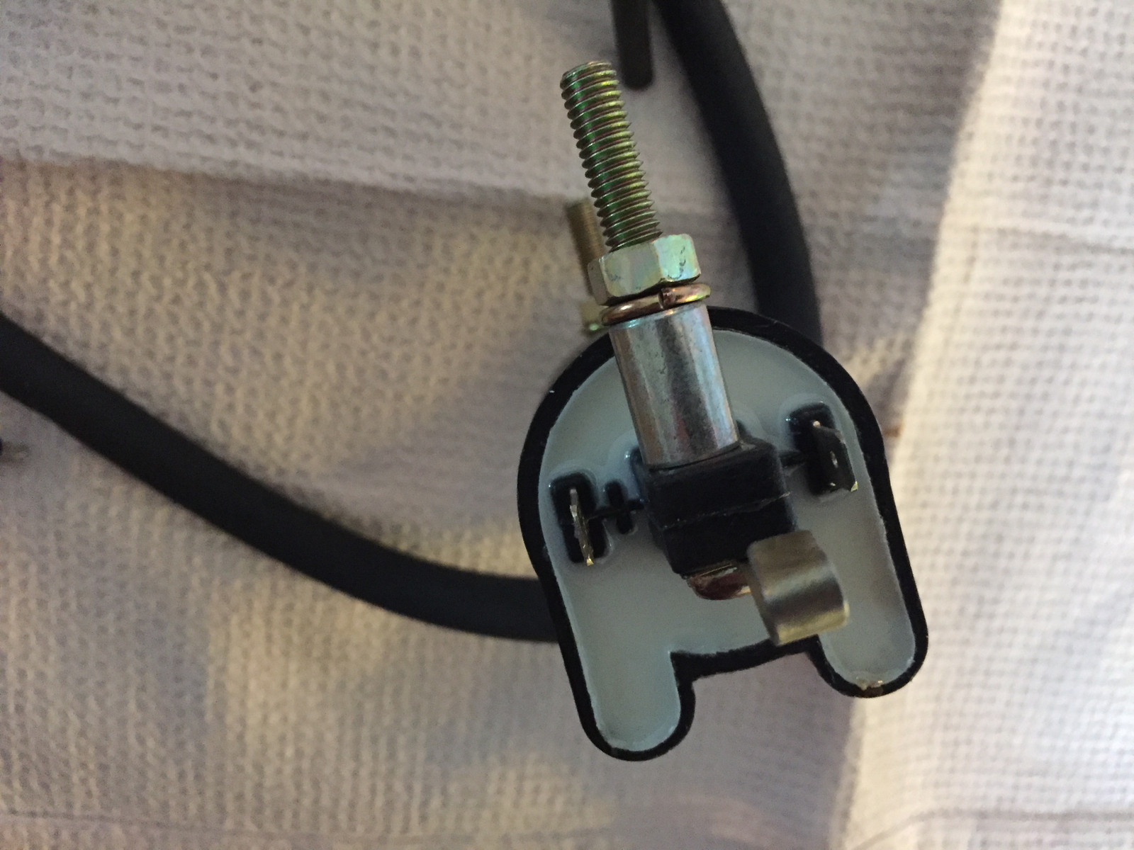

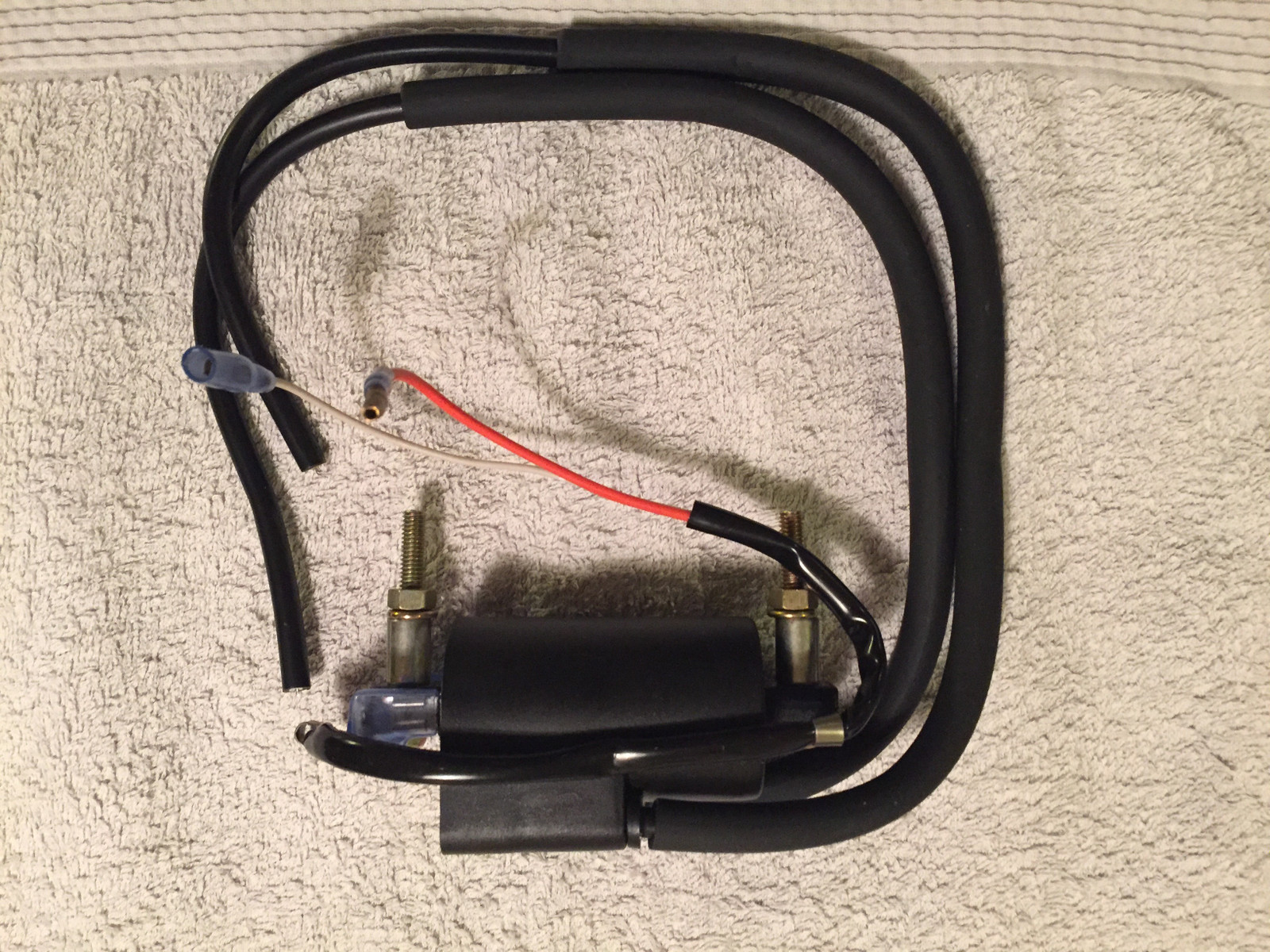

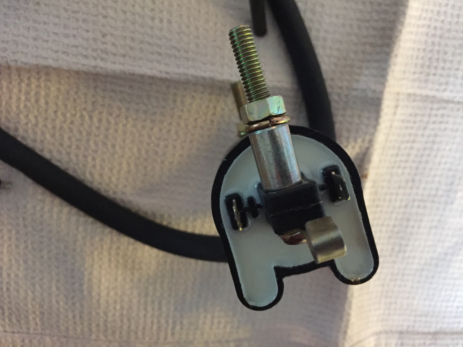

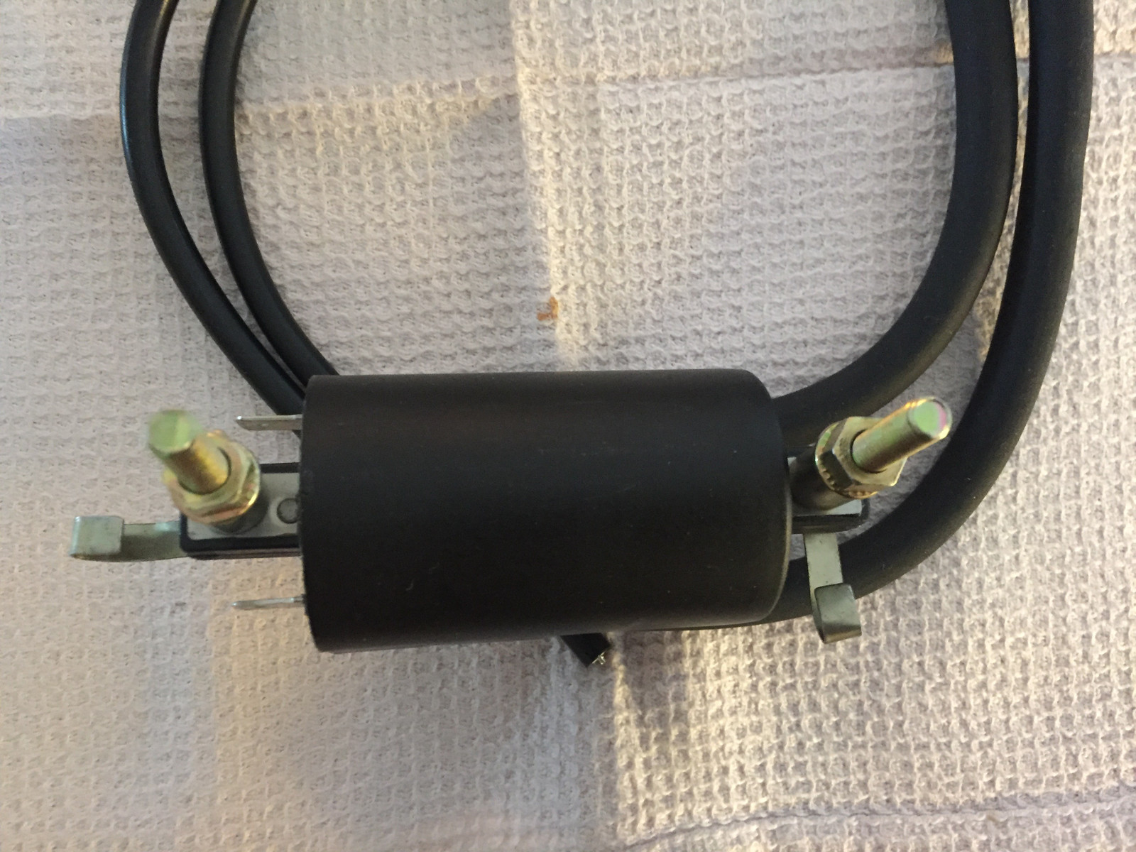

Thanks for the link Hardrockminer ! only thing is i need them superfast because i want to ride the bike more before winter . I found some coils advertised here local 15 minutes from me
they are supposed to work on many older bikes,but i dont know what the resistant values are i will ask the seller. They have 90mm c/c so i think they fit the kz900.
They have no markings and seller wants 160 usd for them .I dont know if i will buy them here are some pics of the coils

10 Sep 2023 11:21Changing the plug caps (secondary resistance) will only effect the strength of the spark not the coil itself5 mins is quite a long time for an old coil - to be fair depending on it's age it may have simply reached the end of it's life

I have found some selling green dynacoils in uk and also germany, but looking at some picktures they differ in color some are green matte som are green glossy so i may end up with some bad chinese stuff. Anyway the seller that i may buy the coils from i was my neighbor when i was a kid and he had a kz1000a1 and later a z1R 1000 he has very long experience with kawasaki bikes .He did not know the resistance he just say they will work.

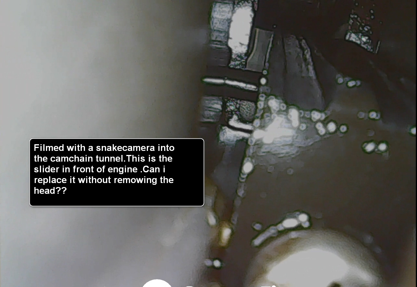

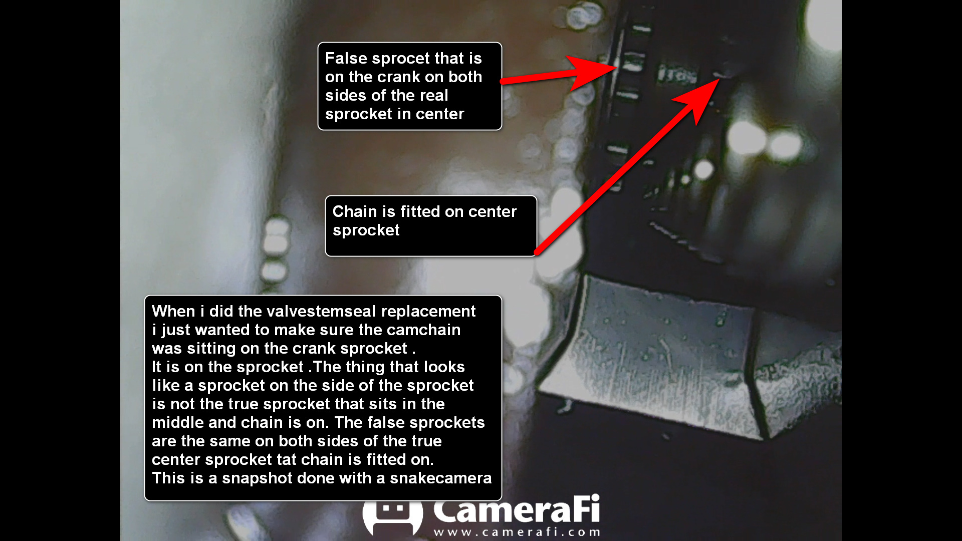

After thinking about this i starting to wonder if there is a problem with the chain and sliders beeing worn out ,and that the chain jumps even if the tensioner is set . Last time the bike started to run bad i checked the camchain it had jumped a tooth and on the little trip i did then i cold smell burnt electrical wiring.I then found the chain was one tooth out on timing.
This time (yesterday) when i had finished replacing the valvestemseals i did the testride and it ran fine to begin with ,but i then felt a little hickup or thump from engine right before it started to misfire and run very bad and also smelled burnt electrikal this time.I dont know if it is possible to feel the camchain jumping ,but i think that is what has happened again

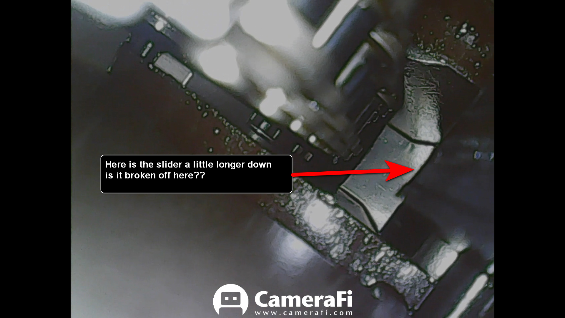

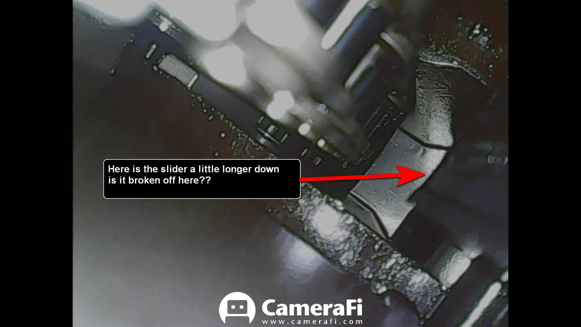

Is it possible that the coils get fried when timing is one tooth out? .I took some snapshot of the camchainslider and stuff with a snakcamera .Tell me if the slider is broken off in the bottom end .I can see it is totally worn out and i will have to replace probably the rollers to this winter. Here are some pick i took
.Is it possible that the coils get fried when timing is one tooth out? .I took some snapshot of the camchainslider and stuff with a snakcamera .Tell me if the slider is broken off in the bottom end .I can see it is totally worn out and i will have to replace probably the rollers to this winter. Here are some pick i took
Last edit: 10 Sep 2023 12:37 by Rolf1976_KZ900. Reason: text

The front chain guide is worn but still intact and can only be replaced by removing the head and barrels.
Dyna coils can be matt or glossy .
The genuine ones have "DYNA" moulded into the body.
Copies are just plain blank in the same area and there are no copies with the DYNA logo..
Cam timing cannot affect the coils..
