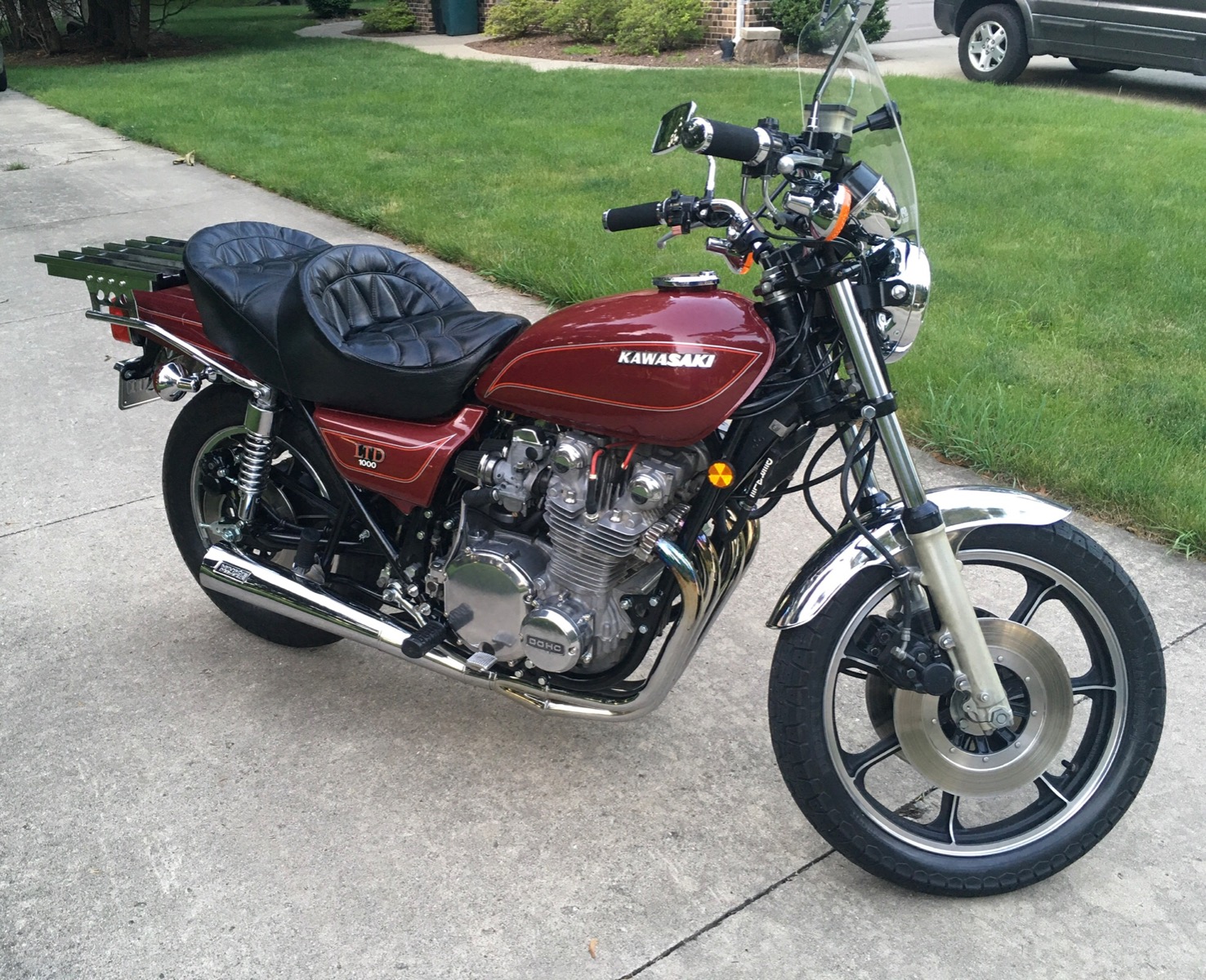

I've got a GPz oil cooler on my 750. It's pretty small, so it doesn't block the tach cable, nor overcool the oil, but it's good peace of mind.
P1020789
