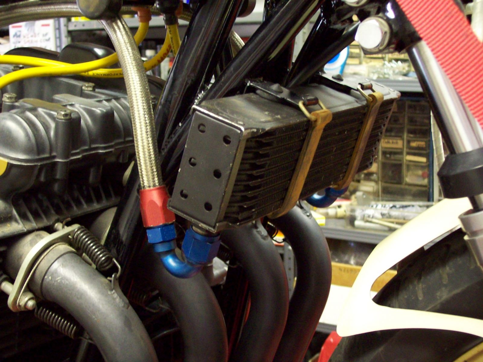

I was planning on using a thermal bypass on mine but rode the bike through the winter without one. I have a gauge on the cooler and it showed the temperature was at optimal level after a few minutes of riding. By other standards the winters are mild but the summers are HOT. Glad I had it then.
Been running mine 5-6 years with no problems.

26 Apr 2023 08:57What are the winter temperatures like in your part of the world Steve - I guess your oil temp is running around 90 - 100 degrees CI was planning on using a thermal bypass on mine but rode the bike through the winter without one. I have a gauge on the cooler and it showed the temperature was at optimal level after a few minutes of riding. By other standards the winters are mild but the summers are HOT. Glad I had it then. Been running mine 5-6 years with no problems.

26 Apr 2023 11:51What are the winter temperatures like in your part of the world Steve - I guess your oil temp is running around 90 - 100 degrees CI was planning on using a thermal bypass on mine but rode the bike through the winter without one. I have a gauge on the cooler and it showed the temperature was at optimal level after a few minutes of riding. By other standards the winters are mild but the summers are HOT. Glad I had it then. Been running mine 5-6 years with no problems.
In the winter it can get to 30-49* F. Sometimes lower but I don't get out in it. In the summer it can get to 121* but I ride in the mornings. The oil temp can get over 300* but goes down when moving. I had the sensor on the head and it scared me so I moved it to the cooler.
