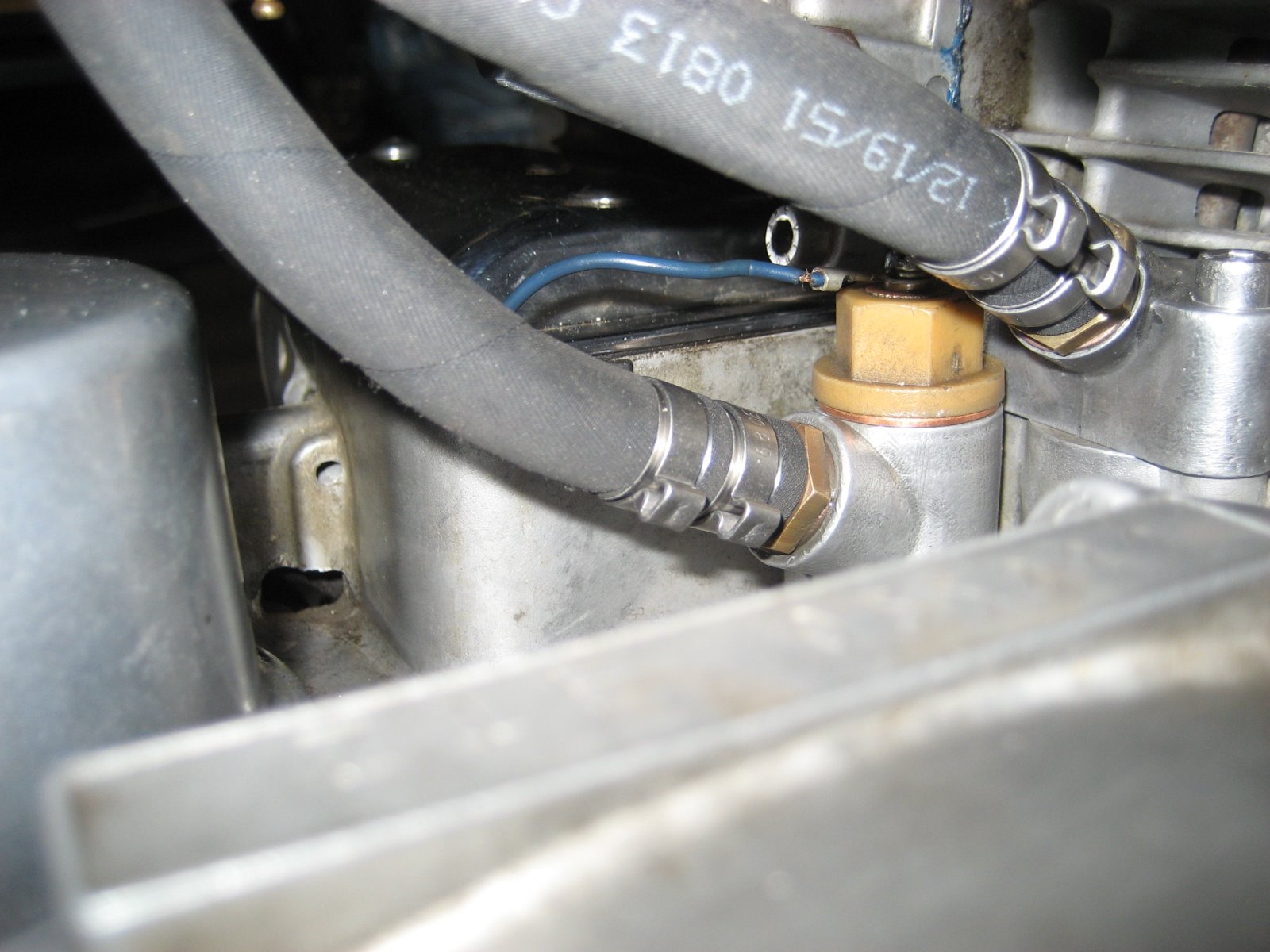

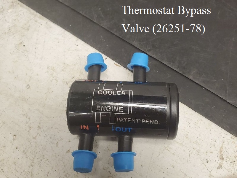

Hello,
to instal an oil cooler thermostat i need to connect the "engine in" of the thermostat to the hose from the oil pump.
(where oil will come to the thermostat) What is the good one please ?
The bottom left one ?

Yes, the bottom left with the switch in it

The line from the switch port is from the oil pump to the cooler, the other line returns oil from the cooler to the cylinder head.

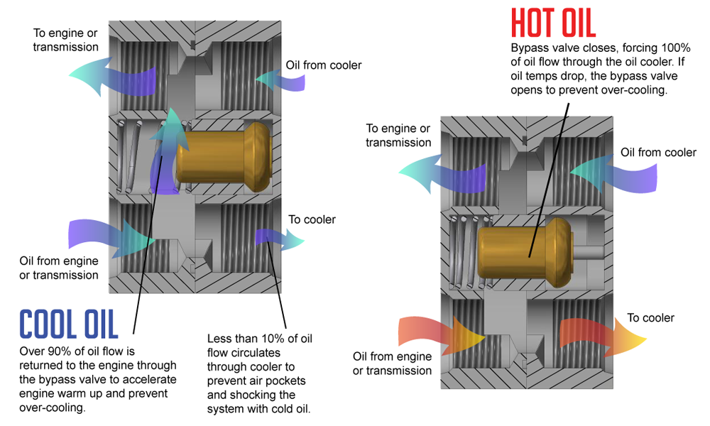

Do you mean thermostat or do you mean temp guage?
If you put a thermostat in the oil feed line surely the head will be starved of oil until the gearbox oil temp reaches high enough for the thermostat to open and allow flow or am I misunderstanding something.?

The oil cooler thermostat valve divided,bypass and resticted the oil flow in two diffrent oil feeding circles like on water cooled engines.
So a oil cooler is a must have or you cut off the oil flow on a hot engine!

25 Apr 2023 15:54 - 25 Apr 2023 16:00The thermostat simply takes the cooler out of the circuit until it is needed, you still get full flow to the head but a small amount is diverted through the cooler to avoid " cold shocking" the system when the thermostat opens (same as a coolant thermostat on a water cooled motor which takes the radiator out of circuit until operating temp is reached)Do you mean thermostat or do you mean temp guage?
