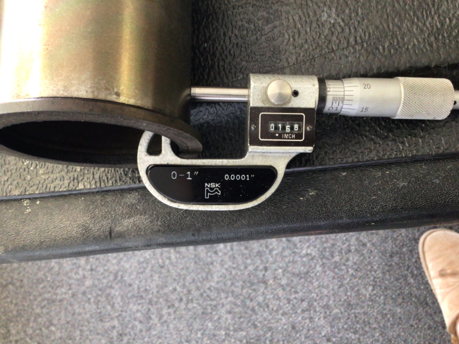

The liners measure right at 8.5mm. EDIT: My bad, that should be 4.26mm, not 8.5
Last edit: 13 Apr 2023 16:09 by motomisfit.

13 Apr 2023 09:35Do you mean cams at 8.5mm lift ?The liners measure right at 8.5mm.

13 Apr 2023 15:44So that makes the liner od 87mm not 78mm ? ( 70mm bore + 8.5mm x 2 )
That would make them capable of 1325cc bigbore which is impossible in a stock block casting.
Surely the measurements are wrong somwhere unless you measured at the liners top hat flange that sits in the barrel recess..

I’m sorry guys. This micrometer I’ve been using is going in the trash. My 0-1” is accurate. I just can’t use it on the bores obviously.
So .168 is about 4.26mm, knowing that this mic isn’t really the right one to use, but close enough for the sake of this conversation. I will edit my previous posts
Last edit: 13 Apr 2023 16:13 by motomisfit.

13 Apr 2023 16:14Ok! So back to 78mm (ish) od on the liners.

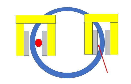

14 Apr 2023 05:20 - 14 Apr 2023 05:28Just a quick tip if you didn't already know, when measuring a curved surface with a micrometer - if your micrometer has flat anvils then you should add a ball bearing to the inside of the curve, then deduct the diameter of the ball bearing from your overall measurement as belowOk! So back to 78mm (ish) od on the liners.

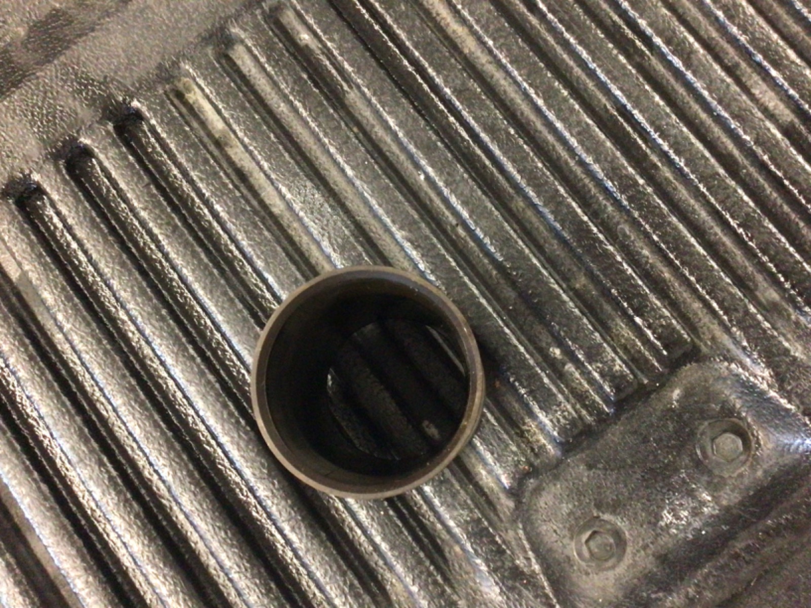

Ok, that micrometer I was using is no longer with us.
I feel like a moron for making you all burn your brains with all my stupid numbers. These ARE indeed 66mm pistons and liners. The outside of the liner measures 74mm fwiw. At least now I know I can just get the stock size base and head gasket. Bike ran fine but I wasn’t able to do a CR test before I took the motor apart but I always figured I’d at least replace the rings while I was in there. It wasn’t burning oil. Hone the liners first for a little cleanup with new rings?
Measuring and doing the math again still tells me I only have about .314 lift on the intake cam. I thought even the factory cam lift was more than that.
