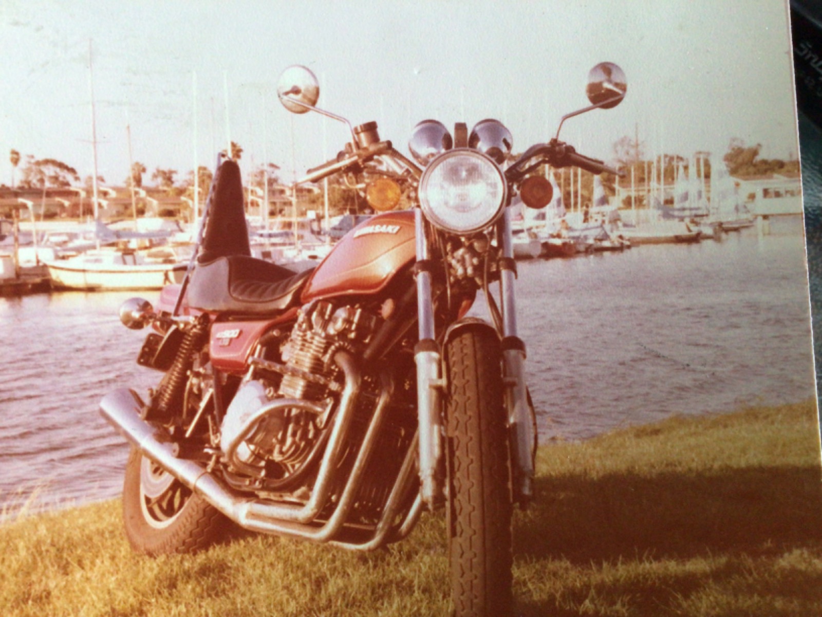

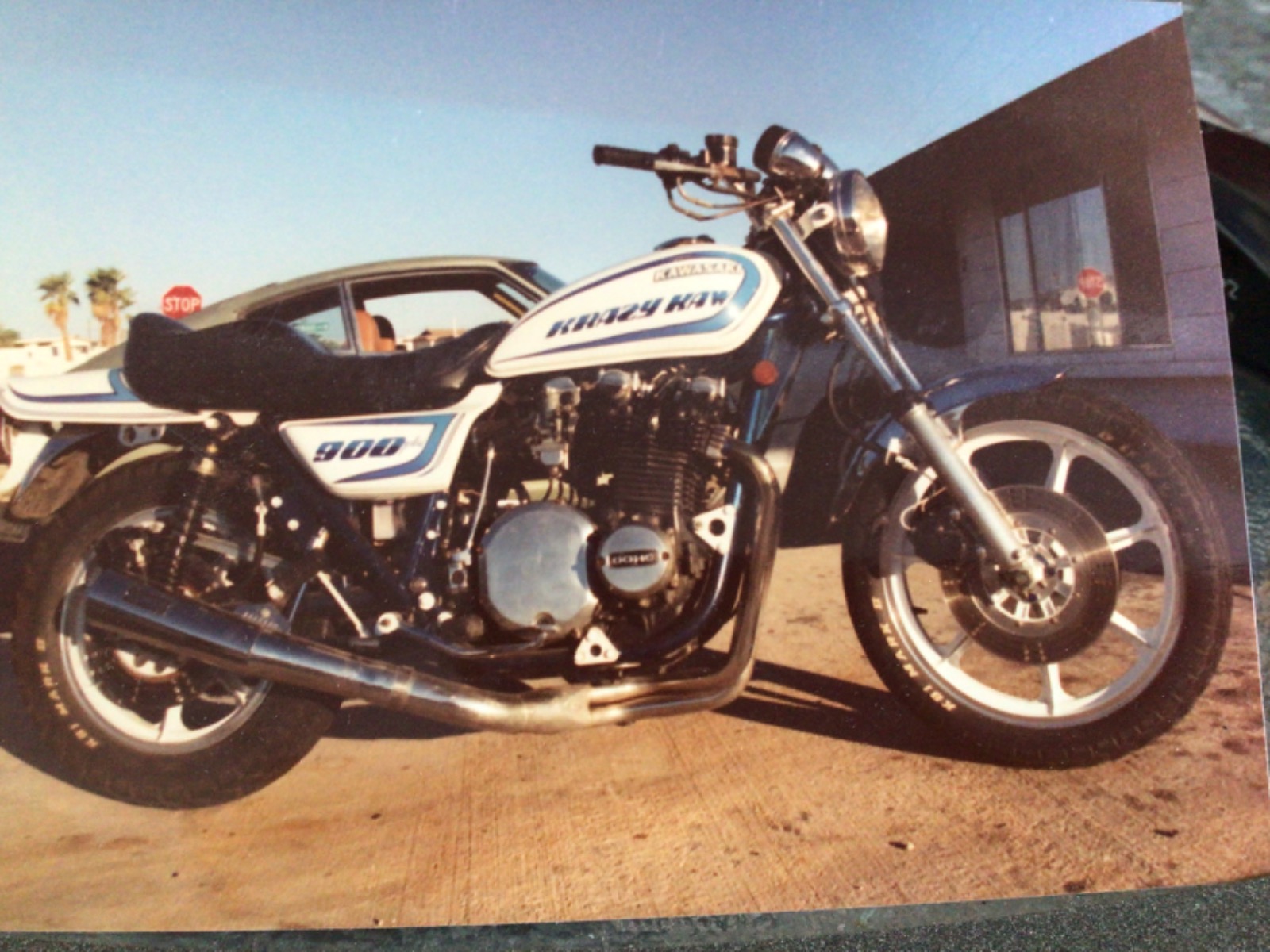

- motomisfit
- Posts: 122
- Thanks: 49
Re: ‘76 KZ900 LTD. Need some advice.
08 Apr 2023 07:29 - 08 Apr 2023 08:11
Last edit: 08 Apr 2023 08:11 by Street Fighter LTD.
The following user(s) said Thank You: Moose1800

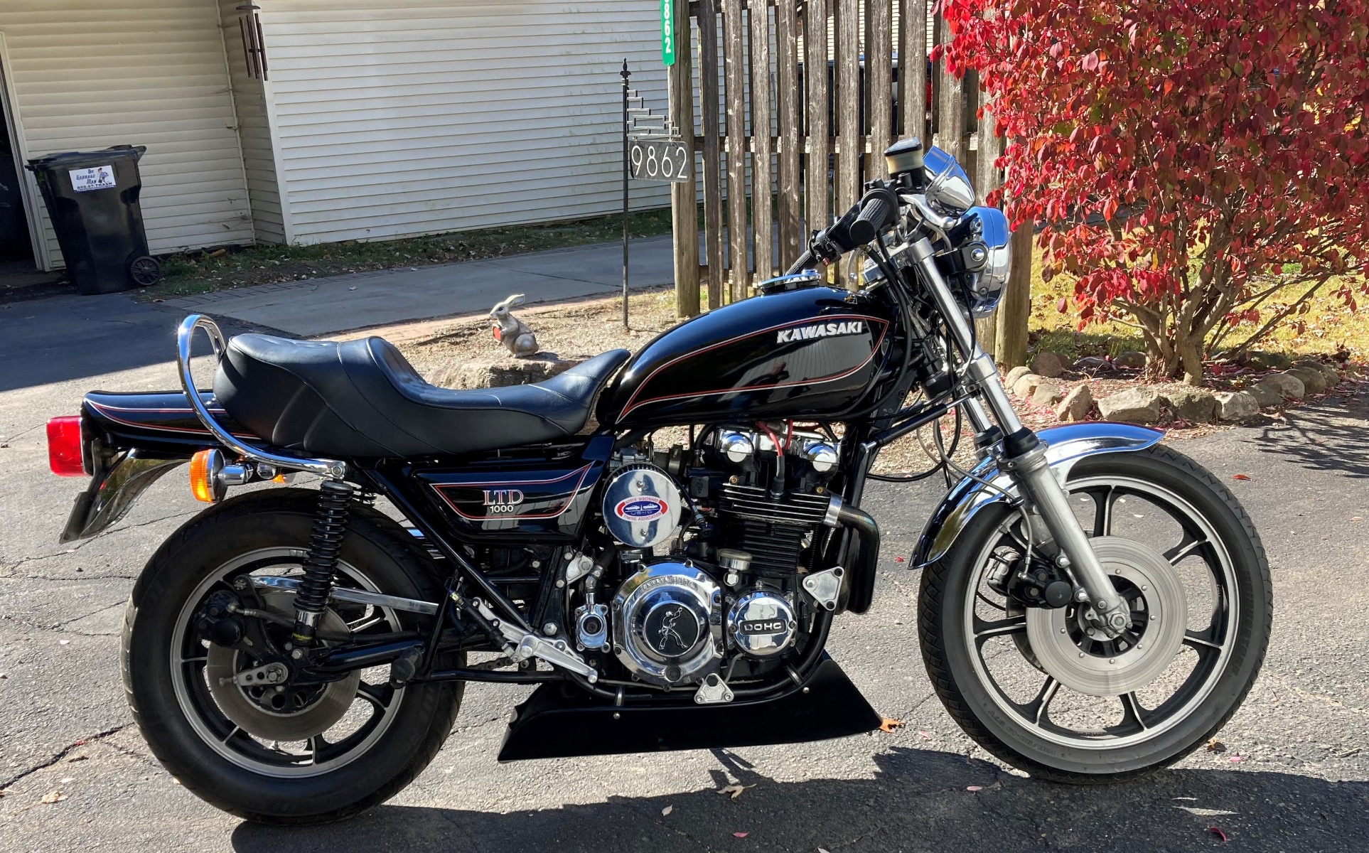

- Posts: 5051
- Thanks: 2255
08 Apr 2023 08:14
Nice picture
Next time click the insert all tab to complete the install and the pictures will be full size
Here is My LTD
Here is My LTD
- Moose1800
- Posts: 299
- Thanks: 284
08 Apr 2023 08:43
motomisfit, thanks for the pic, do you have a recent pic of it?
Dave, your bike is beautiful!!!!!

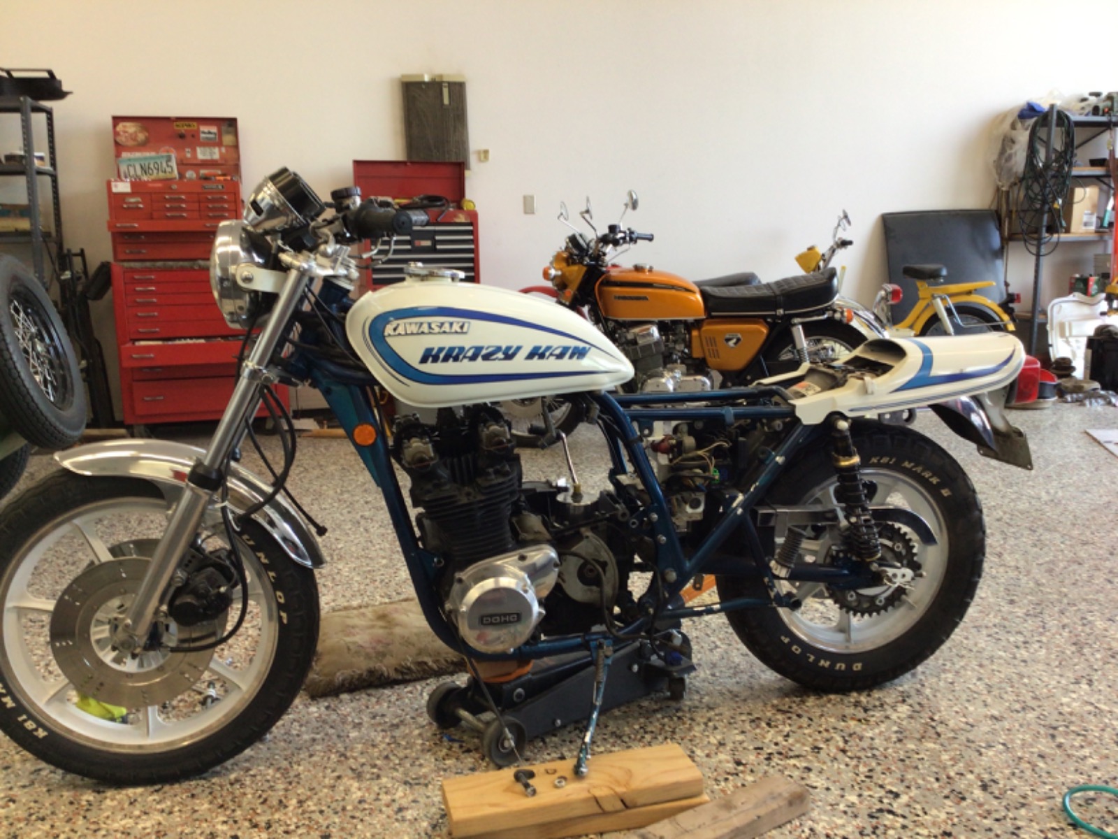

- motomisfit
- Posts: 122
- Thanks: 49
08 Apr 2023 10:02 - 08 Apr 2023 11:09
Last edit: 08 Apr 2023 11:09 by motomisfit.

- motomisfit
- Posts: 122
- Thanks: 49
08 Apr 2023 11:10Please Log in or Create an account to join the conversation.
08 Apr 2023 12:29
Hey, I was a teenager ok?
Little did most of us know back then that keeping our cars/bikes in as close to original condition was actually a good thing. But I made it mine and wouldn’t trade it for anything. It was named after my all time favorite cereal, Crazy Cow.
