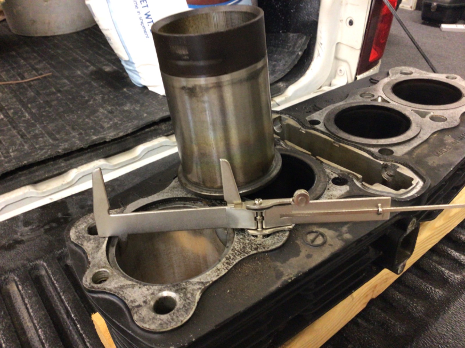

Crud, I’m going to have to get different size head gaskets aren’t I? I measure 71.5mm inside the gaskets that came off the the motor.
Re: ‘76 KZ900 LTD. Need some advice.
13 Apr 2023 06:52 - 13 Apr 2023 06:55
From what I see and other have mentioned, it appears you have stock 1015 pistons and possibly sleeves installed it a 903 cylinder block. You need to measure the OD of the sleeves to determine if they bored out the 903 or installed the 1015. Not sure if this would change your base gasket choice. But you should be able to use 1977-78 Kz1000 base and head gaskets.

As best I can measure, I’m getting 78mm/3.07 inside the cylinder. When the cylinder is cold, like in the morning, the liners won’t slide out. If I put it in the sun, they slide out. Odd
13 Apr 2023 07:55
That won't hurt anything. They are trapped between the head and block. My 903's spun when they were bored out. They ran fine in the bike.
13 Apr 2023 08:00 - 13 Apr 2023 08:01
Unless someone can respond quicker, after work today I’ll big up a stock 903 and 1015 block and measure the sleeves OD. This is a fact finding mission for me as well. Zed1015 said the 1015 sleeves OD is bigger but I don’t know the measurements.
EDIT; from the picture the sleeve wall looks thick. You might have 1015 sleeves.

Those liners are not stock 903 or 1015 either so the block has been bored out to fit aftermarket ones.
Possibly LA Liners.
1015 liners are 76mm at their widest so with these being 78 are suitable for up to 1200cc max - 76mm bore.
As for the liner fit -
If they don't move when cold you are ok..

The 903 spigots are smaller needing a o ring and the top flange is smaller than on the 1015 sleeves.
