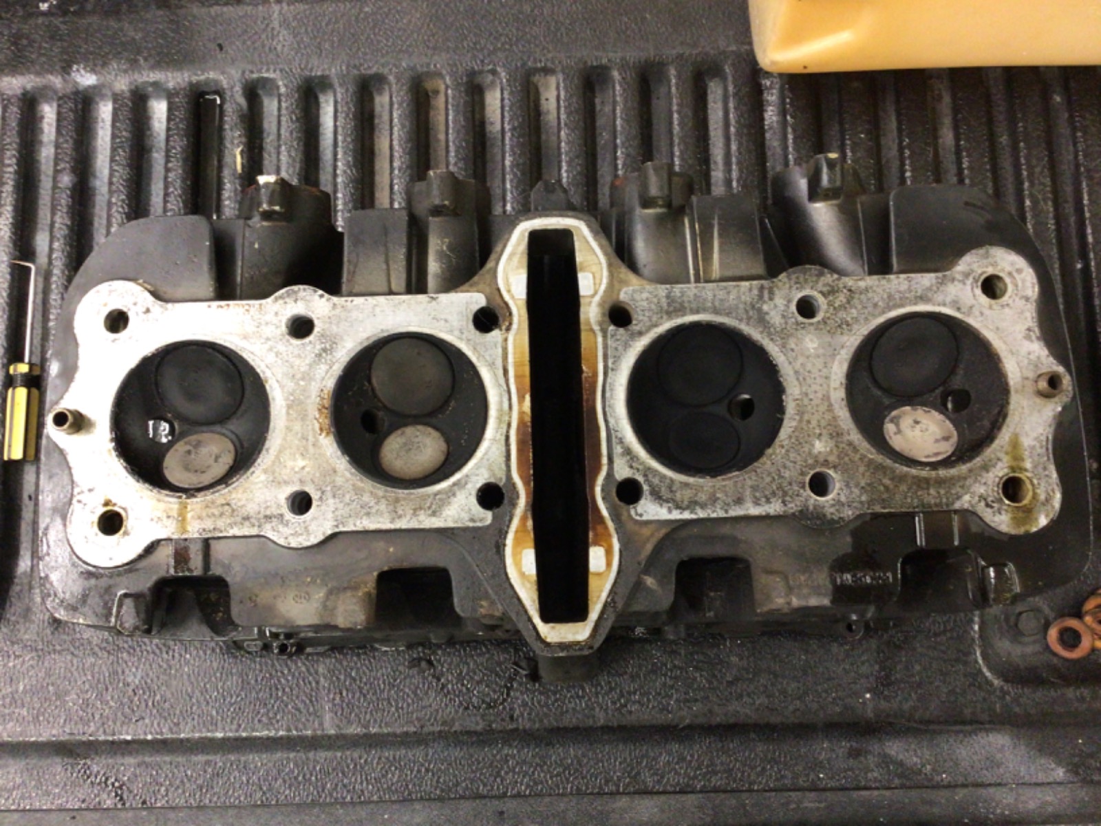

What’s odd to me here is that the #3 exhaust valve is black compared to the rest when it was the #4 cylinder spark plug that occasionally fouled out by sooting up. Strange days indeed.
Very possibly the carburetors as it was such long intervals over the years that I ran the bike. Will be going thru all 4 before I complete the project.

Valve lash is too tight. That about half of what you need. .15mm is about .006. If you lap them it will get even tighter.
- motomisfit
- Posts: 122
- Thanks: 49
Re: ‘76 KZ900 LTD. Need some advice.
08 Apr 2023 21:04
Was going off the manual that says .002 to .004 was in the proper range.
- zed1015
- Posts: 3362
- Thanks: 2072
09 Apr 2023 02:07 - 09 Apr 2023 02:10The clearance on the early Z1's was first specified at 0.05mm to 0.10mm but was quickly amended due to instances of valve burning, especially on the exhausts.Was going off the manual that says .002 to .004 was in the proper range.
The amended figures are 0.10mm to 0.15mm and should be kept as close to the high end as possible when re-shimming.
If you have clearance of 0.11mm - 0.12mm it's best to go with the next thinner shim and a clearance of 0.16mm to 0.17mm etc .
Also the fouling on number 3 is likely down to leaking valve stem seals unless there were piston ring or bore issues on that cylinder

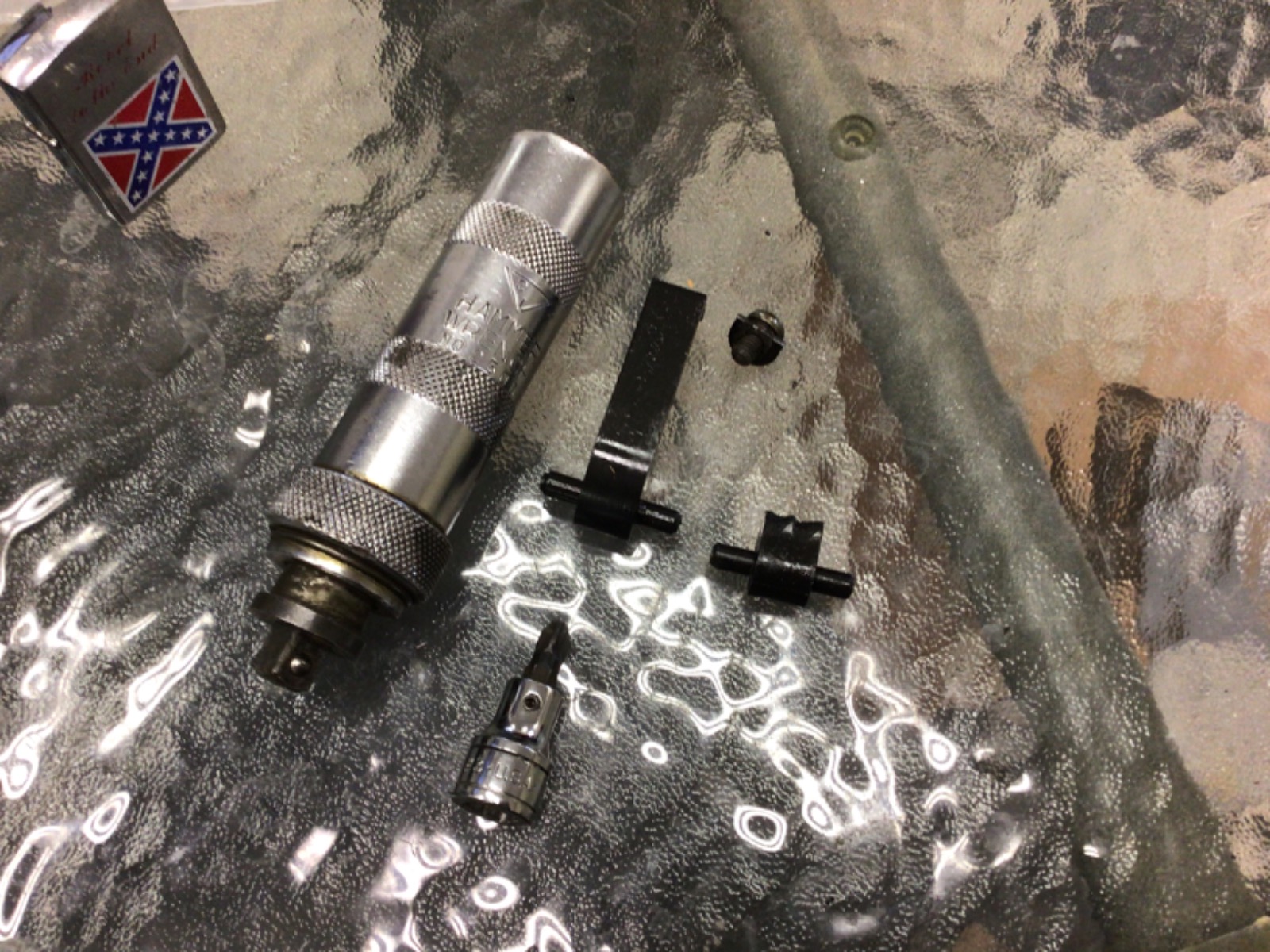

One of the best tools I in my box. No way I’d have been able to get this screw out clean without it. Sure enough a broken guide.

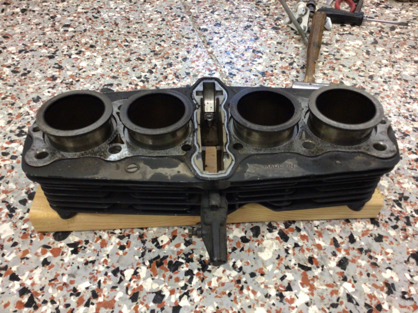

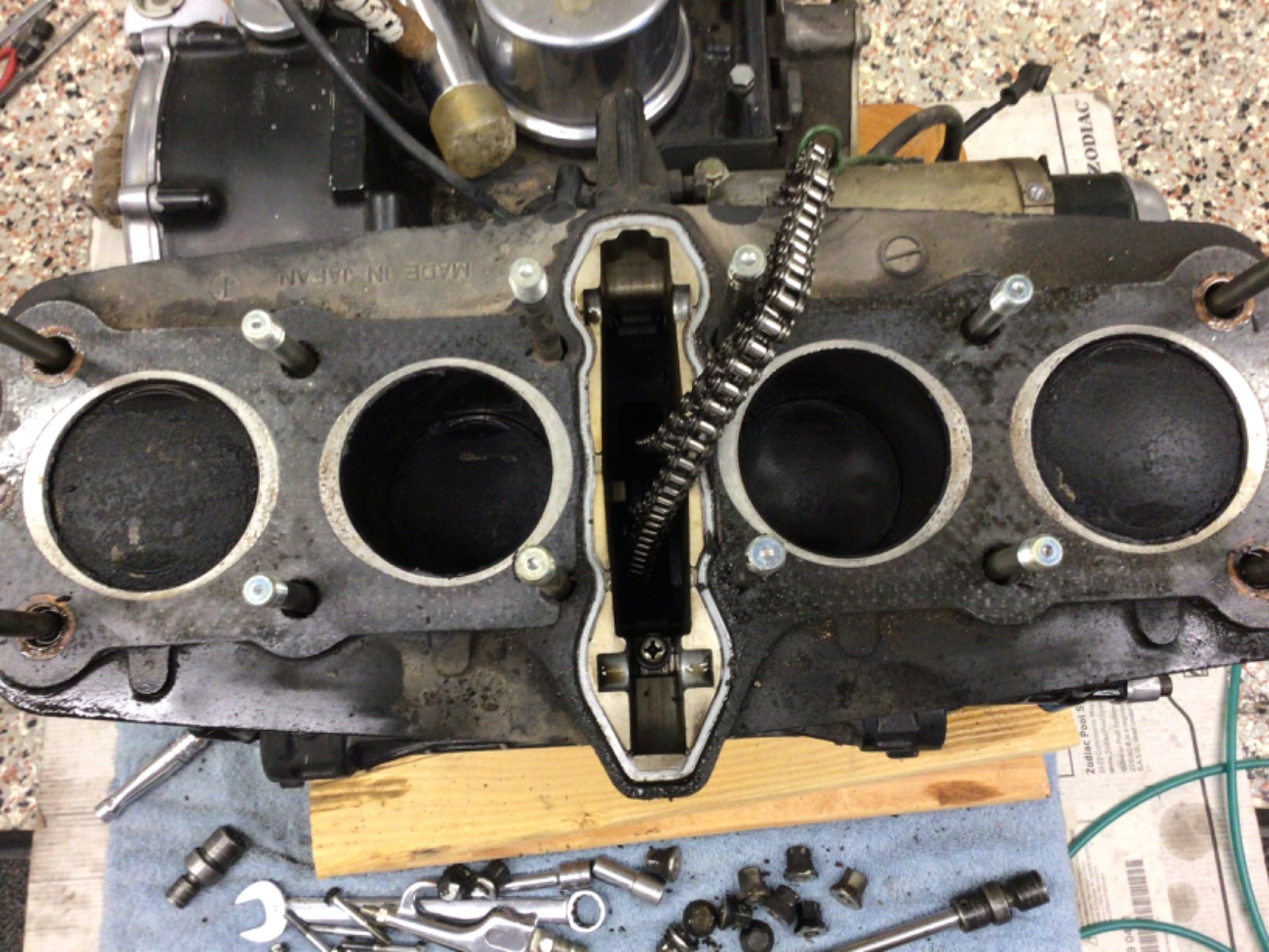

I was surprised to see that these sleeves aren’t pressed in. I thought they were. So if I go to a 1015cc piston, it’s the sleeves that get bored, correct? Sorry, probably a stupid question but I’ve never built a street bike motor before.
- Posts: 3161
- Thanks: 1252
09 Apr 2023 18:47
Yes, the sleeves are bored.
- Dr. Gamma
- Posts: 1231
- Thanks: 706
09 Apr 2023 19:08 - 09 Apr 2023 19:58The sleeves should be an interference fit. They should not come out unless heat is applied to block!!
You do your boring and honing with the sleeves installed in the block.
That broken guide (part # 12053-019) is common when camchain gets loose. Very common problem in these motors.
