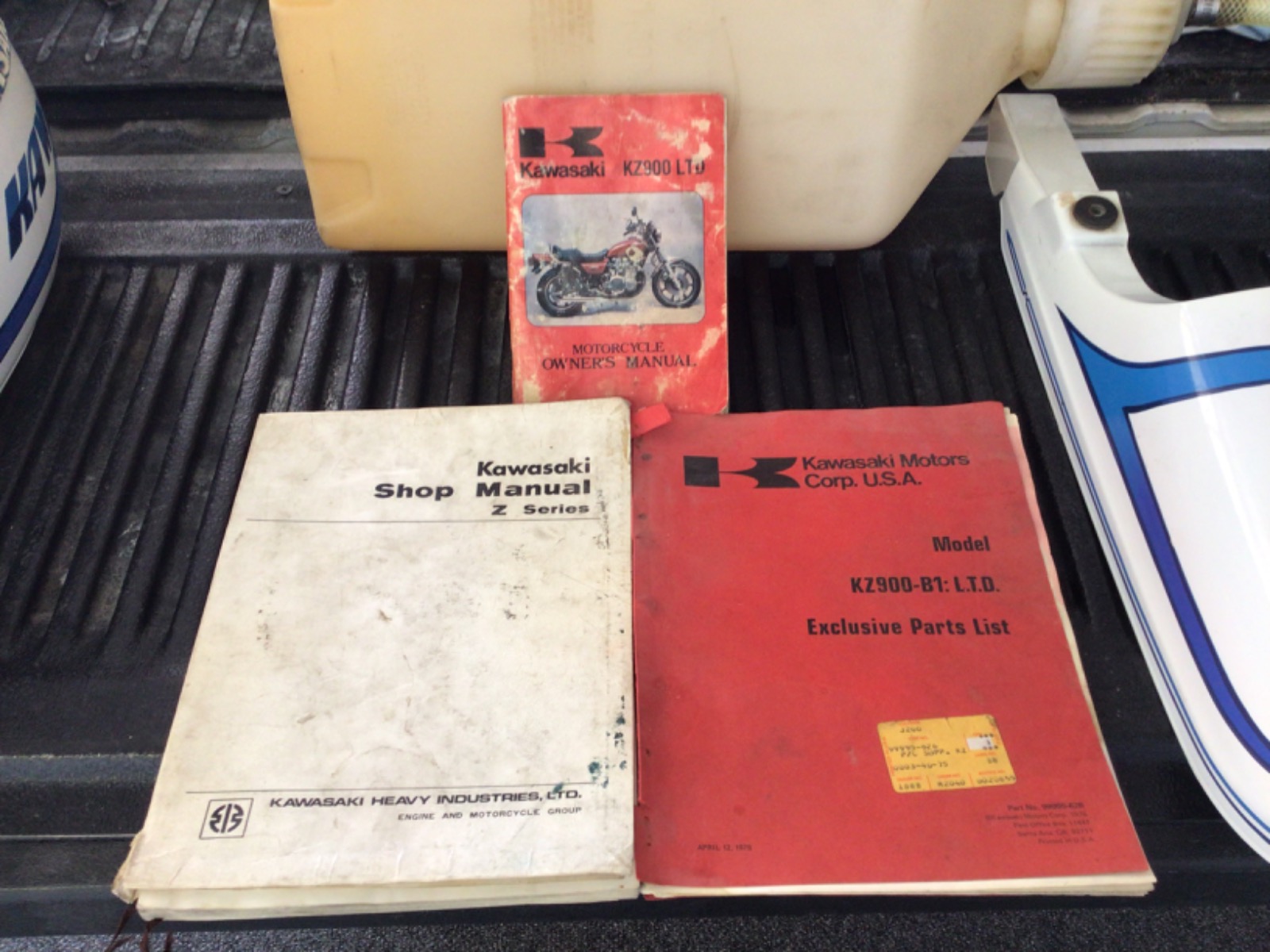

”Finding a stock airbox is going to be expensive, around $400-$500“
Fortunately I have all the stock parts that came from the factory on this bike, including these:

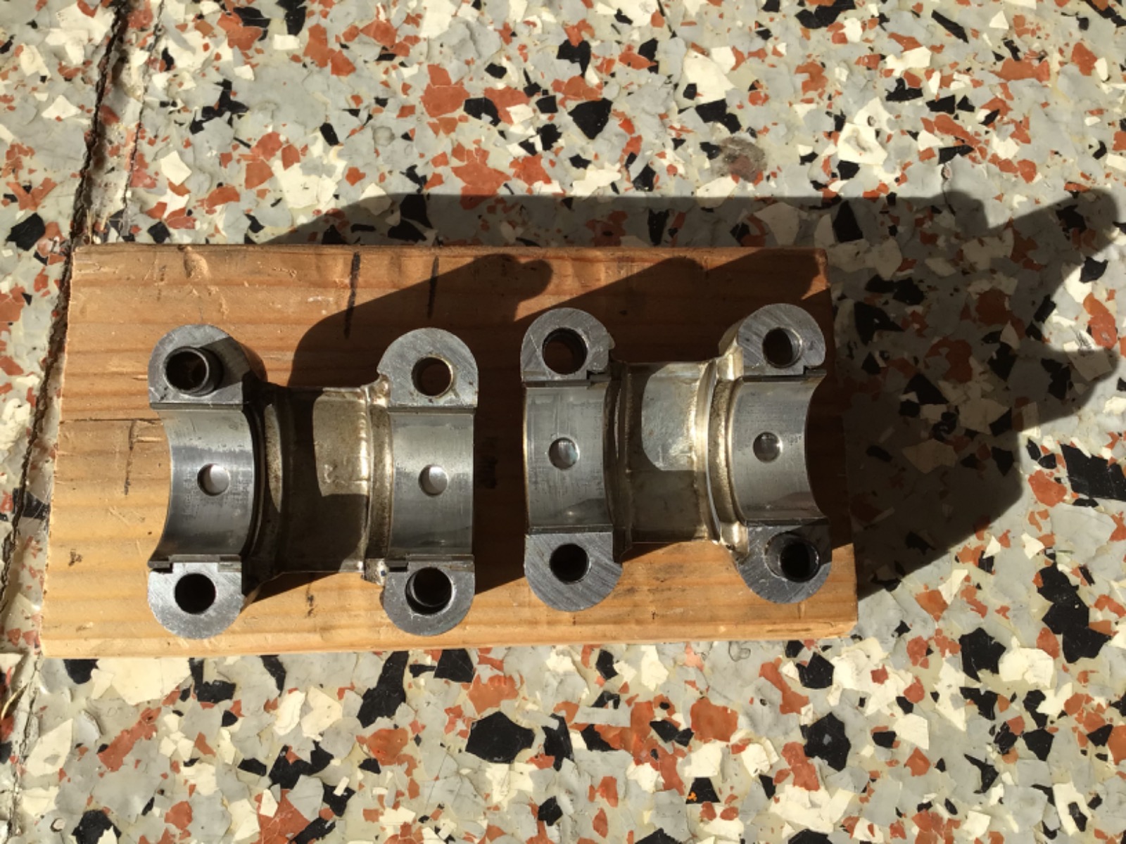

A slight groove as can be seen in the pic. 2nd from the right. I can feel it with a dental pick. Replace all?
Last edit: 08 Apr 2023 16:43 by motomisfit.
Re: ‘76 KZ900 LTD. Need some advice.
08 Apr 2023 17:12
I wouldn’t. NOS are about $180.00 a set. Aftermarkets are hit and miss. What does the cam journal look like?
