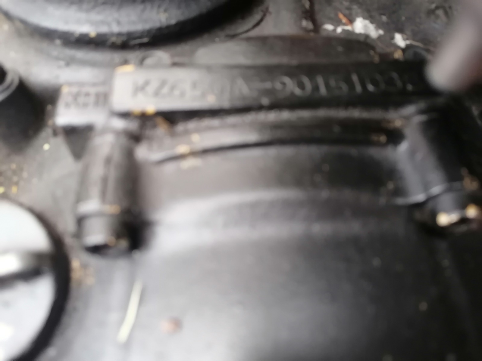

This is another one and tuned out to be genuine kawasaki from the 70s sorry this one

Your most recent picture appears to be a restamped on a 1979 kz1000 LTD. There should be a “0” after the dash before the actual number starts. They ran from 81k through 90k
