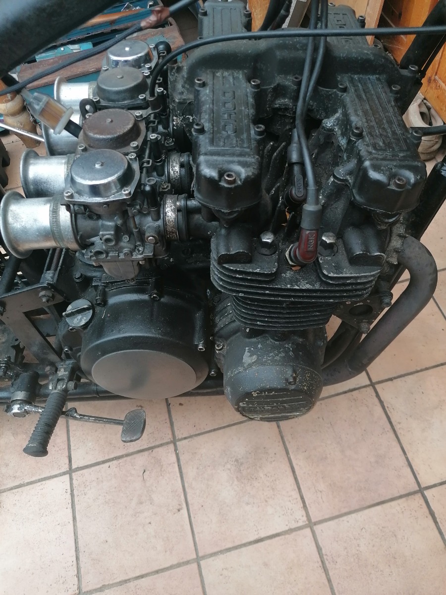

20 Oct 2022 02:15
#875749

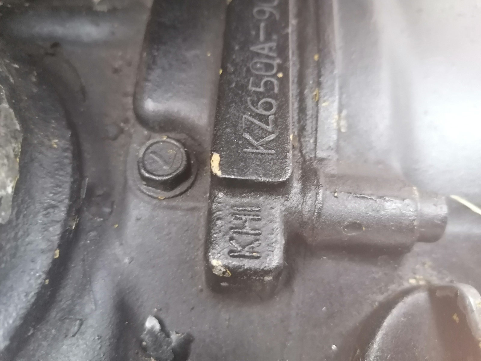

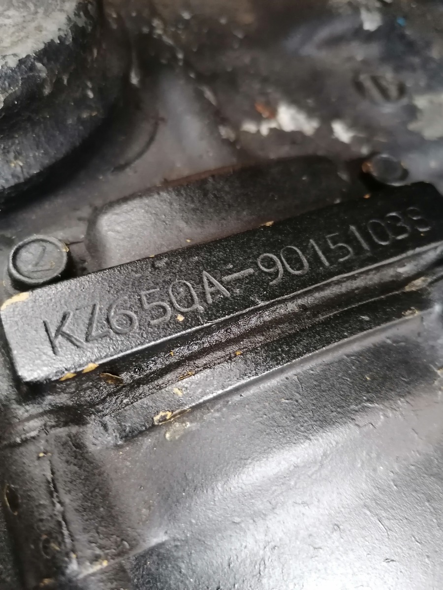

Re: Engine numbers
20 Oct 2022 03:56 - 20 Oct 2022 06:48
#875750
Not the best picture but clearly KZ650A and hasn't been restamped same engine number on documents registered in 1982 march

  • Moosey
  • Moosey's Avatar Topic Author
  • Posts: 20
  • Thanks: 0
Re: Engine numbers
20 Oct 2022 04:11
#875751
  • martin_csr
  • martin_csr's Avatar
  • Posts: 8018
  • Thanks: 1645
Re: Engine numbers
20 Oct 2022 07:33
#875757
I don't know, but I guess it could be a replacement from the dealer.  But the engine number doesn't seem right to have that many digits, plus the engine number rectangle doesn't have the raised edge around it.

  • zed1015
  • zed1015's Avatar
  • Posts: 3167
  • Thanks: 1784
Re: Engine numbers
20 Oct 2022 08:34
#875760
Those letters and numbers are not Kawasaki font but generic font of the widely available engineering number stamps such as supplied by Micromark etc
It's a neatish job but not at all original.
  • Wookie58
  • Wookie58's Avatar
  • Moderator
  • Moderator
  • Posts: 5450
  • Thanks: 3335
Re: Engine numbers
20 Oct 2022 08:44
#875762
I see what you mean ref the stamping, however if this matches the original documentation could this possibly be a "pre-production" bike ahead of a model year change that has been stamped by hand. Many years ago when we as a dealer ordered a replacement engine from VW it came blank and the dealer tech stamped the number into it to match the documentation (I have seen some done well and some shocking) not sure what the value of "matching numbers " is in that instance
