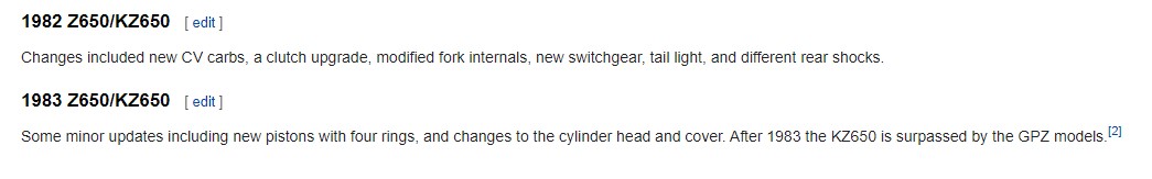

20 Oct 2022 08:58 - 20 Oct 2022 09:01As I said- this could be a pre-production bike that has found it's way into circulation. Was there any changes for the 83 model that this bike has ahead of launch date ?The numbers match all documents

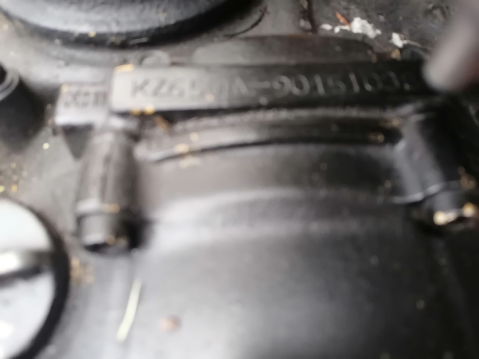

20 Oct 2022 10:06 - 20 Oct 2022 10:57Very unlikely.I see what you mean ref the stamping, however if this matches the original documentation could this possibly be a "pre-production" bike ahead of a model year change that has been stamped by hand. Many years ago when we as a dealer ordered a replacement engine from VW it came blank and the dealer tech stamped the number into it to match the documentation (I have seen some done well and some shocking) not sure what the value of "matching numbers " is in that instanceThose letters and numbers are not Kawasaki font but generic font of the widely available engineering number stamps such as supplied by Micromark etc
It's a neatish job but not at all original.
I see that the engine is in a chop.
Our local patch club used to build chops and stamp the frames and " DONER" engine with their own numbers before getting them registered.
This was back in the day before computerisation and tighter controls..
Most times they'd get a Q plate reg but sometimes an age related or current year.
I'd say this is a similar situation especially as the reg doc has no model stated either.

The S/N is almost certainly a re-stamp. As mentioned already the font is not what KHI used back then. Also, there should be no dash in the engine number. The border around the S/N plate is missing.

To confirm validity of KZ650 frame and engine numbers go here :
www.jarlef.no/Kawasaki/Series/Z/650/z650b.htm
Always the engine numbers are : KZ650BEXXXXXX (no dash and only 6 numbers always) on model B/C/F then on D models KZ650DEXXXXXX
If it is anything other than that I would suspect restamping to match paperwork (the same goes for frame numbers)
The casting where the engine number is stamped always has a 1 mm raised cast border, if it is flat it has been filed flat (to be restamped)
I personally have about 10 of these engines so I have seen a few of these serial numbers.
