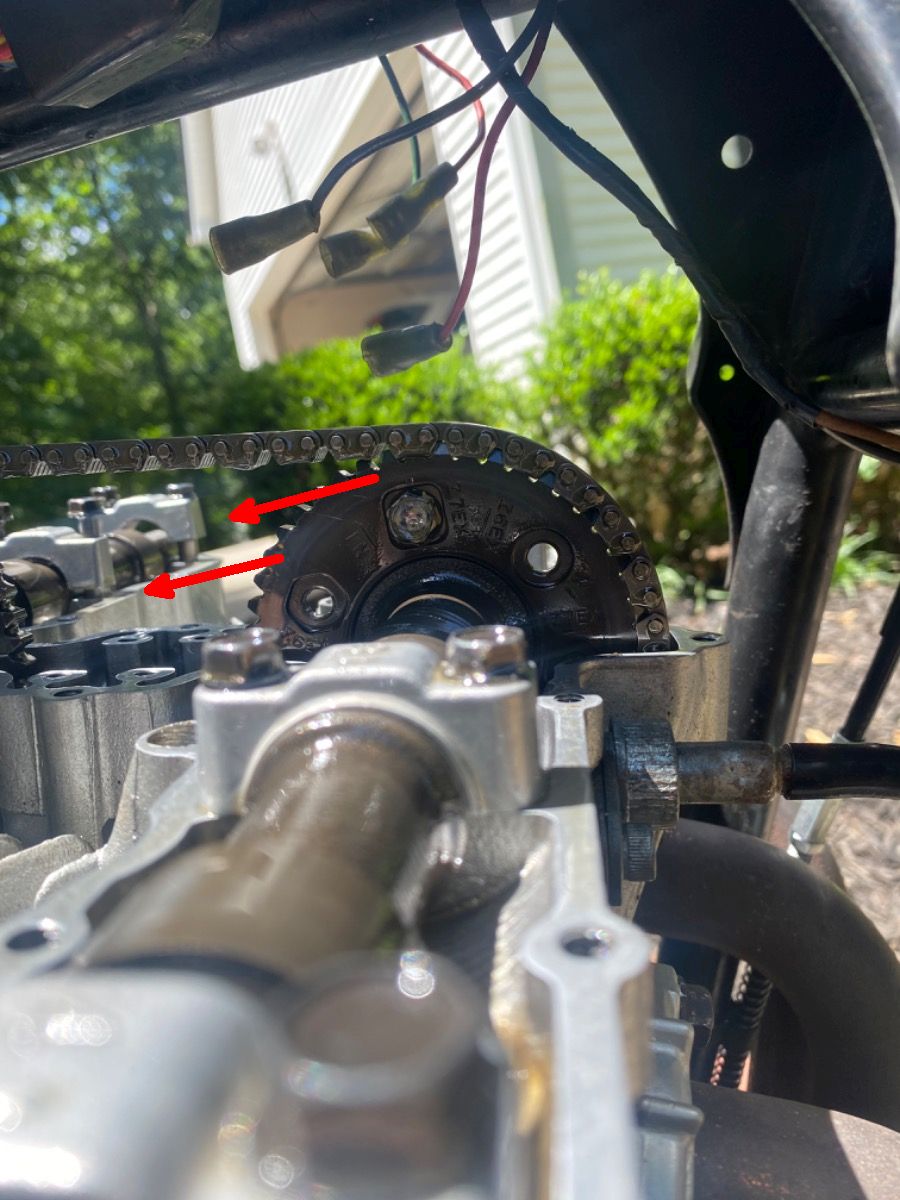

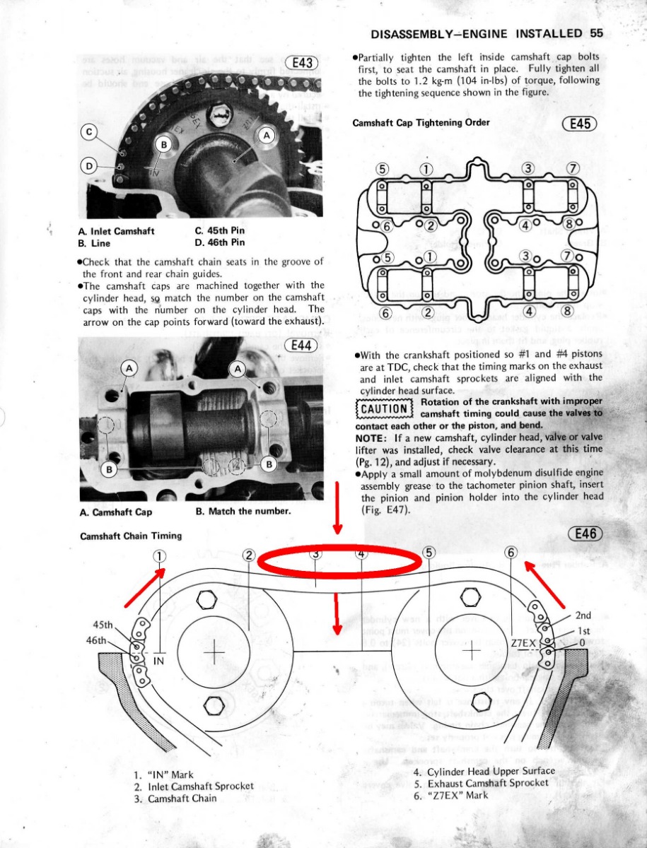

28 May 2022 11:49This was your issue, cam timing without torque down cam bearings. The cam chain guide in the valve cover do some extra pressure between the cam sprockets. The intake cam turn CW and the exhaust cam turn CCW some degrees.Well I pulled the cams, and everything timed up nicely this time. Not sure what my issue was but timing was not it. It’s still got the ticking sound coming from it.

Scirocco, this was not my issue as I only loosened the cams to retime the cams. I promise once the cams were timed, they were tightened down and rechecked to be spot on. Then the entire rotated around until TDC and rechecked the timing, which was still spot on.
