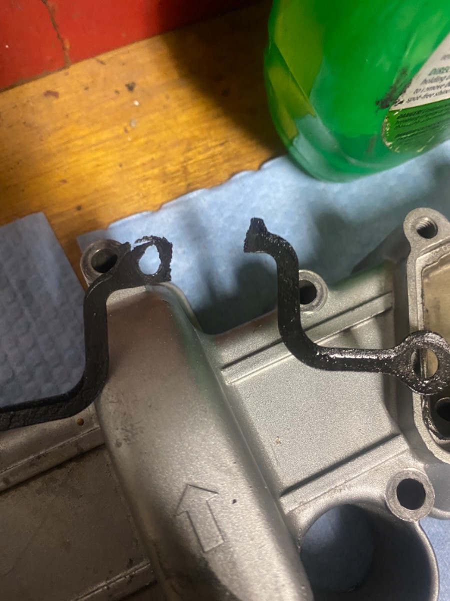

I do still need some gasket makers as the cam end covers have been removed in my attempts to clean the gunk off of the valve cover due to the old gasket.
I purchased a new valve cover gasket for $13 off eBay because mine broke in a particularly weak spot.
