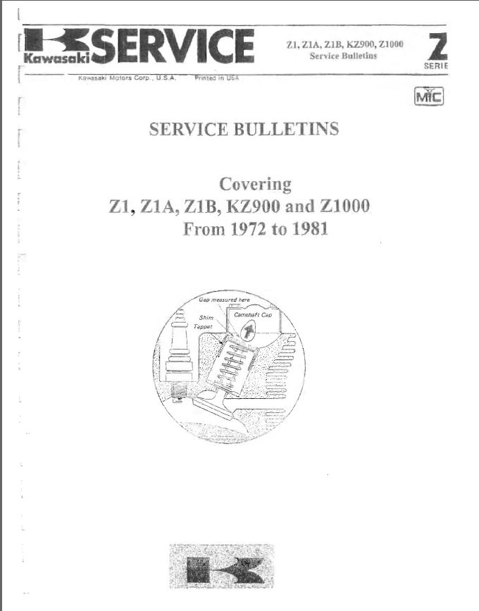

Here you will find 127 pages of Kawasaki service bulletins

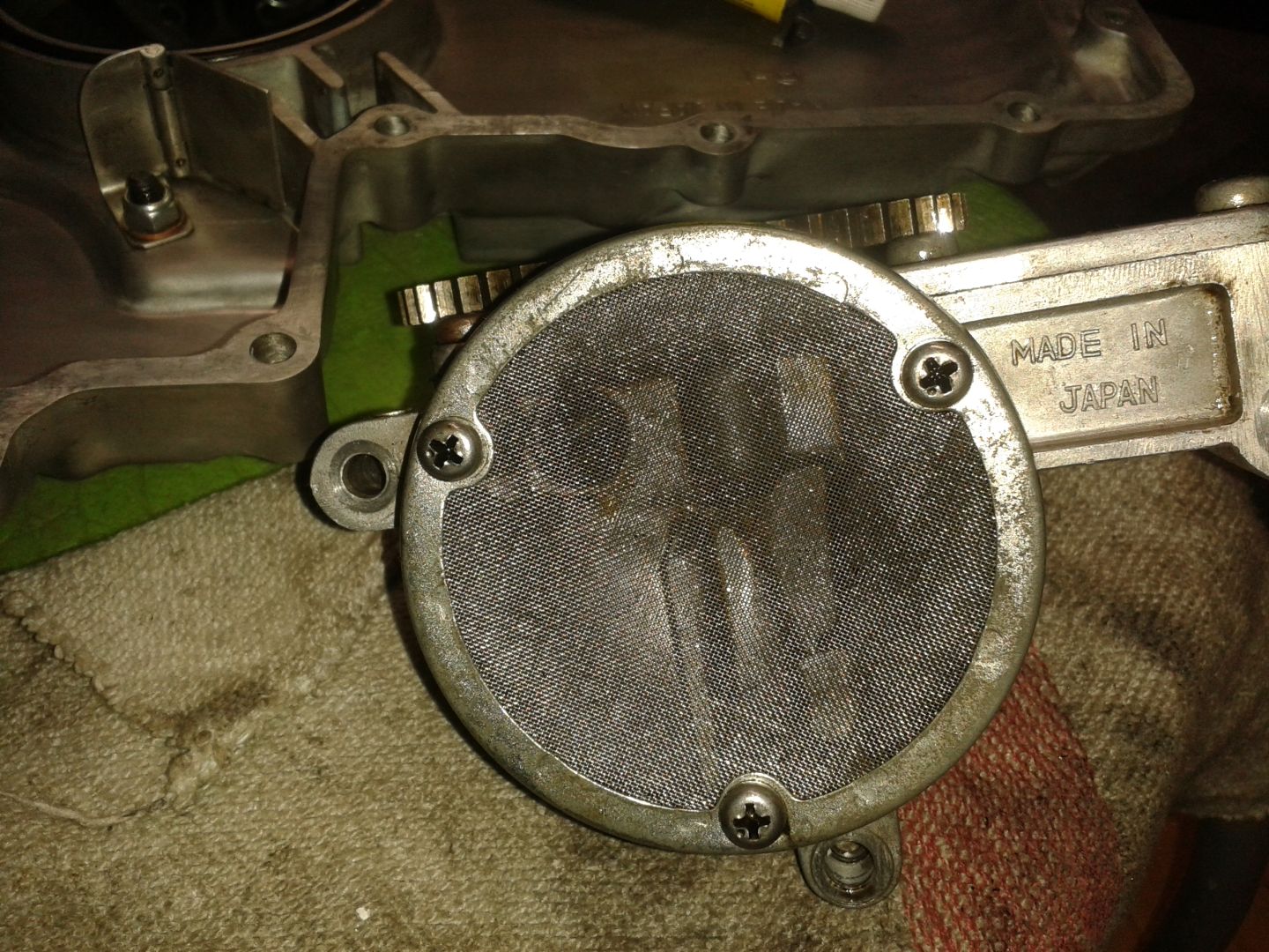

Cleaning the oil pan and oil pump screen is somtimes a good idea.

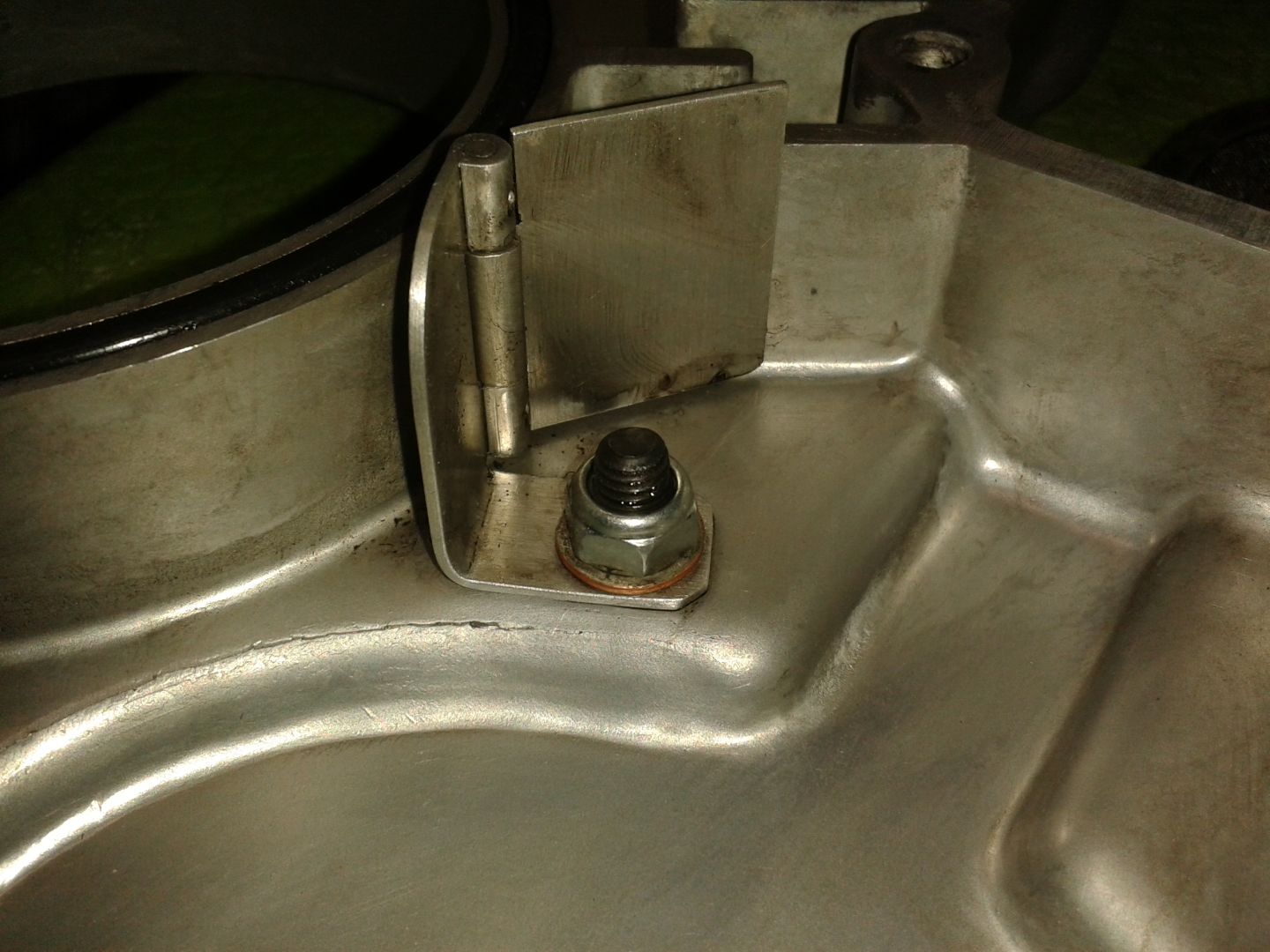

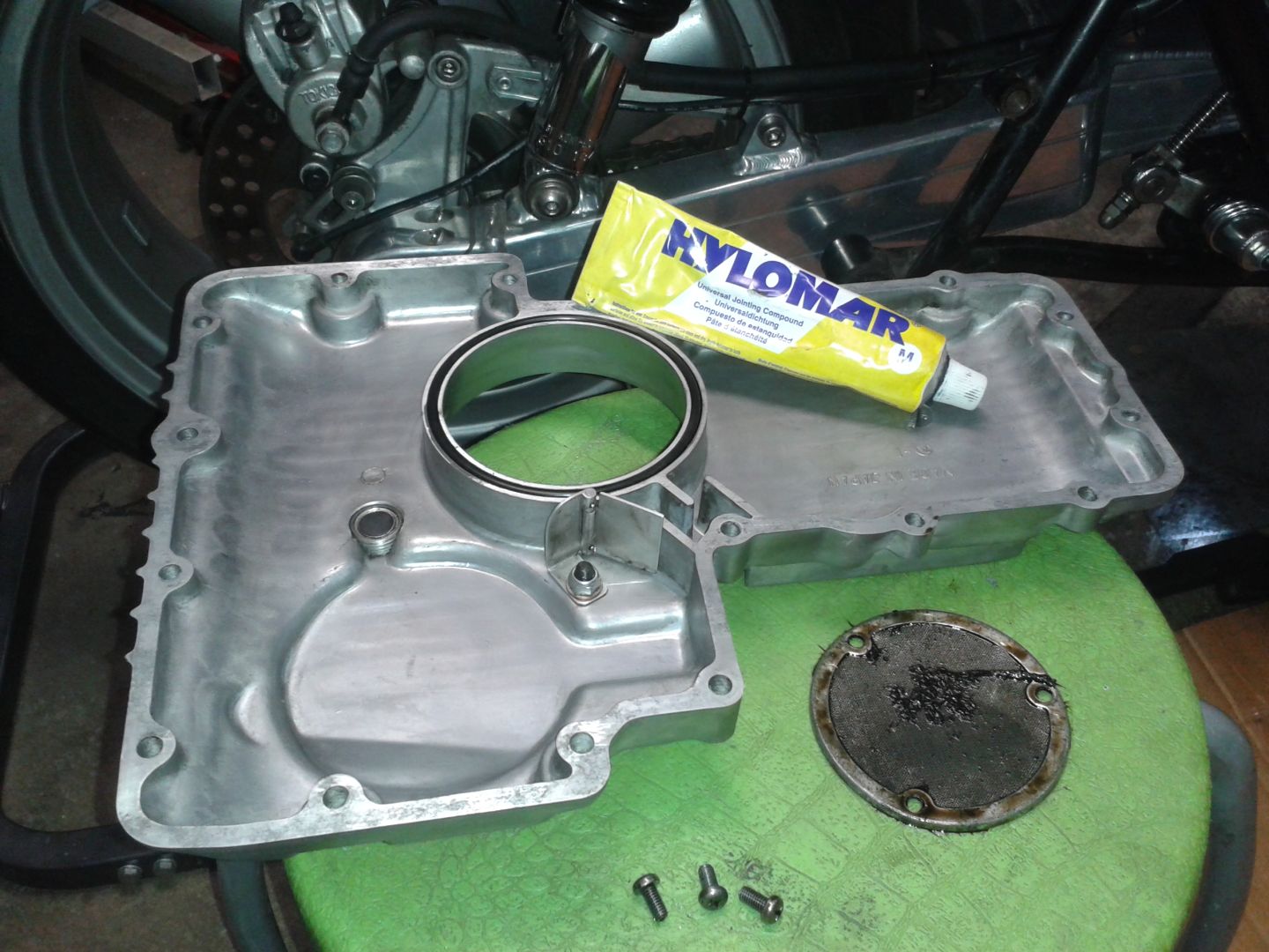

The problem with the oil light flicking on occurred with early Z1's under hard acceleration that sent all the oil to the back of the pan. This starved the oil pump, causing the oil light to come on. KHI modified the pan by adding the fixed gates shown in the photo and the problem was solved. The swinging gate isn't necessary.

I would not worry too much about the oil pump but you can check it while you're doing the bottom end. The 900/1000 series of bikes operate at low pressure and high volume. As long as your oil light remains off while running the pump will be fine. Just be sure the intake strainer is clean.

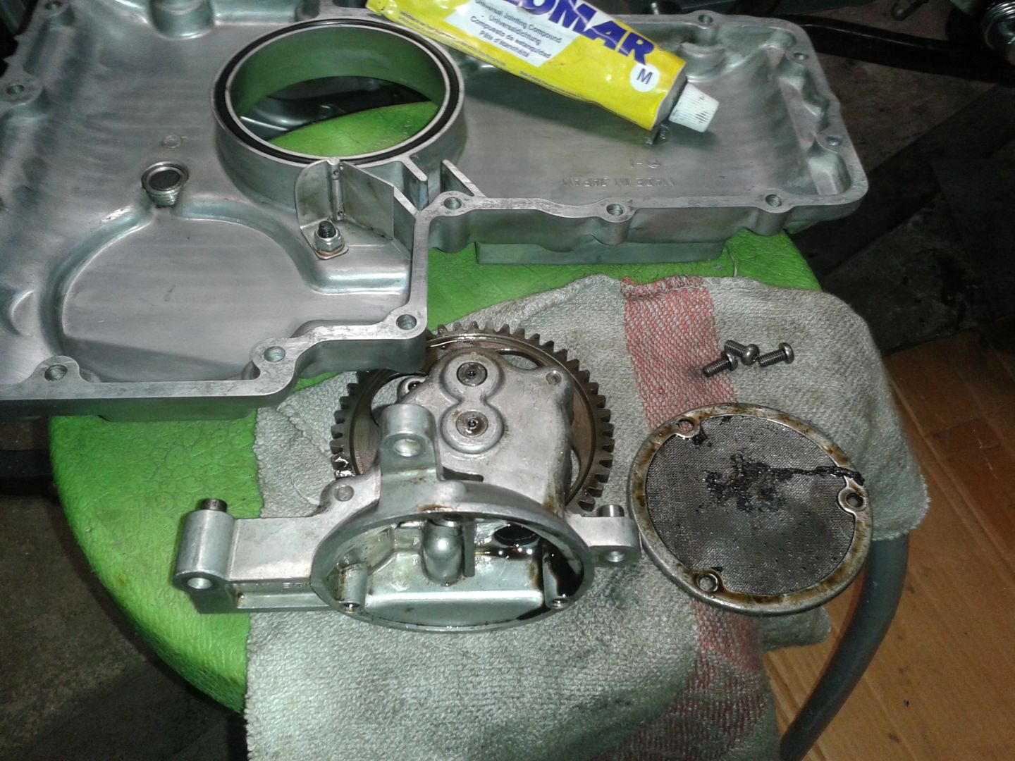

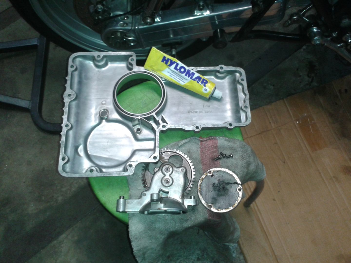

I haven't made any progress this weekend as of yet. Been trying to get some things done around the house. I tried to get my carbs yesterday, and the guy wasn't there. Again, typical for the area I live in. If someone that knew bikes could come down here and open up a shop that had some idea on how to run a business, it would be a gold mine. I think I'll spend the day cleaning up the pan and other things I've taken off.
