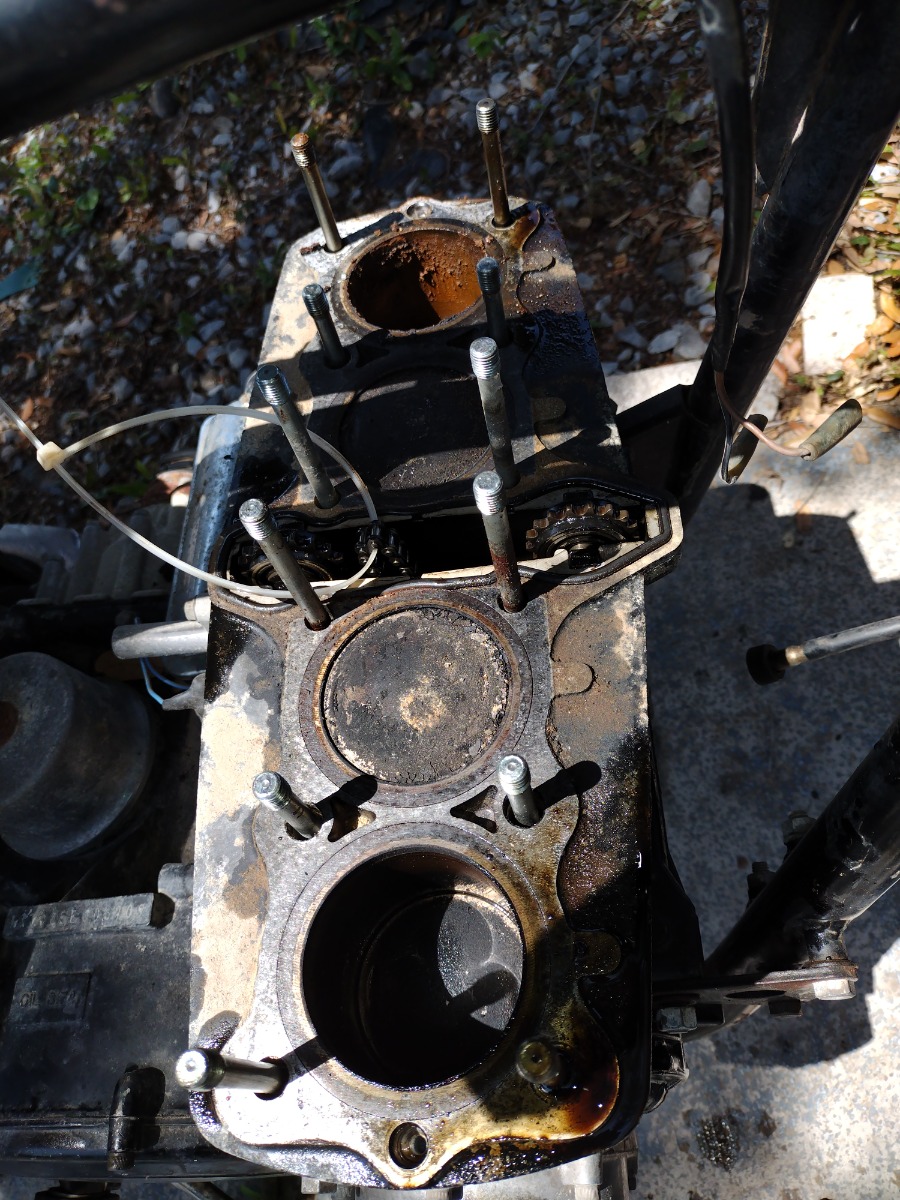

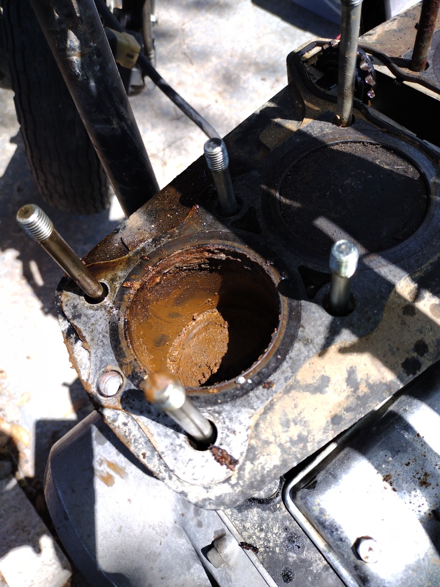

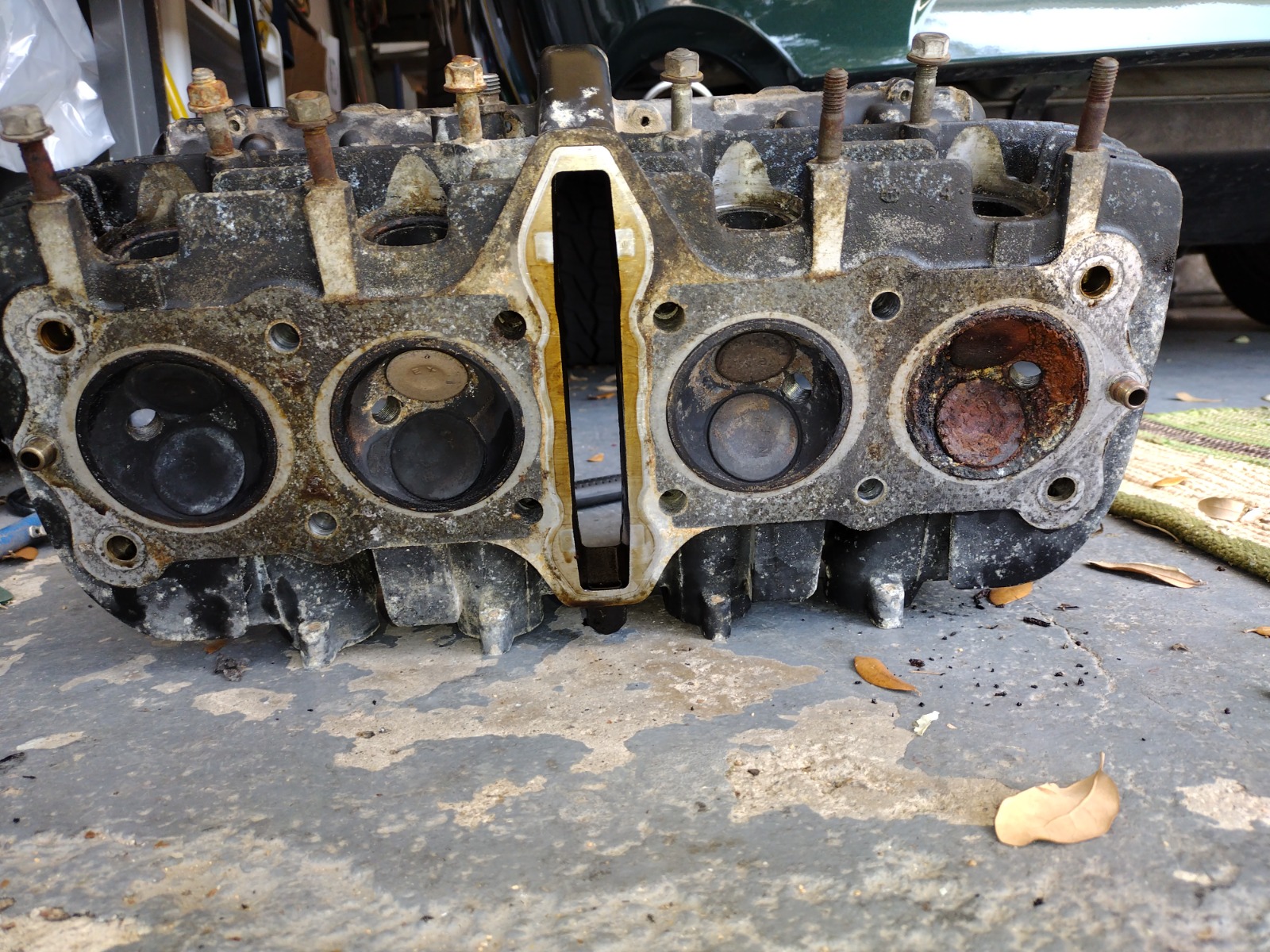

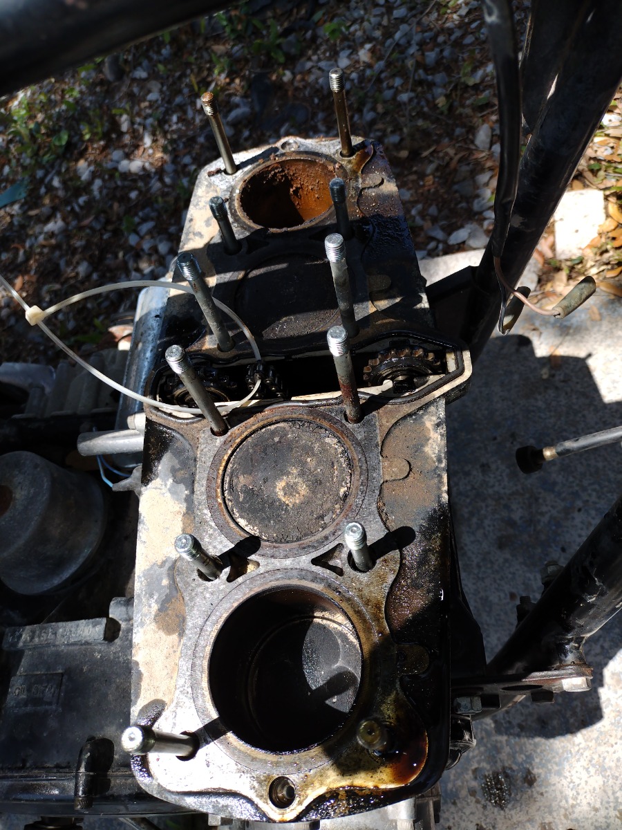

I got the cams out and head off. Luckily, I was able to turn the crank enough for it to come up tdc.
A few more questions now...
1. Do the buckets have to stay in a particular order?
2. Where do the shims fit? Between the valve and the bucket? A couple of buckets came off, but I didn't see shims.
Here's what I got. Obviously there wasn't a stuck valve, or if there was one, it freed itself when tapping cams caps and head. Can I turn the crank to see if it revolves the whole way?
1. I'm thinking the cylinders will have to come off or can I hone them on the bike?
2. If it's past the honing stage, what should I get it bored to? I don't want a 1400 cc monster.
Thanks again for everything.

Looks like you found the source of the problem
in answer to your question you can't hone with the cylinder in place (there is still a piston in the bore) and to be fair I think that one is probably past honing.
I would suggest removing the cylinder and cleaning it up, the depth of the corrosion will determine how far you need to overbore to get to a clean cylinder.
I would suggest before you start spending money you strip completely and inspect everything, if the PO has tried starting it with a bore full of water it could have bent a con rod (liquids can't compress so something has to give) this is normally the first point of weakness when a motor has water in the cylinders
With regards the shims there are two different set ups used "shim over bucket" uses a large shim on top of the bucket that the cam operates on, "shim under bucket" uses a small shim on top of the valve stem (I am sure the guys who are more intimate with this specific model can better advise)
With regards bucket locations, it is best practice to re-fit components in their original location if re-using old parts
