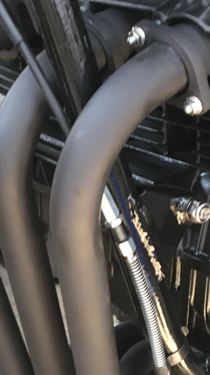

I lubed my clutch wirer yesterday, and identify some corrosion after the adjuster midway (with the cylinder 1 exhaust pipe).
Maybe these is the reason for snapping, water comes in here? What do you do to avoid? Have some three bond gasket inside to block the water?
These adjuster:
These adjuster:

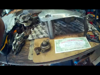

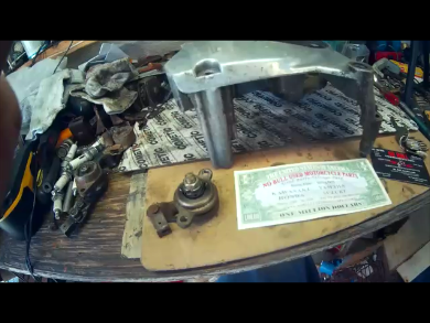

I had both types when rebuilding my 750 and chose to go with the ramp and ball version which was smoother. It's a little finicky to set up though in that you have to get the ramp in the right position during assembly or there will be no clutch. Going off memory but the arm on the mechanism needs to be at roughly 90 degrees to the cable coming through the cover.
old_kaw wrote:Nessism wrote: Steve,
Your top photo shows a ramp and ball type and the lower down photos show the helix.
The top pic is a helix too. You can see the tabs from the inner retainer.
Thanks for correcting me. My bad.

Do you have a part number for the stock ramp and ball unit? As to not hijack this thread I started my own. I'd like to post one of them to provide more choices.
650 Ed, I switched the clamps. Thank's for the heads up.
No arrow
This is what I bought
No arrow

Clutch cable problems in that area are not from water, instead from im-proper cable routing and exhaust heat. Normal cable lubing should prevent water to cable ingress.

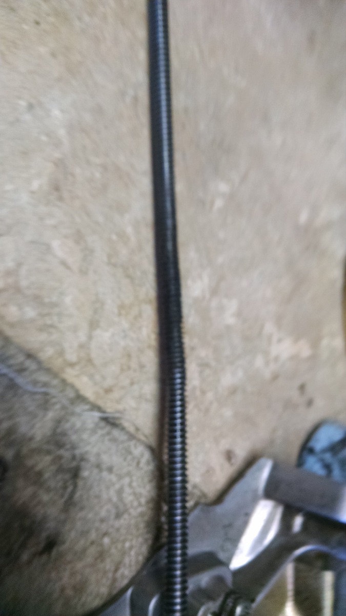

THIS is a cooked cable, fo-sure. lol

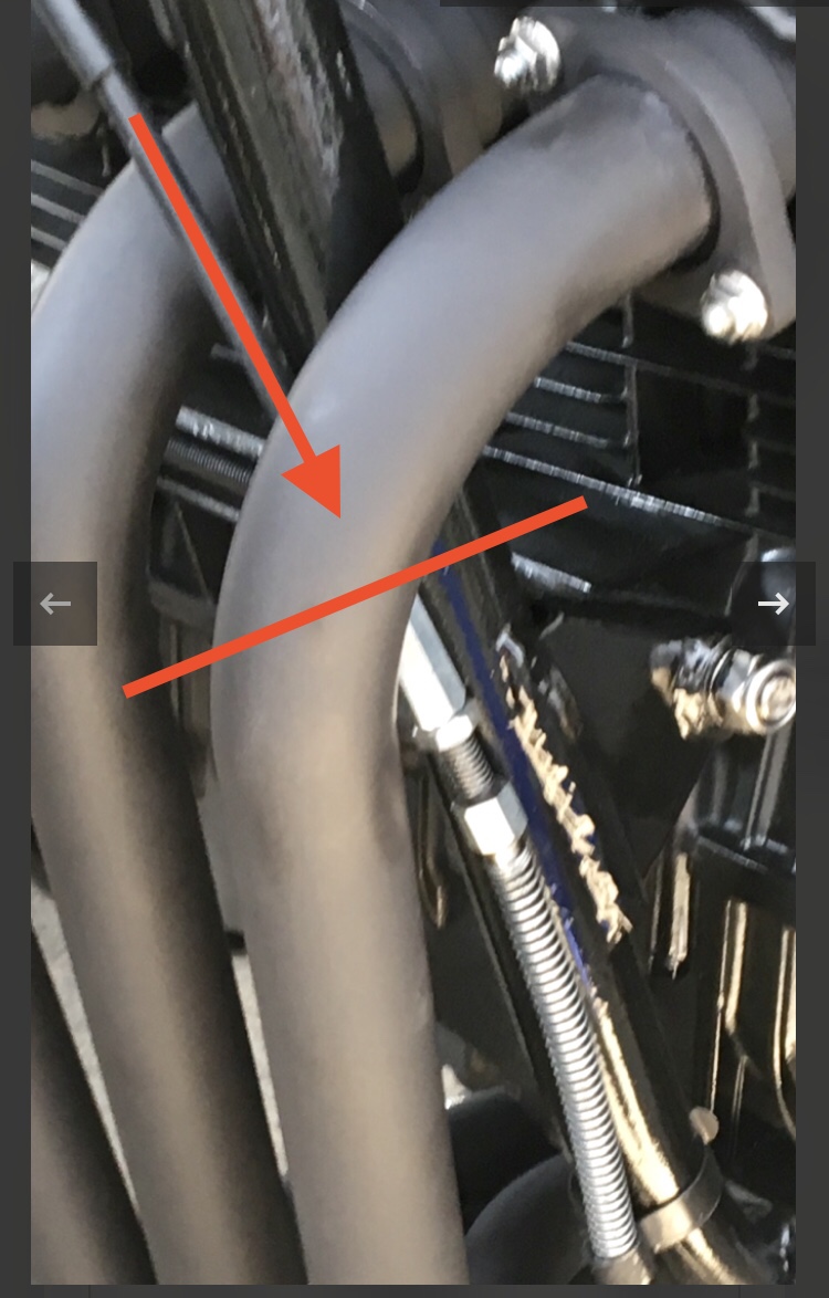

17 Mar 2020 12:00 - 17 Mar 2020 12:03Your photo is taken to low, the problem is where the wire from the clutch handel goes into the adjuster... not after the adjuster.

17 Mar 2020 12:57I don't claim to be a rocket surgeon Gordone, but my pic is pretty close to where your pic was taken. Nether pic looks very close to the clutch lever to me.
If water is entering at the clutch lever, there are boots that can be had to cover up that area.

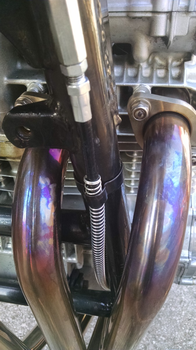

My English is not exact enougf, full misunderstanding here
On my cable was water coming in here, please ser picture below, properly from pressure washing?

If the clutch cable length and clutch acutator get his final adujstment i heat up a shrink tube and seal the non-water proof part.....(easy 2 Cent fix).
