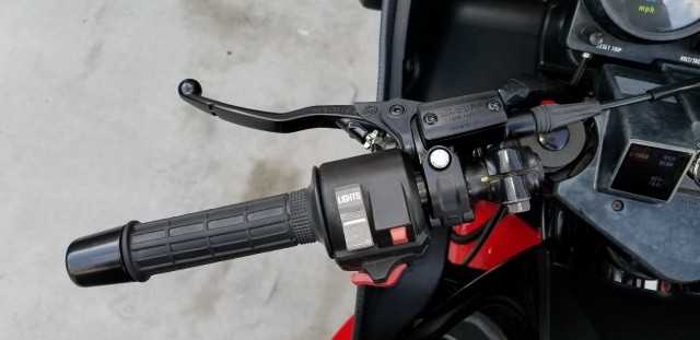

Might not work on your bike but theres a guy on the turbo site that sells this kit . This is the company www.bikebandit.com/aftermarket-parts/con...NEAQYBCABEgLUNPD_BwE

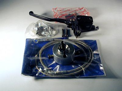

Both are nice. I got tired of cables so I got a set of zrx perches and mounted a hydra clutch. Z1 Larry did his as well. He said that he can't imagine any other way. To do the hydra clutch I got one from overseas, Les Holt can make you one. I tried to post a pic from my phone but it was too big so it didn't upload. A set of zrx perches is THE way to go to look low key oem IMO.

AmericanClassix sells one. I have no experience with it but it claims to be a “kit”

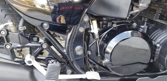

Here's my take on your question, I don't mind a cable clutch and in fact prefer them to hydraulics. I also didn't want to dramatically change the appearance of my '77 KZ-1000 so a hydraulic clutch was not an option for me. The hydraulic clutch kit discussed in this thread is $296.00 and they don't show a kit for my bike, while the PMC kit is about $120.00 and it is made for my bike. So the choice was a no brainer for me. The PMC kit comes with instructions, but they are in Japanese, but I figured out the install process. Actual time to install was probably an hour or less without the time to try and figure out the instructions. I also did not want to change the clutch lever or perch, I wanted the "stock" look. I had hoped the EZ-Pull clutch would lower the clutch lever effort, but I had no preconceived idea of how much it actually would lower that effort. As it turned out it lessened the effort a lot. Some say as much as 40%, but I can't give an actual amount however I was surprised and very pleased with the end result. I can't speak to any real riding time with the PMC kit yet, due to winter in my area, but I did get a few miles on the bike with it and it works great so far.

The 650 clutch pull mechanism is different than the 900/1000 bikes and the 650 has an easier pull. With the PMC kit my 900 is just as easy as my 650 now.

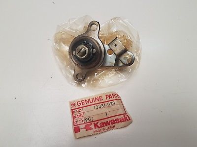

If you use a REAL O.E.M. Kawasaki clutch cable and have it properly routed along with the '79/'80 style Kawasaki clutch release (13231-020) you should have no need for one of those fancy hydraulic clutch releases. I can't believe how most folks route their clutch cables on their bikes. Cables do not like tight radius bends. Nor being routed close to the exhaust pipes. I WOULD NOT USE ANYTHING BUT A O.E.M. KAWASAKI CLUTCH CABLE!!!! They are getting hard to find anymore, but more than worth their high price they bring today!!!! The aftermarket clutch cables I have seen are pure junk compared to the O.E.M. Kawasaki clutch cables!!!
I run the Z1r O.E.M. clutch cable (54011-070) properly lubed and routed on my Kz1000 along with the '79/'80 ball bearing clutch release (13231-020) but with some serious heavy duty clutch springs. And I only use two fingers to pull the clutch lever in!!!!! That old style white plastic clutch release is a joke compared to the late model ball bearing clutch release as far as a cause of heavy lever pull. Plus all the hydraulic clutch bikes I have ridden do not have that wide progressive engagement of a cable clutch setup.
The BEST clutch release Kawasaki ever put in their bikes!!!!

Those pics I posted are my friends bike . He has Heavy duty clutch springs . I had some on my turbo and they pull pretty hard . Now two of my turbos have lock ups and my stock bike is stock and pretty easy to pull .
That 79/80 ball bearing clutch release looks like the way to go .

In all fairness I bought the EZ Pull clutch kit as an experiment. It wasn't due to any problem with clutch pull of the "stock" components, albeit nylon that they are, I just wanted to try something that worked better than plastic/nylon. The stock setup left a lot to be desired in my estimation and I had read about the later clutch mechanism part # 13231-020, but couldn't locate any, save for one on Fleabay at $200.00. So after Baldy110 wrote about his experience with the PMC kit I thought what the heck, give it a shot. Obviously my choice worked out for me, but in fairness if I could find a 13231-020 release and at a decent price I would probably try it just for a comparison. I am a big fan of trying to stay with OEM parts, but in this case I can't find the OEM part that's affordable so PMC is was.

Dr. Gamma is correct the OEM ball bearing setup is the way to go. However I too was unable to find one new and used one's are crazy money. That's the reason I went with the PMC setup. I'd love to find a NOS 13231-020 at a reasonable price but ain't gonna happen.
