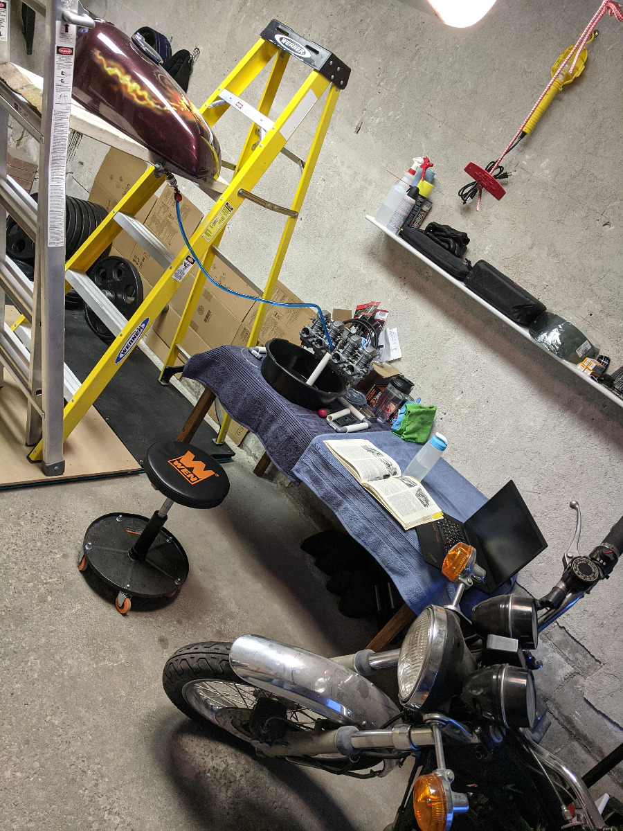

Now that the weather is nice again, I've resumed work on this project
I drained the fuel before I stored the carbs. I attempted doing the float test before storage but by then it was cold and I was having a hard time setting things up, so I decided to wait.
I made a carb holder out of some tubing and it seems to work okay (better than trying to prop the carbs up with jack stands on either side smh). I'm using the clear tube method and I did the first carb so far, I'll do the other three in the morning.
As per my manual, I am measuring the distance from the base of the carb to the height of the fuel in the tube. I am checking that the distance is between 2.5 mm and 4.5 mm. I believe since I stored the carbs dry, and its only been a few months, I don't have to bother opening the carbs up again and cleaning right? I would like to avoid this if possible but let me know what you guys think.

You may want to lower the height of the fuel tank down to a level that is closer to the level that it would be at when mounted on the bike. Otherwise the fuel pressure will be greater than normal, and that may lead to other issues.

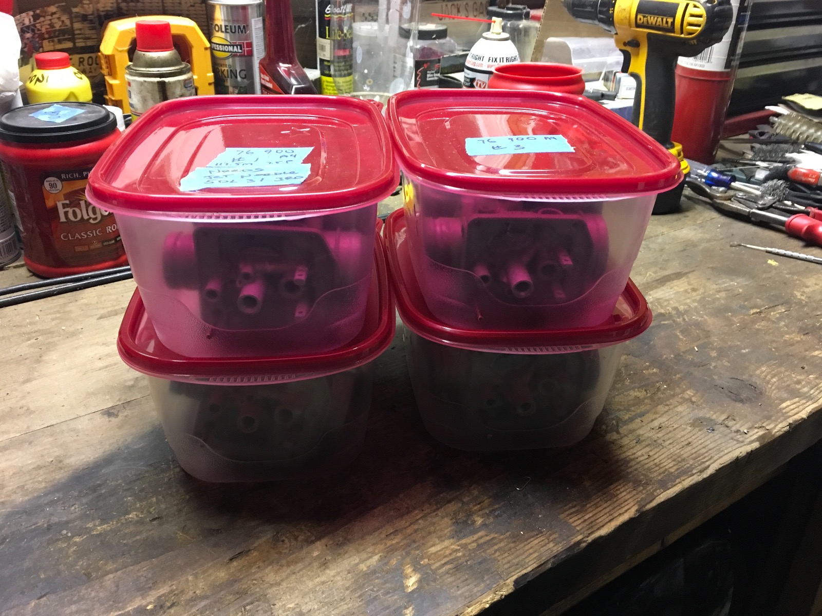

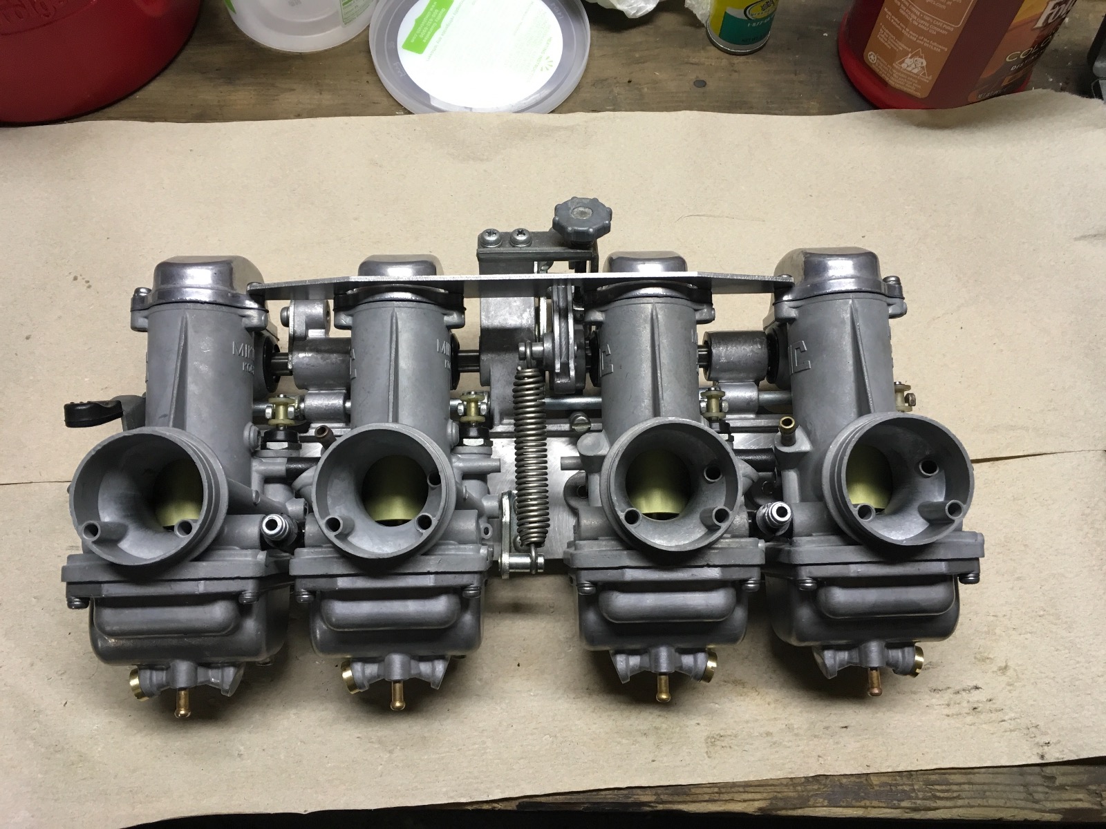

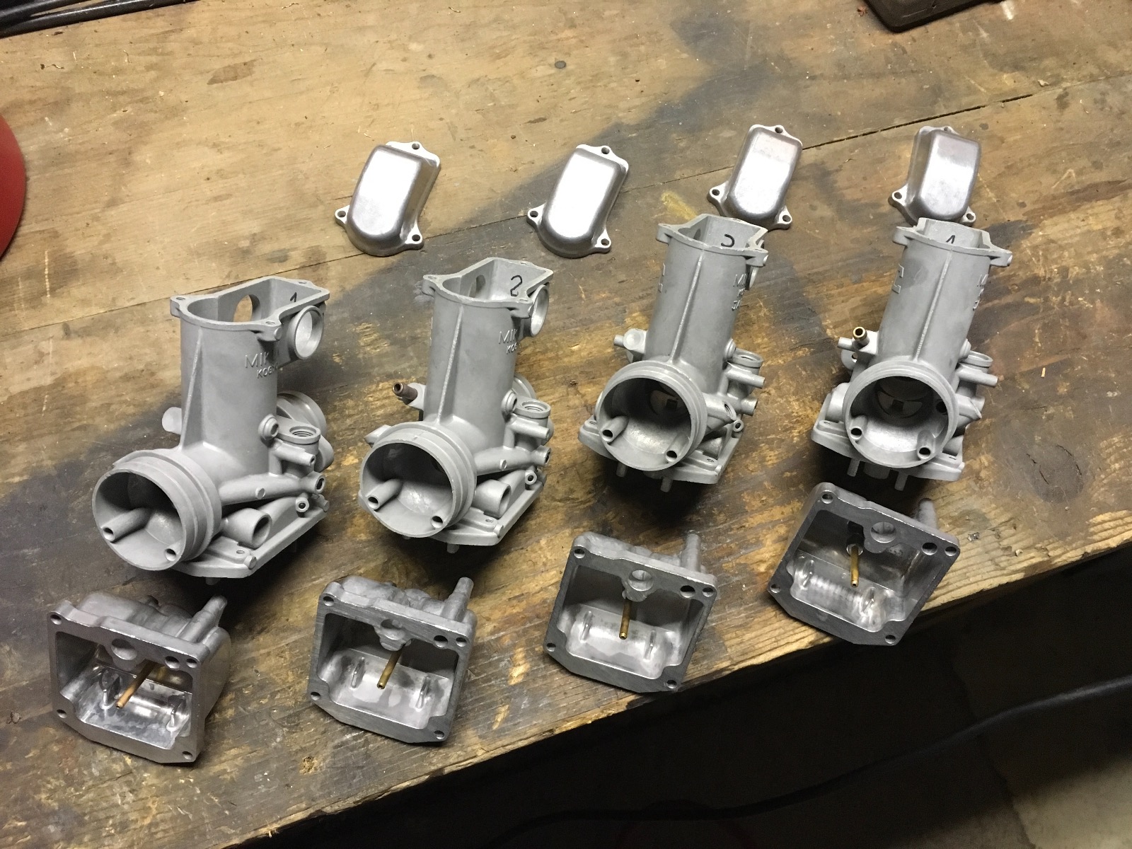

I am by far a carburetor expert. I have only rebuilt 3 sets but every thread I have read on this forum mentions the only correct way to do it is to ungang and completely disassembled. Even that method isn’t foolproof but gives you a much higher success rate. You may just have a bad O-Ring in the choke enricher circuit

I opened up the carbs again last night. I cleaned the jets again but this time I replaced the float needle, fuel mix screw, and the slide needle on each carb. I had these parts as part of the rebuild kit but I tried to use what was already on the bike. Decided to just swap in the new ones hoping it helps. I was really thorough on my last clean, everything still looks good in there.
