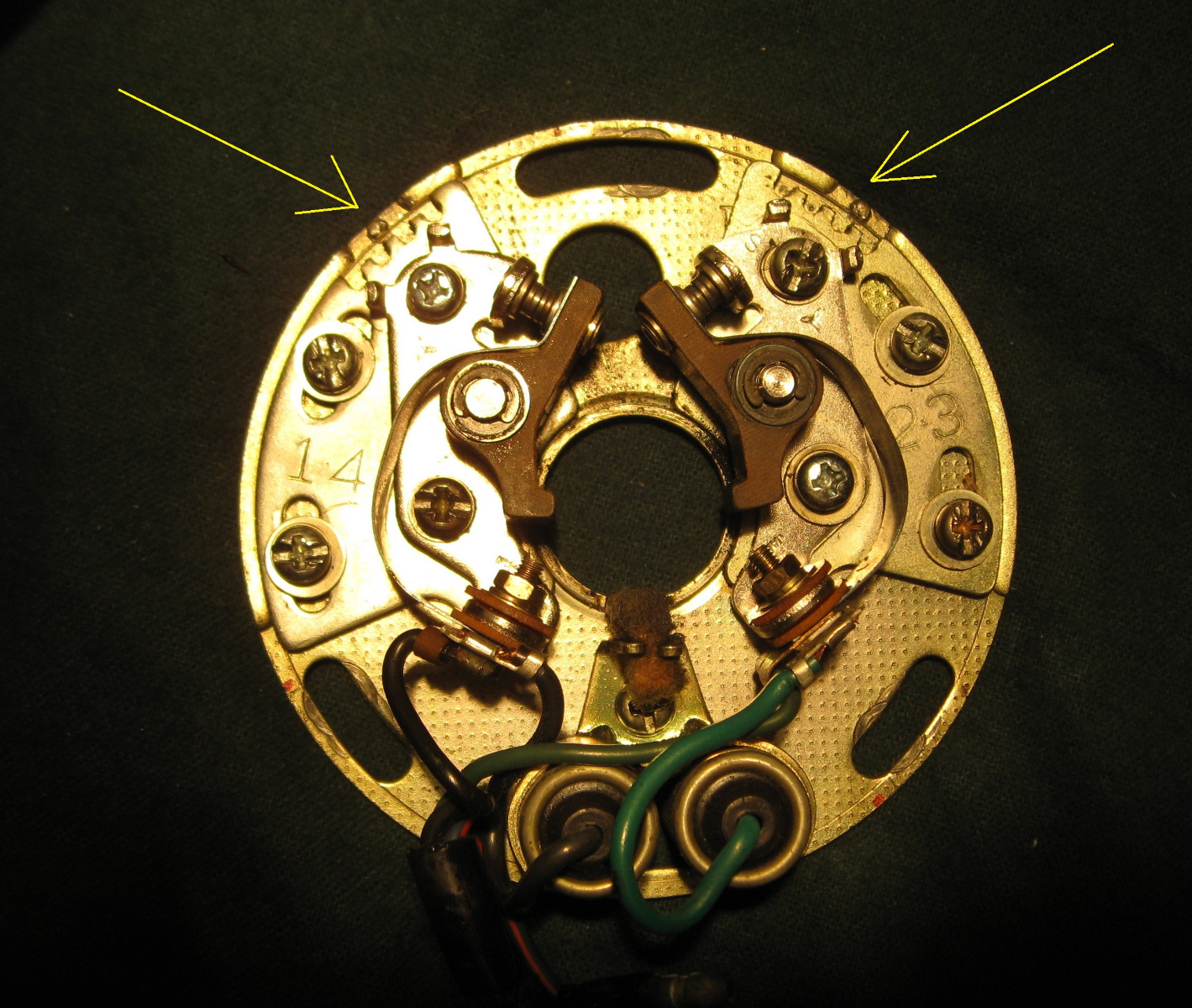

The KZ650-B1 points plate should look like the one pictured below. It should have plenty of room for adjustment because not only the entire plate can be rotated but also each set of points can be further adjusted. If yours does not have the two adjustment places pointed to by the arrows someone has installed a later points plate.

Yes that's how my plate looks. I will try again tomorrow but I did play with the secondary adjustment per point as well. I maxed out the left one rotated clockwise so its sitting on the bottom of the adjustment oval. I did this to try and give myself as much adjustment room on the right points. When I had my multimeter hooked up I was not getting any reading at the F mark no matter how much I adjusted the right points alone. Ill try again tomorrow by maxing out the left points the other way, timing the left points perfectly then I should see a significant difference in terms of what position I get a reading. Will try.
