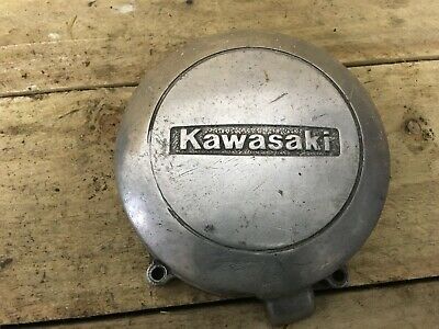

A pic of the alternator cover will help identify it.

The points cover?
Crappy pic but it's what I could find right now, cropped into the cover area. Found this online that it looks like:
EDIT: actually after looking at it again, the above pic has two bolt holes on the bottom where as mine has one on top, one on the bottom. I can't find any examples of that exact one after a quick image search...I can take a pic of it tonight.

See how the face of that alternator cover is smooth? The 1977 one will have 3 screws in a triangle pattern on the face. That makes it a 3-phase stator with a field coil.
