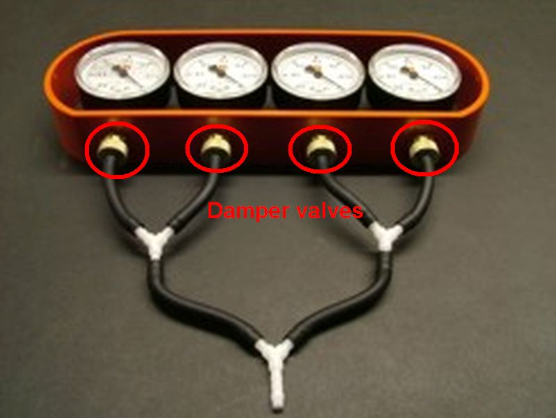

Something is wrong if you can't pull enough vacuum to do a proper sync job. Do the sync tool vacuum lines have the proper restrictor valves installed?
