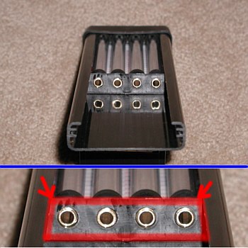

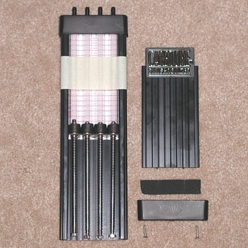

How can a sync be performed with the sync gauge upside down anyway? The metal rods will just slide down won't they?
Re: Gpz900 engine temp struggle...
18 Jun 2018 13:59
Yes Nessism thats what i though first!
I think he has a problem with is Morgan carbtune
www.maxim-x.com/carbtune2_cleaning.html

In the carbtune instructions i read you Can use It upside down on some models of bike. The metal Stick hanging all the same about 6 or 8 cmhg and this is your zero point. You Can also reverse the graduate scale in the gauge. Anyway the gauge is working right for sure, since i used It on alot of other motorcycles After and before my problem and It works perfectly. The problem is in the bike..
