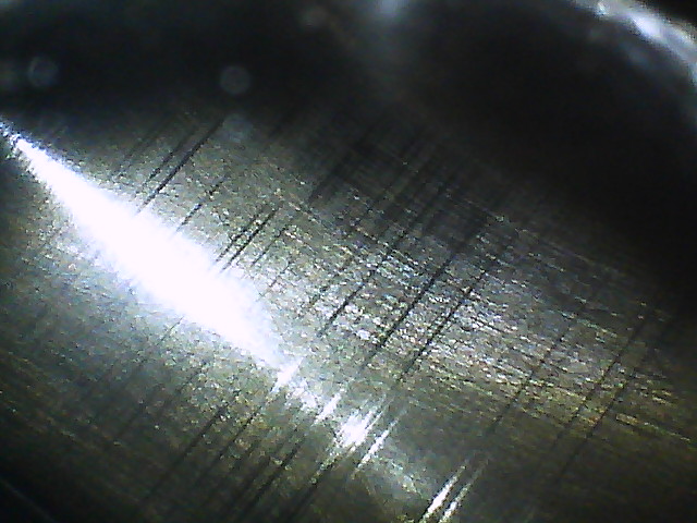

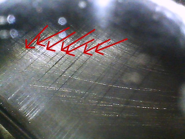

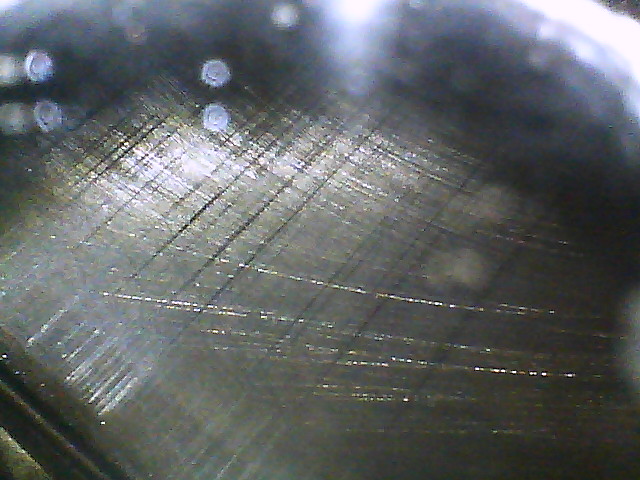

What's with the horizontal lines?

Honing crosshatch. Looks too horizontal? I see what you mean. Looks like underlying it goes straight across. It could be the picture.

Having a hard time orienting the photo. Unless I'm misunderstanding it looks like there are deep vertical score marks in the cylinder. Is this correct? If so, could the rings have suffered damage during install into the cylinder?

Yes, vertical scoring. Left bottom corner of pic is top of bore. No issues on install. And the scoring is up past ring travel. Above the top ring.
And similar scoring on all cylinders.

Looks like wrong crosshatch. What do the rings look like?
