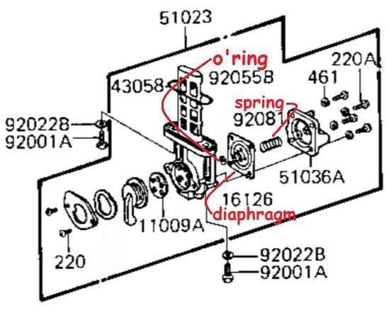

Maybe the petcock is dirty inside whereby the diaphragm-spring-o'ring mechanism isn't fully shutting off fuel flow when the engine isn't running (i.e., improperly allowing some flow in non-PRI position when the engine isn't running), and which condition is allowing the unwanted fuel flow to pass down the vacuum hose, through the vac nipple, and into the intake port, thereby causing an excessively rich condition (in at least the one cylinder) upon attempted starting 20-30 minutes after a run.
The likely remedy would be disassembly and cleaning the petcock, and if needed, also installing a petcock kit that includes the necessary internal petcock parts.

28 Jun 2017 06:25ThatFiveOhTho wrote: . . . cleaned the intake valves, removed most of the gunk. Will be running some fuel cleaner to get the remains out. I've also discovered that my carbs do not have any overflow mechanisms. No brass tube going up out the bowl. The petcock is fine. Took it apart and found no evidence of any fowl play. . . .
